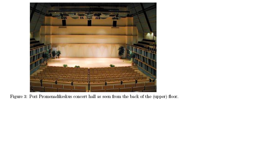

In order to experiment with the sound of concert hall reverb I needed a source of concert hall impulse responses. I was intending to buy some commercial CDs with recorded impulse responses but a Google search uncovered researchers in Finland who have provided impulse responses for download. Their site is: Concert Hall Impulse Responses - Pori, Finland
Here is a photo of the concert hall they measured.

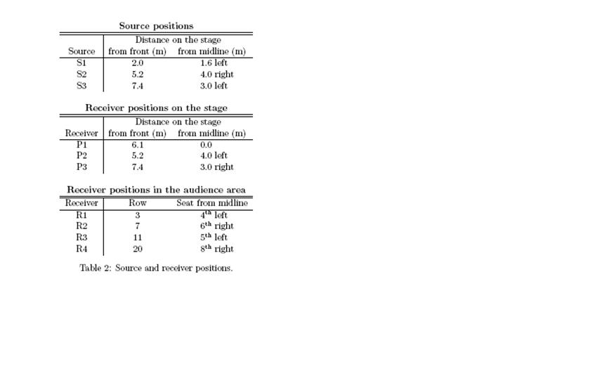

They provide documents describing the recording and processing undertaken to produce the impulses. They used binaural, omni, cardioid and soundfield mics to record sweeps playing in an empty concert hall. The position of the loudspeakers on the stage, and the position of the mics were varied, so they have created quite a range of different options for experimenting.

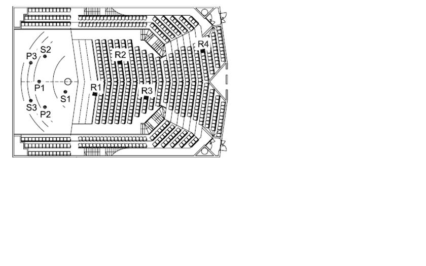

I ended up using the ‘S1 R1” combination for the impulses, seen in this diagram:
S1 is the location of the loudspeaker, R1 is the location of the mics.

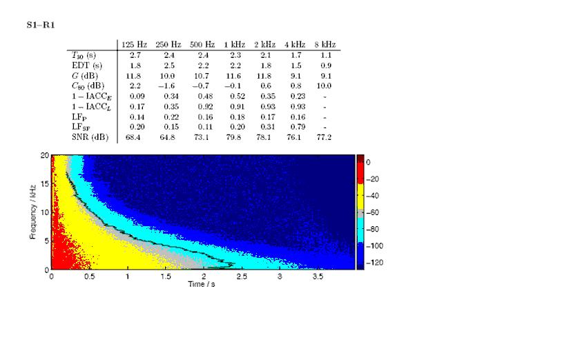

One of the first things I noticed was how much bass information was present in the rear speaker sound once the impulses were convolved with the input channels. Here is a spectrum diagram and data from the S1 R1 impulse, and you can see that indeed there is quite a bit of bass info in the impulse. I did not expect that.
So I had to attenuate the bass component going into the subwoofer to get a more even balance between the front and rear sound.
