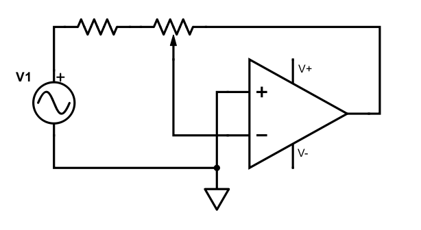

I am building a guitar/bass pedal and would like to incorporate a digital potentiometer for the volume control controlled by an Arduino. Therefore I bought the MCP41100. I hooked up the signal to the wipers as one would hook up a mechanical potentiometer (like this) and it does work.
The volume can be controlled by the digital pot BUT there is a small hiss or noise introduced to the sound. Using a capacitor removes the noise but also the high frequencies which is unwanted.
I have considered having the digital potentiometer control an op-amp but it will only control its gain which would be > 1 so that's not really an option (did I get this correct?).
Any ideas on how I can solve this? Am I using the correct digital pot? Can I have the pot control some other circuit to control the volume?

You can have a feedback digital volume control in a circuit with gain below unity,
to near zero gain in fact. Just connect the op amp in the inverting mode.
How much gain do you want? Add a series input resistor to limit the maximum gain.

The problem with the fully-variable gain plan proposed, in a *guitar* pedal, is the input impedance can go very low (steals all the highs of a guitar) or very high (raising hiss voltage).
The other thing is: audio swings both ways. These digi-pots don't like any pin swung below zero. Some will do "OK" to a half-Volt, and for small guitar this may be "enough". We would usually use them biased-up halfway on a 5V or 9V supply, with cap coupling in and out. They do not directly replace a plain pot in audio applications.
