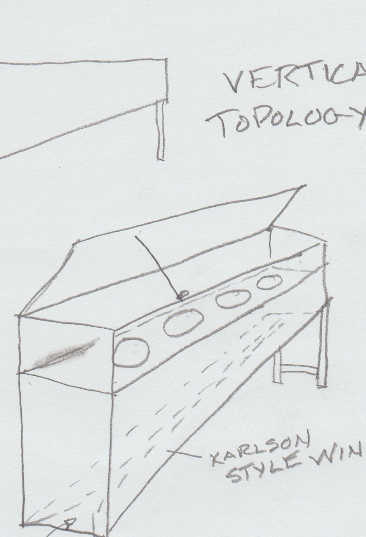

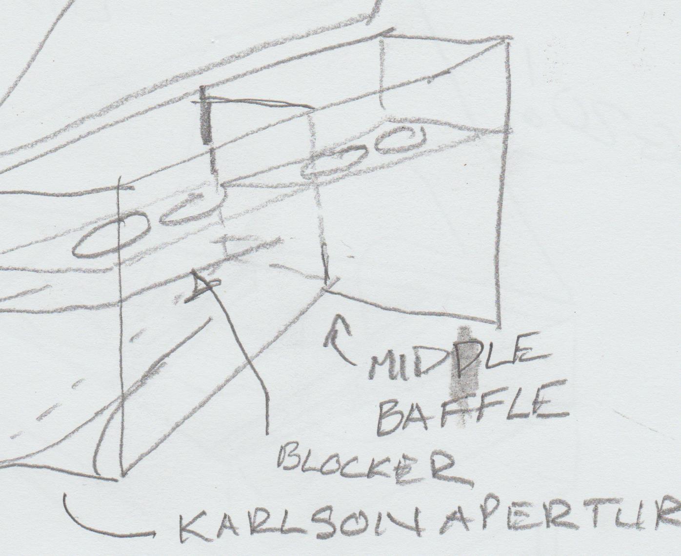

could also go with a vertical topology and use a karlson aperture on the bottom side.

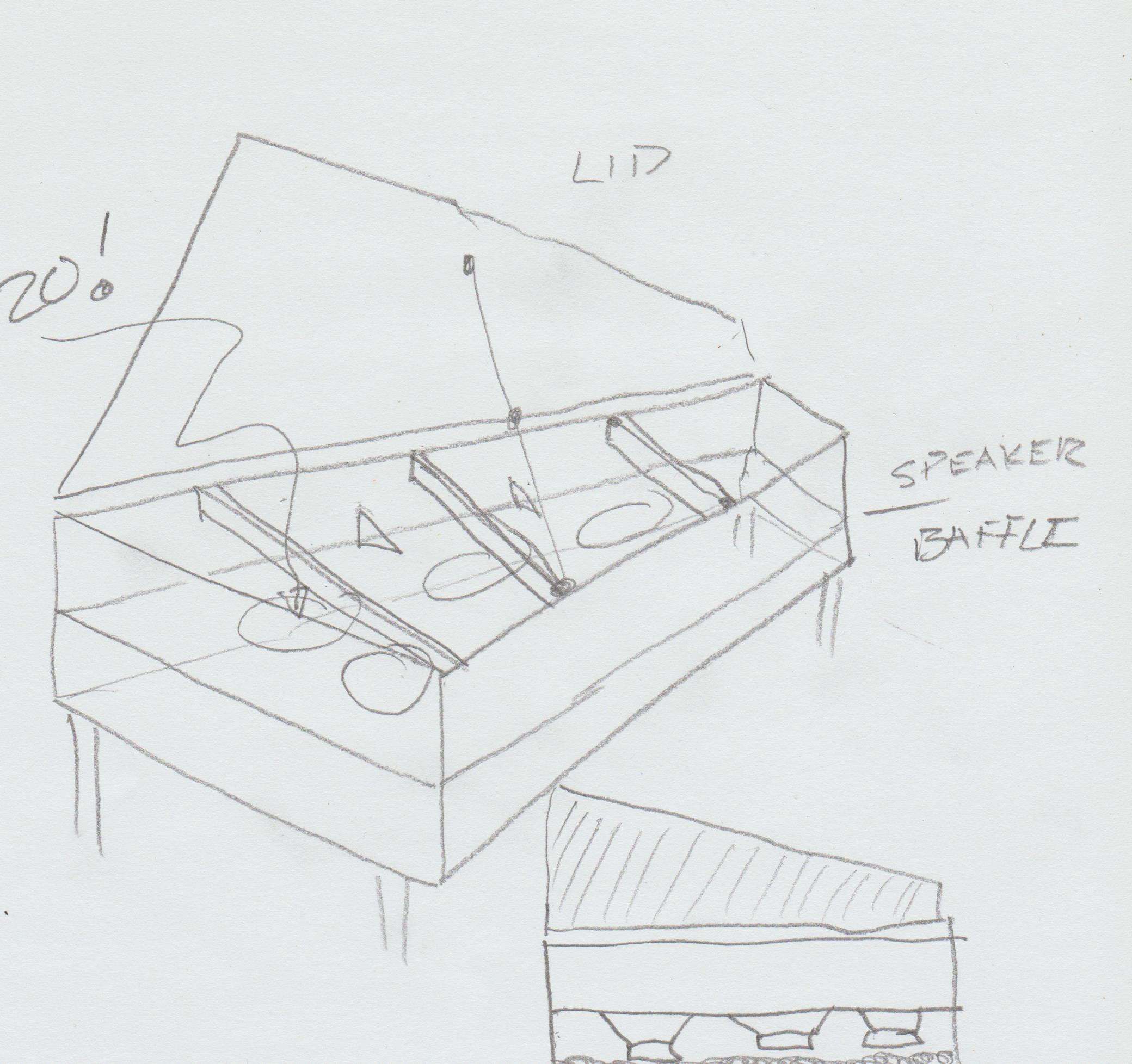

Wow I appreciate your enthusiasm for all this! Great drawings. Giving me more ideas that I wish I had thought of from the start! The thing I'm realizing with all this, is that as AllenB stated on page 2, this idea is really sound reproduction, not production, since the piano samples/sounds already produce the resonant tone of the piano body. My idea of having a resonant cabinet that would make a bigger more ambient sound is flawed. The real idea is to have speaker placement and design that produces less point source type sound. I'm realizing the cabinet needs to be free of resonances, as much as possible.
SO... I just need to evaluate where I'm at, and what I need to do to get it to where I want it. Bracing and damping materials are the first step, I believe. Next would be to adjust the plane of the mounting baffle. I feel like if I make a horizontal baffle with the drivers facing up, that might get a bit harsh sounding being so close to them pointing more towards you than how they are now, in the back. But if done right, it may not be. I could also add some sort of diffusion over top of them, maybe.
The Karlson aperture, is that to improve bass response?

on axis response would get more of the high's that tend to beam directed towards you which is why i was suggesting the lid to act as a reflector and the lids position can be used as a mechanical low pass filter the same way it's used in a grand piano. i'm also the sort of heretic who would use a linear actuator to adjust the position via midi to accommodate response changes depending on what program i'm running, it is a digital keyboard after all!!
yes, but may not be necessary.... frequency shading across four drivers could be employed.
Hahaha now that's an idea. The lid would definitely help control the tone/brightness. I also wonder if some sort of mild diffusion panel/cover would also help smooth out any harshness.
that could be used to good effect, picture if you will (insert Twilight Zone intro music in background) using the two BG 20's per side and configuring them like a Nola Brio with one driver frequency shaded and the other running full range place a shaped reflector on the lid above the driver running fullrange and you have a mechanically adjustable stereo spreader....i think i need to have a scotch and do some contemplation....
