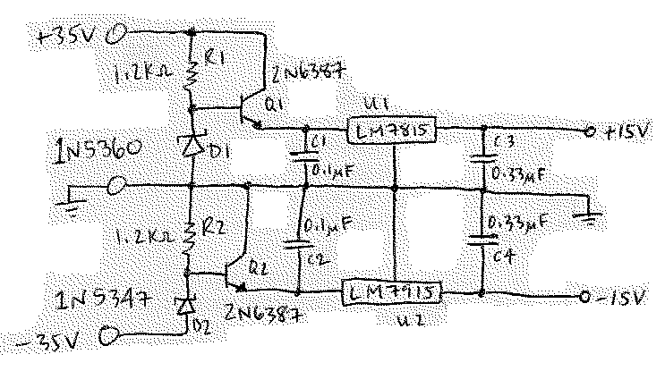

right now, i'm trying to realize a completely digitally-controlled gainclone amplifier (a related post can be found here), which raises the question: how to supply the +5Vdc for the micro and relays and the +/-15Vdc for the PGA2310/OPA2134?
my first thought was to simply attach a LM7815/LM7915 pair to the output of my current design for a +/-35Vdc unregulated, snubberized, high-capacitance supply. since a |Vi-Vo| of 35V for these linear regulators is pushing the boundary of my comfort, my idea for a solution was to first reduce the voltage of each rail using series zener regulators. almost as an afterthought, an LM7805 could be attached to the +15Vdc rail for micro/relay supply voltage. (the circuit is attached...)
but after some thinking, the most pressing question in my mind has been: will this introduce distortion into the audio circuit due to uneven loading of the power supply? a second toroid (15+15) and separate supply would be the solution in such a case...
so, what do you think? is a separate supply for 5V and +/-15V necessary to ensure the best quality audio? anyone with past experiences on this here?

on second thought
sorry to have made the first post seemingly without using common sense, but i do that from time to time.
after thinking about the operational requirements (microcontroller basically managing all aspects from startup to attenuation and source selection to shutdown) of the project, i've realized a separate supply for the non-lm3886 voltages is required.
lolz, thanks,
