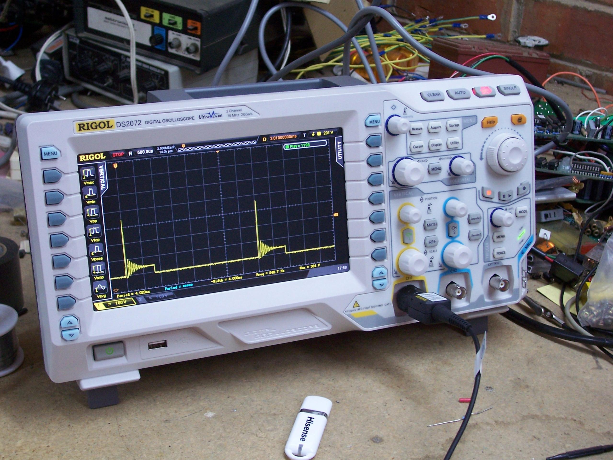

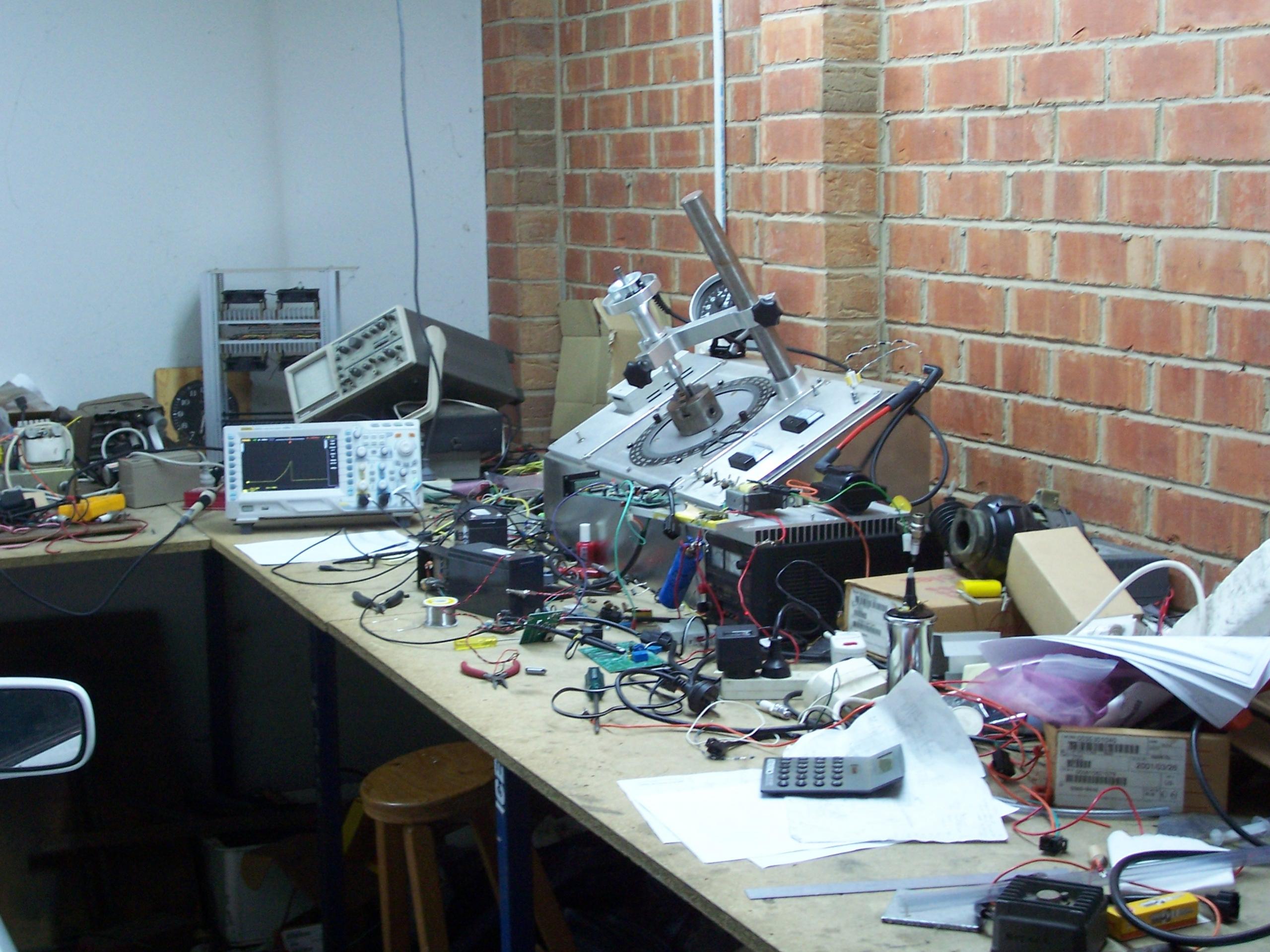

My scope situation
I don't mess with audio stuff so much these days. Mostly car ignition and engine management stuff. Having a DSO since end of September is the ducks guts. Collect say 20 seconds of waveform and then being able to zoom in 100,000:1 is great.
