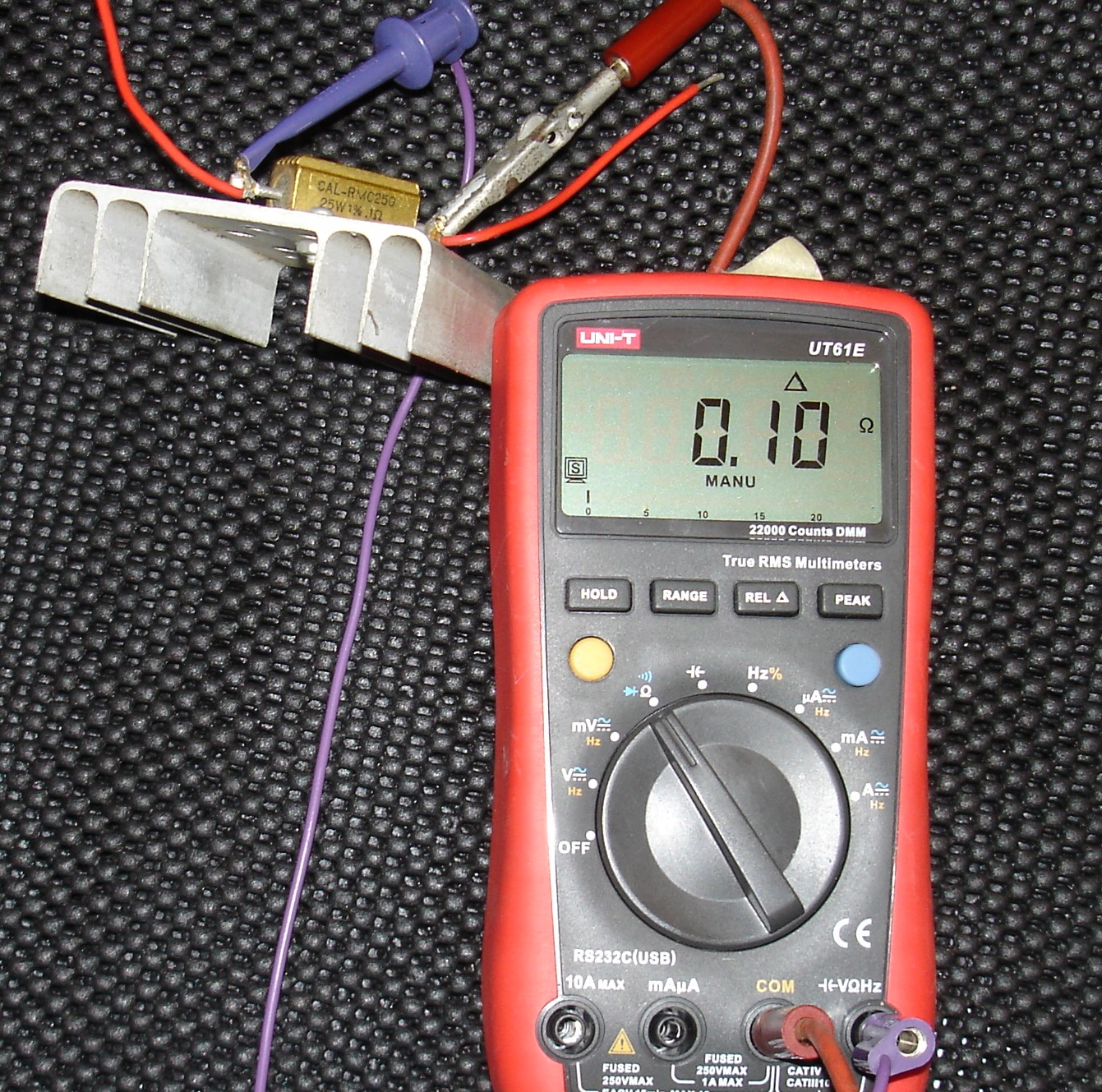

yes UniT is known for hit or miss on products, but this model 61E they hit a solid double play.
Ive personally put it thru all its functions, only found one thing I didn't care for, but I reckon that the same can be said for any DMM at any price point.
I no longer recommend the UT61E because of the issues with drift. It seems to be about a 50/50 crap shoot on whether you get a meter that drifts or not. It appears one or more of the resistors in the integrated resistor divider network drifts relative to the others making it very difficult, if not impossible to calibrate it out. Additionally, in more recent editions Uni-T has been cutting costs (for example they no longer gold plate the selector traces, which will dramatically reduce the life of the meter). This is coming from someone who has two of them, one I know for a fact has drifted and the other I haven't bothered testing as I use my bench meter for the high resolution stuff now. That being said, you DO get a LOT for your money with these. You get a lot of features, damn fast continuity, and a resolution that is second to none (you also get TrueRMS and PC data logging). That being said, it is not without its drawbacks. The biggest drawback is its lack of robustness on the input protection. A static electric spark, even just from walking across the room, directed at the inputs will kill the meter. Unfortuantely, it isn't just the UT61E that suffers from this, it is most other Uni-T meters as well. I have no clue WHY that is, because they use ceramic fuses and PTCs (and even MOVs on the UT139C) but they still seem to die more easily than most other meters.

If you meter hasn't drifted I am glad for you, because honestly I loved the build quality of that meter when I got it. The screen is literally one of the easiest to read screens out there period. Fluke could learn a thing or two from how great the contrast is on that screen . The meter drifting and its lack of robustness really left a bad taste in my mouth though.

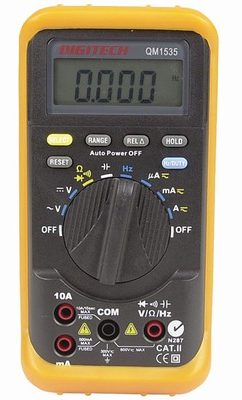

You have probe contact issue. The probe should be of the cross-cut solid type, use a nail or similar to open them up a bit and reinsert - should be fine. You may also have oxidation on the contacts inside the meter.

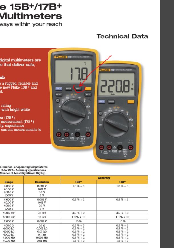

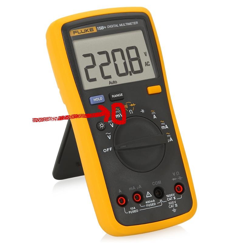

The Fluke has high input resistance but at least the ones I have seen seem well within their specified accuracy.

Yeah the one that drifted is the one that I wiped out. The drift didn't bother me enough because most measurements I do are relative more than absolute. As long as you stay within the same range, the drift doesn't affect relative measurements. I picked up the second one (before I killed the first one) for $20 when a store as closing them out. At that price, couldn't turn it down. I actually recently got a part to repair it but just haven't gotten around to trying the repair. I don't blame Uni-T per se for the one dying but putting a battery in backwards really shouldn't have killed the meter. I will try to find the threads I saw showing the new selector without copper plating. At this point, I have multiple multimeters and the UT61E has its place. I no longer recommend it as a primary meter but it definitely is as a second meter if you know its limitations.
what do you consider drift , all error terms of voltage stability should still be in spec for a year yes? if you see anomaly, the 1st place I would look is the calibration pots, look up the data sheet.
I was at around 30 counts of drift when I killed the meter, it tended to be really temp sensitive at the time and my house at that time was really drafty. I don't remember how that is relative to specs but I remember thinking it was kinda high. I have seen several people have their meters drift out of spec on DCV and Resistance around the end of one year. The DCV can be calibrated, the resistance cannot (there is no cal pot for resistance). I actually thought about doing a DCV cal pot mod (using a fixed resistor and a smaller trimmer to help limit drift). I actually still have the schematic for the UT61E saved on my computer somewhere.
pick the trimmer carefully probably just a part change to a quality name brand will see some improvements.

The digitech is more than 10 years old. Even a few years ago I could no longer pull the leads out of the DMM. So I think it has served its glorious days and I should let it rest in peace.
