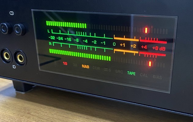

The analog level meter has been designed for use as a recording level meter for a reel to reel tape recorder. But it can also be used as a standalone device. The LED bar can contain up to 50 elements per channel. To reduce the level of interference, static indication is used. A feature of the meter is fully digital signal processing. That allows you to make the meter metrologically accurate, with an exact match of the dynamic characteristics. All parameters are programmed using special software on a computer.
Each meter channel contains two signal processing branches, the readings of the first one are displayed as a bar, the second - as a dot. This can be used to display two values, such as average + quasi-peak, or quasi-peak + true peak. For each of the branches, you can individually set the gain, integration time, response time, decay time, hold time, fall time, peak hold time, peak fall time. The scale type is set by assigning an individual threshold level to each LED with an accuracy of 0.01 dB. This allows you to build a linear, logarithmic, S-shaped with a stretch near 0 dB and other scales. A set of all parameters, including the scale type, is stored in EEPROM as a preset. There can be 4 different presets in total. They can be selected with the control button. The second button can turn on the indication of statistics of maximum levels, as well as reset it.

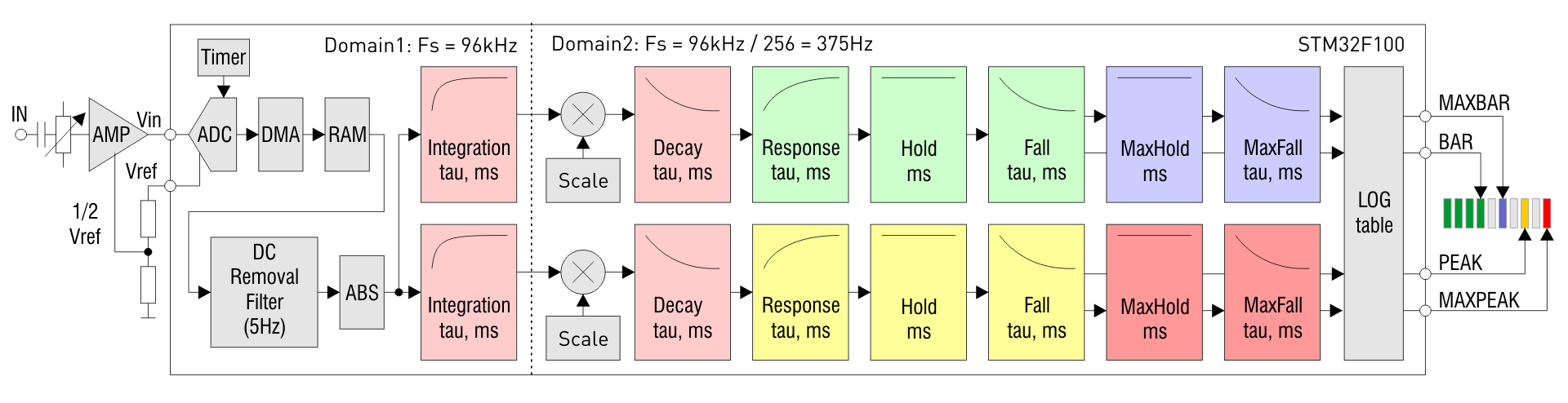

Block diagram
The block diagram of the level meter is shown in the figure below. This diagram shows one stereo channel of the meter. The input signal is fed to a differential amplifier implemented on an op-amp (Meter50_v4_sch.pdf). It performs two tasks: it shifts the signal by half the ADC scale and allows you to implement a balanced input. The signal shift is necessary because the built-in ADC is unipolar, its input range is from 0 to the reference voltage. A balanced input is desirable even if the signal source is single ended. It allows you to take the signal relative to "analogue" ground and eliminate the interference present on the ground of the meter circuit. If the level meter is made as a separate device, then balanced inputs with XLR connectors can be implemented.
All signal processing is done digitally by the STM32F100/103 microcontroller. To avoid the use of an anti-alias filter at the ADC input, as well as to be able to register short signal peaks, the sampling frequency was chosen quite high - 96 kHz. With DMA, ADC samples are stored in a buffer in RAM. When half of the array is ready, an interrupt occurs, the data is read and processed.
DC removal filter
The first operation on digital data is to remove the DC component from the signal. This must be done before the signal is sent to the detector. With a meter dynamic range of about 60 dB, even such a small DC component as 0.1% of the ADC scale can be equal in magnitude to the useful signal and distort it.
Detector
Next, a full-wave rectification of the signal is performed. This is the easiest part of processing. When the DC component is removed from the signal, the task is to calculate the absolute value.
Filters
Next are several filters that define the dynamic characteristics of the meter.
Integration time
To obtain a given integration time, the detector output must be smoothed with a filter. The smoothing filter is not a simple low-pass filter, but a more complex filter with different charge and discharge time constants. The charge must be fast to provide the specified meter integration time. And the discharge must occur slowly to provide a given return time, which is much longer. Therefore, the integration time filter is turned on only when the signal rises; when the signal decreases, it is kept at the same level. A separate filter is used for signal decay.
The difference filter equation has the following form:
y( n ) = y(n-1) + A*(x( n ) - y(n-1)), where A = 0.0083 for Fs = 96 kHz
A 32-bit accumulator is used to obtain the required calculation accuracy. Filter coefficients are 16-bit unsigned. They are defined as A = 65536 / 96000 / tau.

"Slow" domain
To obtain a return time of 1.7 seconds, a filter time constant of approximately 740 ms is needed. This is too long to process in the 96 kHz domain. Therefore, further processing is done in the "slow" domain. The reduced sampling rate is formed as the frequency of filling the halves of arrays of 256 points each with ADC data, i.e. 96000 / 256 = 375 Hz. This is quite a reasonable sampling rate for this filter, for 740 ms the filter coefficient is equal to 0.0036, which is quite an acceptable value.
Scaling
Processing in the "slow" domain begins with signal scaling, which is necessary to equalize the indications of the quasi-peak and peak levels on a stationary signal. The output 11-bit code of the previous filters is multiplied by the scaling factor. The output is a maximum code of 10000, it is this range that is used in the dB conversion table. After multiplication, the code is limited to about 10% above the maximum code for the dB table. At the maximum value of the coefficient, the gain is 32 (approximately +30 dB). You can use this gain to shift the scale when you need to measure small signals more accurately.
Response time
To form the response time, an IIR filter is used, which operates in the "slow" domain. The output code of this filter is directly related to the meter reading. A 32-bit accumulator is used to obtain the required calculation accuracy. As with the integration time filter, this filter only works when the signal is rising. Filter coefficient 16-bit unsigned. It is defined as A = 65536 / 375 / tau.
Decay time
It was said above that the integration time filter works only when the signal rises. It can only increase the output code. For signal decay, a special filter is used, which acts on the integration time filter accumulator. It only turns on after the response time has elapsed. Because the signal decays slowly, this filter operates in the "slow" domain. Filter coefficient 16-bit unsigned. It is defined as A = 65536 / 375 / tau.
Hold time
Decreasing the integration time filter accumulator code does not mean that the meter reading is decreasing. The readings are associated with the response time filters and may have some hold time where the reading remains unchanged after the peak of the signal. This can be used both to hold peak values and to eliminate fast flickering of bar segments. The hold time is set using a special coefficient, which is calculated by the formula A = 375 * t_hold. If you set a zero value, the readings will not be held, and immediately after the end of the response time, the return will begin.
Fall time
When the hold time ends, the meter begins to return. For this, a falling time filter is used. This filter acts on the response time filter accumulator. The filter works in the "slow" domain. Filter coefficient 16-bit unsigned. It is defined as A = 65536 / 375 / tau. This time constant determines the meter's fall time.
A separate fall time implementation for the response filter allows for reduced decay time for the integration filter, which reduces the effect of peak-to-peak time on the meter reading. There is usually such an influence - if the signal peaks at the meter input are repeated more often, then the readings increase (even when the magnitude of these peaks remains unchanged). This is due to the fact that by the time the next peak begins, the integration filter has not had time to completely "discharge", a new increase in its output signal starts from a higher initial value. As a result, it will be able to achieve a higher value than in the case of rarely repeated peaks.
When a filter has different integration and return time constants, the magnitude of the output signal will depend on the ratio of these times. If these times were the same, it would be a simple averaging filter, the output of which would be the average value of the signal (for a sine, this is 0.637 of the peak value). If you increase the return time in relation to the integration time, the output signal will increase and in the limit will become equal to the peak value of the input signal, when the ratio of the return time to the integration time becomes infinite. The situation is similar for a conventional analog detector with a smoothing filter with different charge and discharge time constants. Therefore, if the ratio of the time constants changes, the calibration of the meter will be violated, which requires correction using scaling factors.
Maximum values
In each processing branch, the maximum (peak) value of the measured signal can be stored and held for some time. For storage, a special accumulator of the maximum value is used. When the hold time ends, the return begins. The holding time and the return time for the maximum values are given by separate coefficients. As a result, the meter allows you to get 4 different output values, which helps to implement various display modes.
Statistics
In addition to the accumulators of peak values, there are also accumulators that are used to accumulate statistics. When the meter is running, the values in these accumulators can only increase. There is no return here. Resetting statistics is done manually.

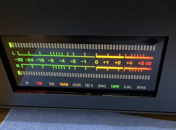

LED display

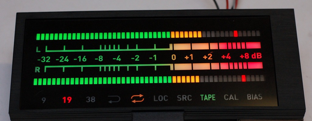

The LED bars are connected to the outputs of shift registers 74HC595, which are included in the chain and loaded via the SPI port. The hardware SPI of the STM32 microcontroller is used.

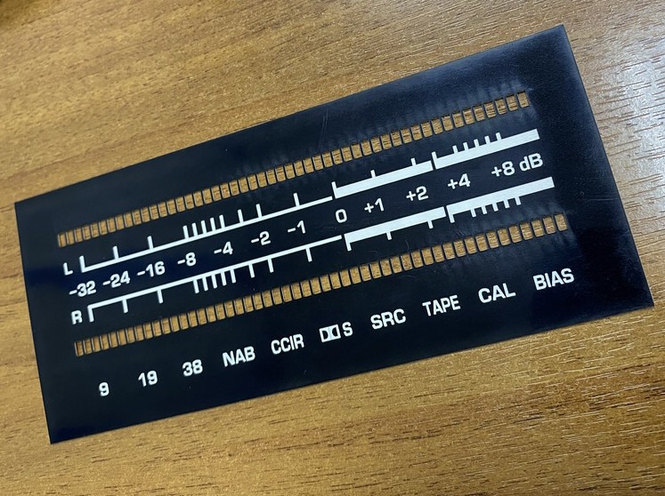

In addition to the LED bars, the meter contains stencils that are illuminated by LEDs. They can be used to indicate various operating modes. These LEDs can be turned on or off as specified in the presets. You can also control them from external signals connected through a special connector.
Brightness control
To equalize the brightness of the LED bars, as well as the scale and stencils, a separate brightness adjustment is required. It can be done in software or with pots. Software adjustment can use PWM or built-in DACs. For smoothing PWM, a 3rd order low-pass filter, performed on an op-amp, is used. From its output, the control voltage is fed to the adjustable stabilizers LM1117. As experience has shown, the use of PWM is undesirable due to the increase in the level of interference. The latest version uses pots.

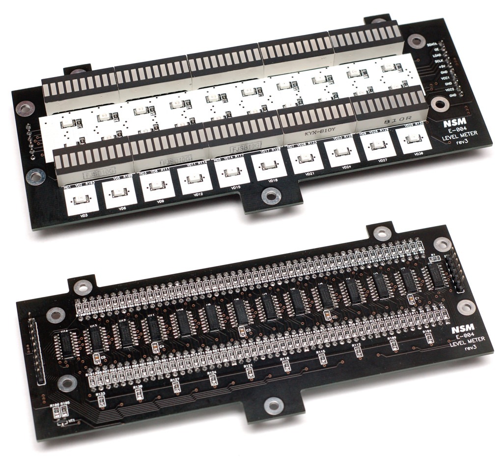

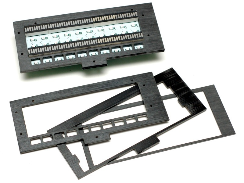

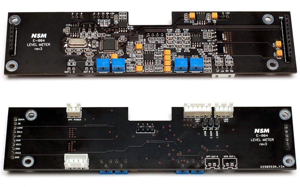

Printed boards
The meter consists of two printed circuit boards - an indication board and a processor board. The boards are connected to each other using connectors. When LED bars of different colors are used, then it is necessary to select limiting resistors for each color in advance so that the visual brightness is the same. The circuit diagram shows approximate values, with other types of bars they may be different. A similar situation with individual LEDs.
A diffuser in the form of a multilayer structure made of sheet plastic is installed on top of the indication printed board. With the help of laser cutting, parts are made, which are then assembled in a stack and glued together. A scale mask is installed on top, which is made using photo printing or laser engraving of thin two-layer plastic Rowmark LaserLIGHTS S61 (black / white). Drawing details and mask can be downloaded in the archive (Mask.zip).

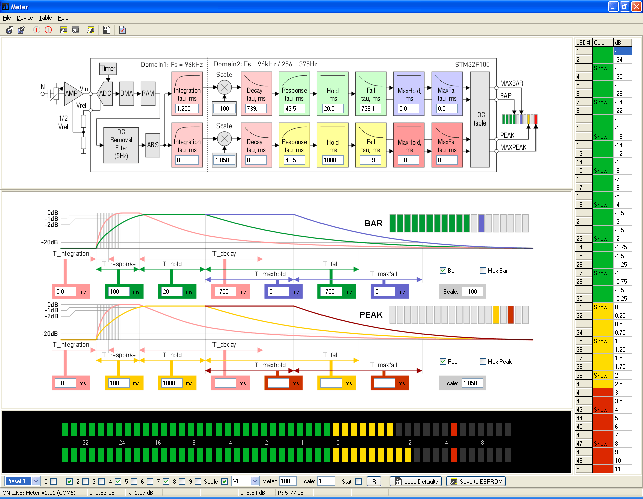

Service software
The service software allows you to set the parameters of the meter, create new scales, and can also display the indicator readings on the computer screen. The view of the main program window is shown in the figure. All controls are intuitive and have hints. To fill the scale table, there is interpolation of the selected range of table cells: the cells are filled with values with a constant step, which is calculated from the last selected cells.
Default presets
Preset 1 - standard quasi-peak meter, integration time 5 ms, response time 100 ms, hold time 20 ms, fall time 1700 ms. Dots operates as a true peak meter, integration time 0 ms, response time 100 ms, hold time 1000 ms, fall time 600 ms.
Preset 2 - standard quasi-peak meter, integration time 5 ms, response time 100 ms, hold time 20 ms, fall time 1700 ms. Dots represent maximum bar values, hold time 1000ms, flyback time 600ms.
Preset 3 - simulation of the standard level meter of my reel-to-reel tape recorder, integration tau 12 ms (the time constant of the RC circuit is about 6 ms and a half-wave rectifier), return tau 1500 ms. The dot is not used.
Preset 4 - simulation of a Dorrough 40-A2 meter, integration and return tau 300 ms. The dot operates as a true peak meter, integration time 0 ms, response tau 10 ms, hold time 25 ms, fall tau 300 ms. Additionally, the peaks are held by one more dot, the hold time is 2000 ms, there is no reverse motion.

LED display
Brightness control
Printed boards
Service software
Default presets

What did you use for the meter on the photo?A scale mask is installed on top, which is made using photo printing or laser engraving of thin two-layer plastic Rowmark LaserLIGHTS S61
Again, beautiful work!
Thank you!
The photo shows a scale printed on film. There are organizations that provide photo printing services on photoplotters.
Update: I have examples of photos with laser cut and engraved Rowmark plastic, but I don't use it anymore.
