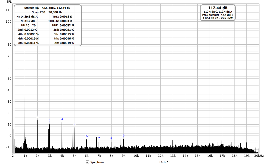

I have established that my Meridian 203 DAC has a cleaner noise floor and better harmonic structure from a variety of THD and IMD tests than the audio out of my re-capped Marantz CD94. So it would be great if it sounded better too but it really doesn't. The stereo depth is noticeably shallower on good recordings and there is a kind of 'grey veil' laying over the detail in a recording. I'm comparing with levels set very precisely and the DAC is taking either optical or electrical output from the CD94, so the same bitstream is being used. Perhaps there is something wrong with it, but it measures fine. Stereophile used to think it was a great DAC.

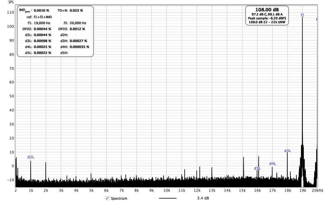

In case anyone is interested, I have attached some screenshots from REW using an Alesis io2 input for 1kHz tone and CCIF two tone distortion measurements at -10dB straight out of the 203 from my test disc on the CD94 transport. The measurement setup is a little crude but these look OK to me, certainly less noisy than the CD94 audio output which looks a lot noisier but sounds so much better.
