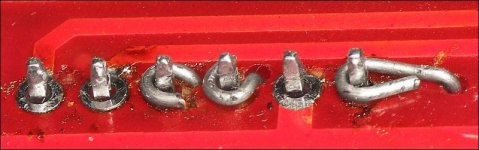

Im Gonna try to get this amp up and running again since he said he will pay good to have it repaired . I will order new driver transistors for it .
Also since the pads for the driver borad are burnt off the board and i need to make the connections more reliable . whats the best stuff to use to to make better connection on the pins of the driver board to the main board?

I generally do something like you see in the attached photos. Scrape the solder mask away on the top of the board and lay a wire (resistor leg or similar) and pass it through a hole that's been drilled in the board near the missing pad. Then form a loop around the through-hole.
A number 60 drill bit is a good size for this.
Make sure that there is no copper on the opposite side of the board where you'll be drilling.
Don't attempt this on boards with more than 2 copper layers unless you confirm that there is no hidden copper where you're going to drill. This can sometimes be done by shining a bright light at the opposite side of the board and confirming that light is passing through the fiberglass where you want to drill.

Thanks Perry,
Thats what i was thinking to do also.
