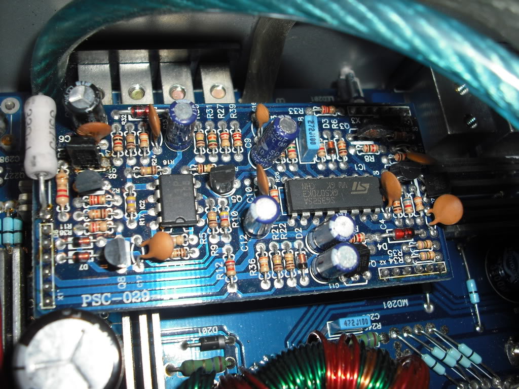

Ok im gonna rebuild the driverboards in this amp Anyone have a high res pic of the power supply driveroard?
Amp doesnt power up and i can take some pics of the driverboard and you will see why it needs rebuilding..
Both boards have been messed with and well i can let the pics talk for themselfs if u wanna see
The SG3525 in this amp has 0 volts on all pins..
What pin or pins should i see 12 volts on ??
Just wondering so i can start tracing the circuit back

dd z1
I checked on my Z1:
The diode you refer to is marked D10.
The text on the housing says: ¨B22¨ (or B2Z, hard to tell).
B22 makes sense; a 22 V zener diode
B2Z doesn´t make sense to the best of my knowledge.

to the OP, the pictures you posted look very similar to mine (quality wise) the amplifier has most likely been modified to prevent turn on pop, and lower the low voltage protection... hence the messy, "aftermarket" soldering 😉
I have schematics for the whole amp... minus the driver board, as DD appear to have just used off the shelf items, and if they failed, would just replace the whole driver board.

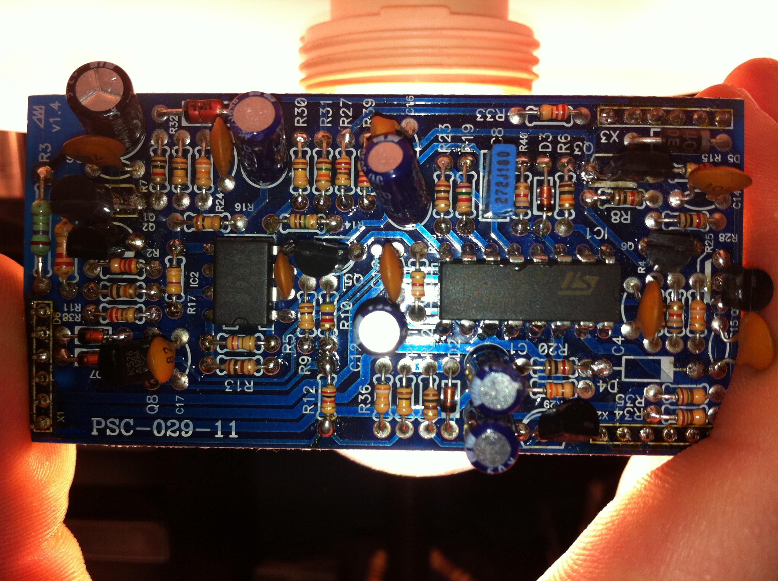

Could you check for me the following values on the second controller board (the one for the power supply) of the Z1:
- typenumber or value of D4 (missing on my PCB)
- value of R22 (100 ohms on my PCB; seems rather low value)
- value of R21 (100K ohms on my PCB; seems rather high value)

D4, I THINK it's a 1N4247, I actually have two of these amps, one is in pieces, and can read 1N4* on the diode (I believe it's 1N42) but can't read the other two numbers, because of the way the diode is formed...
however, I have some photos of the other amp (it's not in my possession at the moment) but it appears to have 47 at the end of the part number 😛
R22 is 100 ohm
R21 is 100k
R3? where's that on the board?

Thanks for the information!
However, 1N4247 is a regular diode while D4 has to be a zener diode.
D4 should be a zener diode of - best guess - approx. 15V.
So typenumber should be 1N4744, 1N5245, ....
Could you please be as kind as to check again?
R3 is on the edge of the PCB, just above the 6 pin connector marked X1

As for R3, I have two of these amps... on one board, its 33 ohm, on the other it appears to be 2.7 ohm
