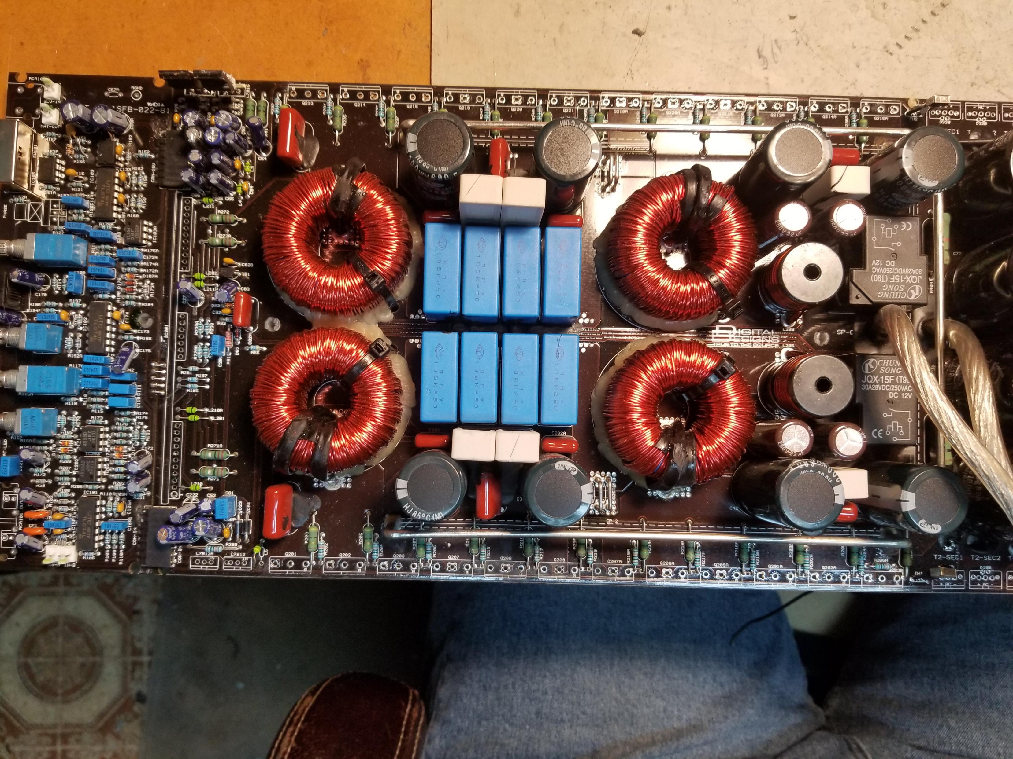

Post a photo of the component side of the entire main board and the component side of any driver boards if no one can help.

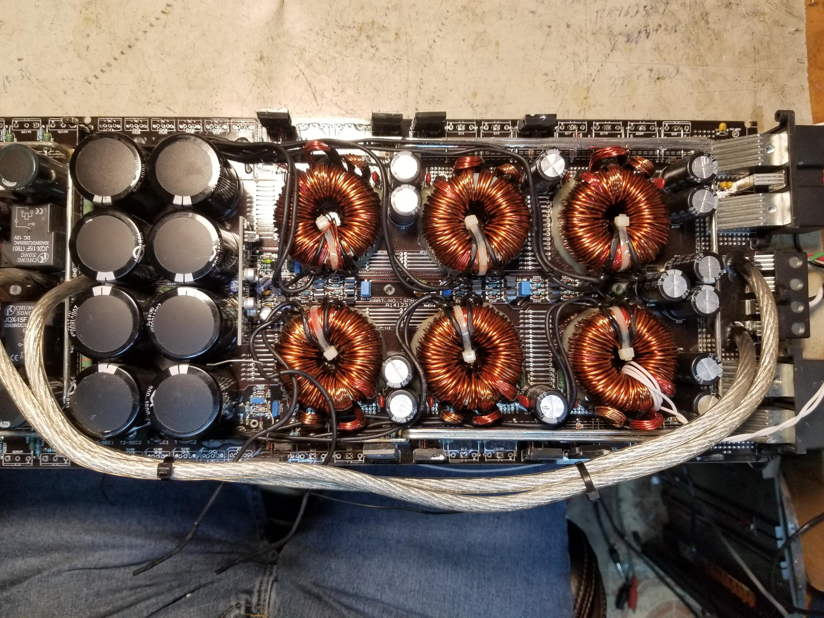

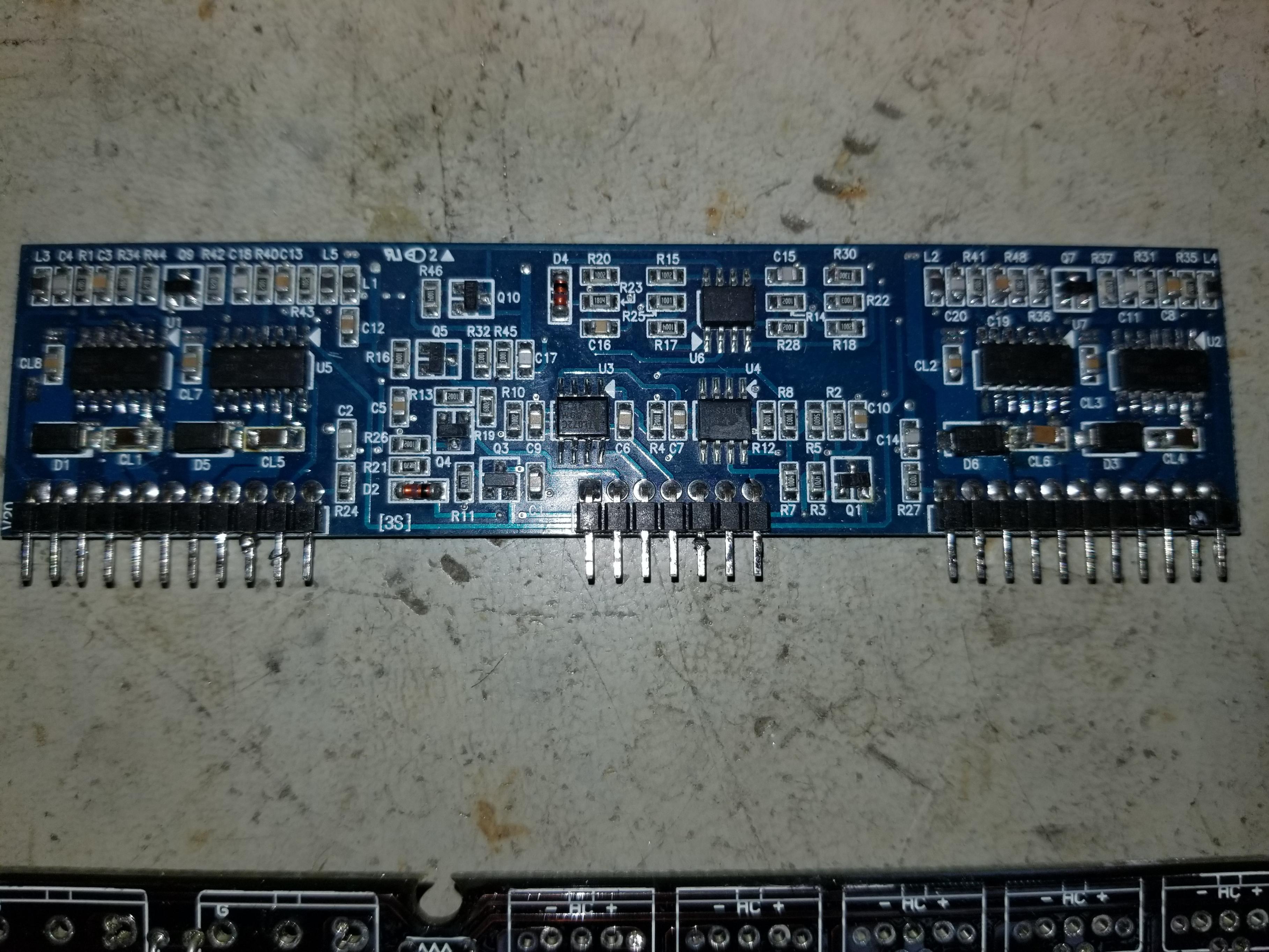

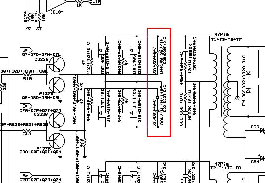

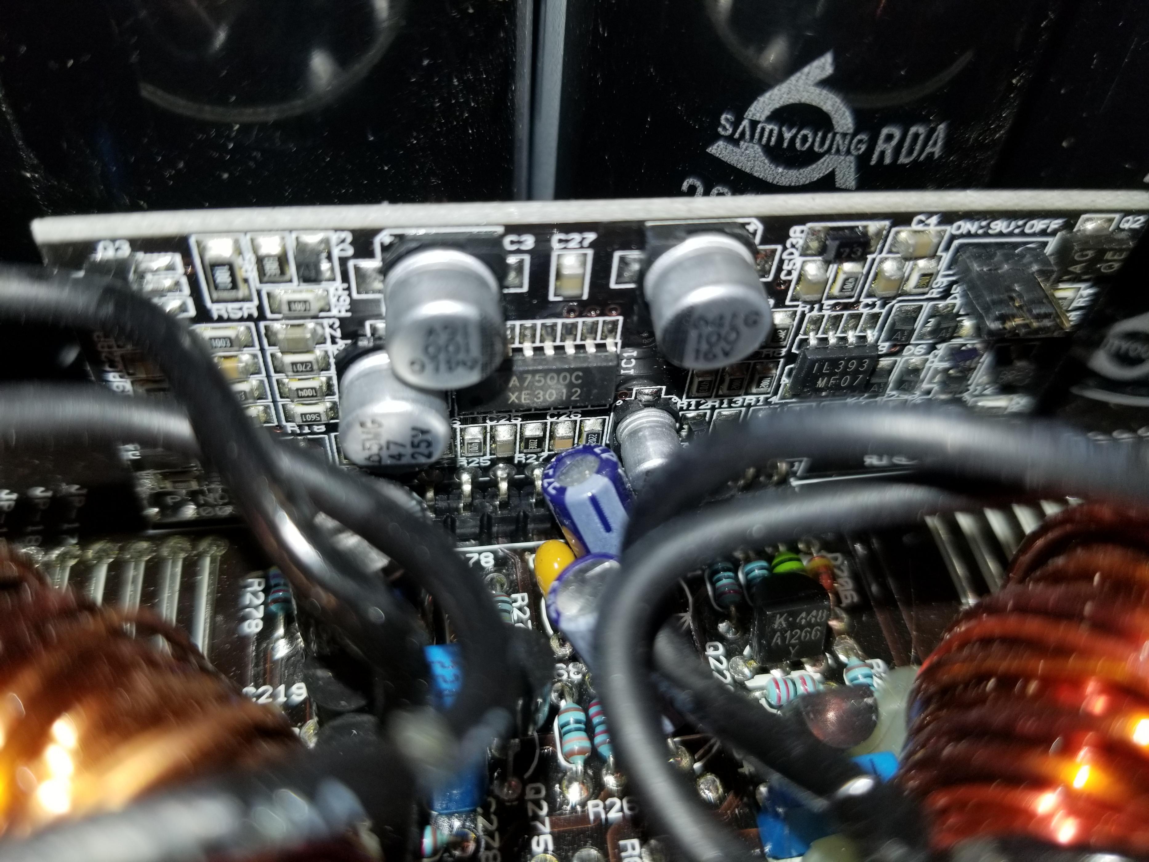

Here are the picks. Output driver board same as the Sun Down Audio SCV-7500D. Very similar to the Ampere 8 and AQ20 Sch. I'm only working on the power supply right now. There's nothing wrong with power supply driver board.

Does moving the shunt on the driver board make a difference?
The white windings are for the +/- 15V rails. It is not hooked up at this time. I will use it to trouble shoot the output section once I get the power supply running properly.
No, changing the shunt makes no difference.
I think you stated that you were only driving one bank of the supply at once but it appears that you're driving 5 banks in the photo. Is the photo what you currently have?
5 of the banks work. It's only one that causes it to go into protect. It doesn't matter if the others are loaded or not. I can take all the FETs out of the power supply. Load just the one giving me trouble and it will be in protect. I can pull the fets out of it, load the other 5 and the power supply runs. You might be able to see. I have the secondary pulled loose and the windings for the 12v supply pulled loose and it still puts it in protect if I load the transformer. I can't see how but it does. The fets do not get hot or short out.

Which terminal, 1 or 7 of the 393 on the PS driver board is going high when the amp goes into protect?

Can you see any terminal of the driver board that has a different voltage when the 6th transformer is driven compared to when it's not driven?
Can you remove the driver board, if needed, and extend the connections so that you can work on it?
