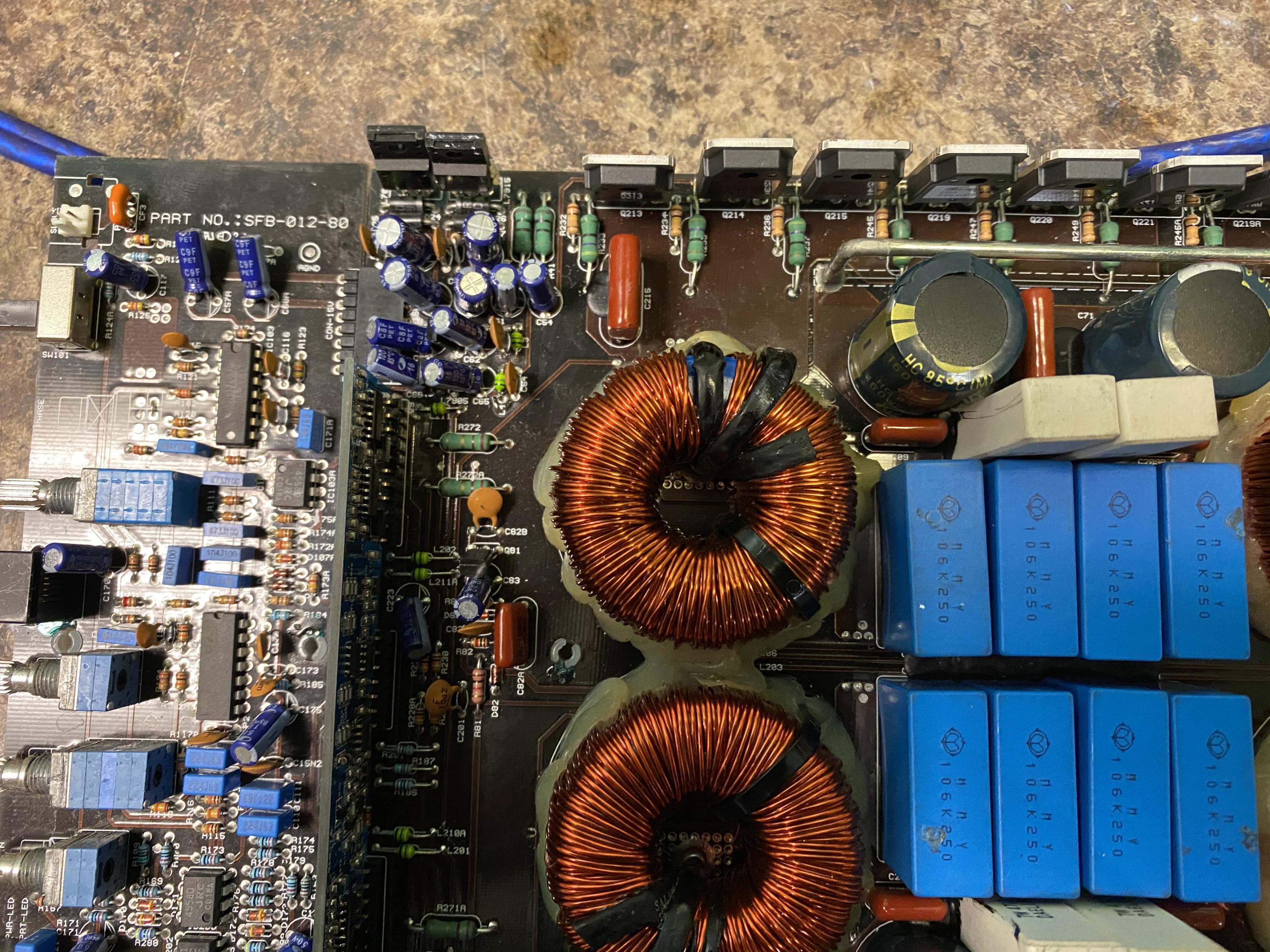

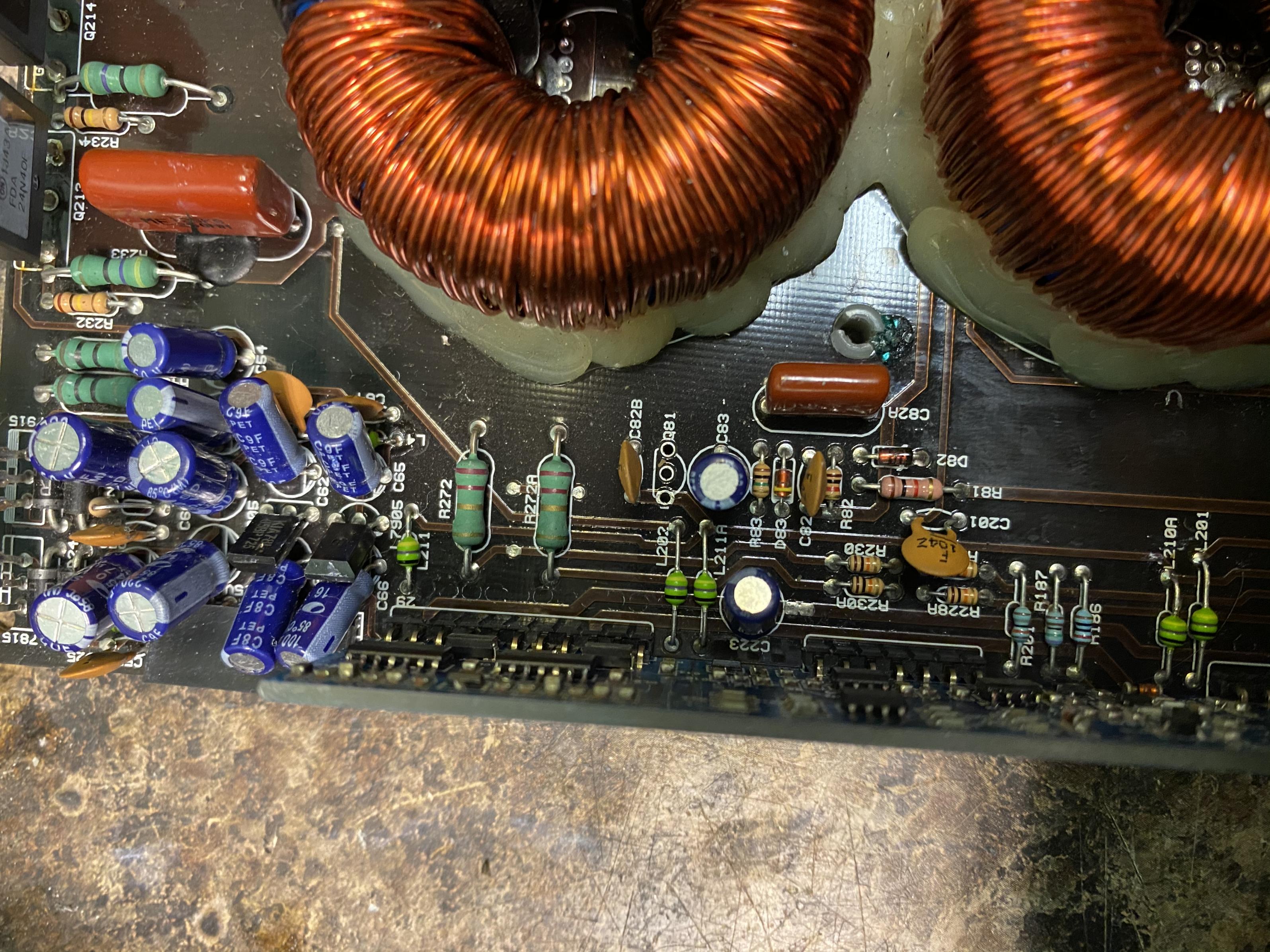

I do not get any rail to rail oscillation on the outputs .
I checked all of the regulators and all seem to work fine .
I checked all the 47mh inductors all are fine .
I get both positive and negative rail voltages .
Any ideas or common issues with this design of amp as to why it won’t oscillate
The rail voltage needs to build to full voltage before the drive begins. See attached.
