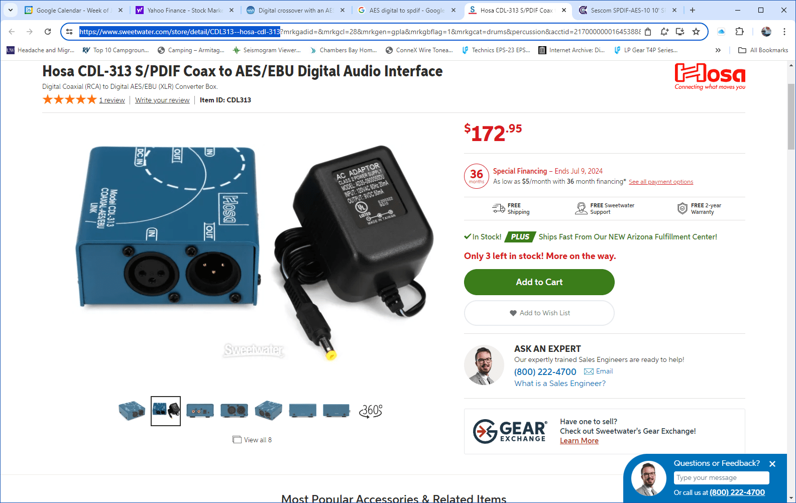

Hi olsond3,SPDIF and AES EBU is the exact same signaling. They are just different voltage levels. How can one be less sensitive to jitter? That makes no sense to me. The conversion from one to the other is done with a transformer or level converter.
thanks for your reply, you may be right...👍
but like many guy, I got a info a while ago, and I stick on it 🙂 Thus, for me, AES/EBU is more reliable & less jitter sensitive than spdif.
I have to find the info that confirms my point 🙂 , but if I remember "well", it's related to the clock recovery : this process is not the same when a device receive a spdif signal vs a AES-EBU signal.
phile1 Maybe have a look at this. https://www.sweetwater.com/store/detail/CDL313--hosa-cdl-313. It is just a signal level conversion to go between the two. There's no clock recovery in that box.

hi olsond3mphile1 Maybe have a look at this. https://www.sweetwater.com/store/detail/CDL313--hosa-cdl-313. It is just a signal level conversion to go between the two. There's no clock recovery in that box. View attachment 1326972
172USD with a crappy SMPS to power this stuff !
=> any "audio guy" should get away from that !
I mean, any "audio guy" that have no clue about electronics & just can "trust" some ads.
I was a jerk in electronics... I leared a bit in the mean time and I can tell that this kind of interface is ... I don't know ! But given its (hoo high) price I'll not try it !
