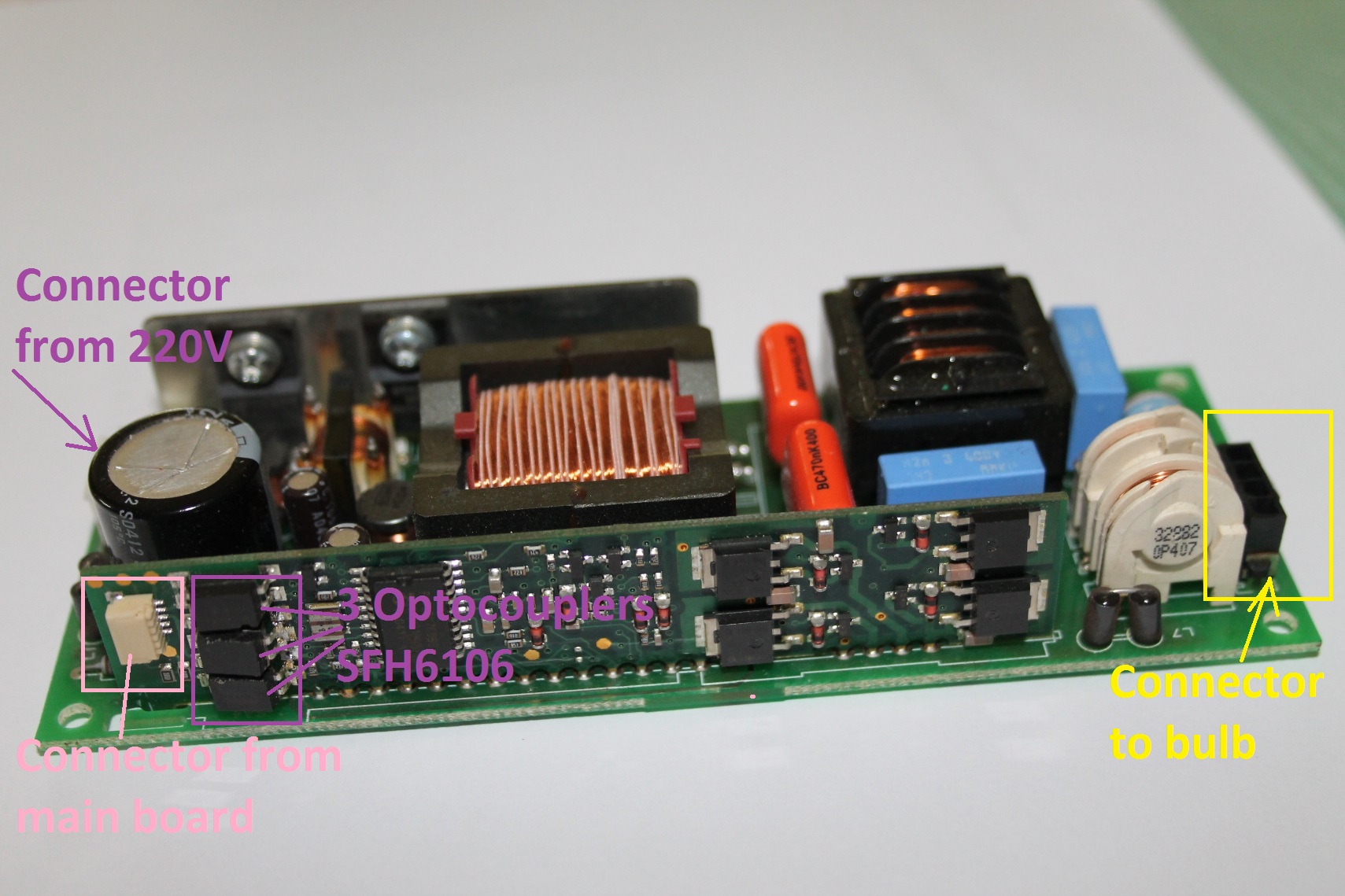

Well I managed to get a copy of the "Holy Grail" for this projector....AKA the service manual. Its funny that you were talking about using a PIC to communicate with the ballast. This projector uses a PIC to control all ballast functions.
After studying the schematics and trouble shooting. I figured that the Lamp_Err signal coming out of the PIC was the place to start. This signal is around 70mV and jumps to 5V when a lamp error is detected. This signal is sent through a buffer IC then to the main processor.
http://www.fairchildsemi.com/ds/74/74LCX541.pdf
By cutting the trace from the pic to the buffer and connecting the buffer pin to the buffer ground the projector stays on....
SUCCESS!! So far anyways. I havent tested for more than 2 minutes. I dont know what repeated errors will do to the pic or any other part of the circuit.
Dear crazifunguy, were you able to achieve full success with the digital ballast bypass? I have a ballast that is quite similar to the board you have shown in the pictures. It is in the infocus x10 projector. simple grounding and shorting or resistors havent worked so far. Please help.
Hey all! new to join here, read a bit here over the years. hope your all well. I'd like some help if you can "Crazifunguy" if you'r still about. i have what i think is same ballast EUC 200 A/01 china ballast (philips?) it use serial coms. i have had it change its error with attempts to use arduino and another persons code. still wont turn on. anyhow, im over playing with arduino's for a little while, it's getting to me. Been at this NEC VT770 for a few months now and thought it time to ask for some help from those in the know. this after i blew up one unit now on last one. Is it shown in you're pics of this ballast controller board (same as mine) what is the buffer chip and what pin to lift / short to buffer ground? this i need help to id. I'd get a manual for this model if i could. i have tried all companies i can find and none can get hold of it for me on the net or in my land (australia) looks like the projector market is keeping this one locked. if not shown can you please email me a photo or description to work with. Many Thanks for any help you can offer me =) great site here btw, packed full of kool idea's.

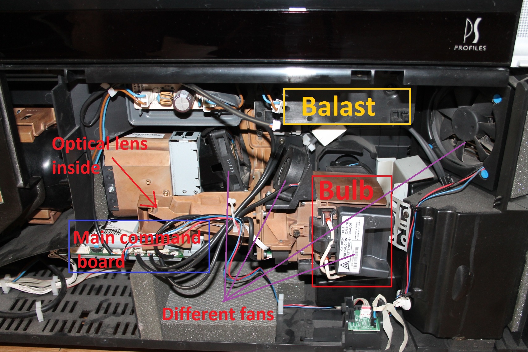

I have a Thompson DLP, the bulb was died and after the change i have observed that also an optical lense is burned, I have changed it but I do not understand the function for the cooling.
Now the TV works fine but i observed, that after stop, all the coolers are working yet 2 minutes, but the bulb also works.
I think that this is a wrong function, I think that only the coolers should working for a proper cooling, if the bulb does not stop, they can not cooled, so it is non sense.
My balast is the same als your from the picture, it is one EUC 180 A/01.
Can you suggest me an idea what could be wrong, or this is a normal function ?
How can I now if the balast works wrong or the main board and how can I check this ?

I added some images from the ballast controller board that is removed from the ballast main board.
