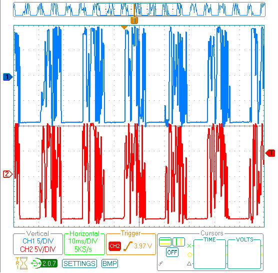

Here is a signal from the tx and rx of the microprocessor. It looks to have alot of noise but this is the signal going to the opto-couplers
attachment.php

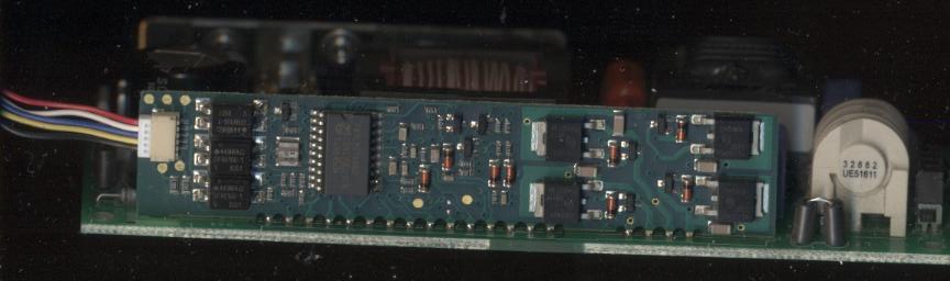

Here is a picture of the ballast and input wires.
Wires are as follows:
attachment.php
attachment.php
RED - Signal Back to Projector From Ballast
WHITE - Ground
BLUE - +5v
YELLOW - Square Wave CLOCK
BLACK - Signal From Projector To Ballast
attachment.php
This is where I get confused.....
The bottom 2 optoisolaters are for input. The middle one being the clock signal and the lower one being the serial information to the ballast.
I was looking at the data sheet for the isolaters and tracing the circuits.
http://www.datasheetcatalog.org/datasheet/vishay/83666.pdf
The top pins get +5V from the blue wire
The signal lines go through 100 ohm resistors and to the bottom pins(Most likley current limiting)
The other side of the the lower optocouplers feed into the microprocessor on the rx and clock lines
On the return the microprocessor feeds ithe tx output into a transistor then to the optocoupler and back to the board
The signals I meaured from the pins of the micro processor are not at all what I expected. The signal looks really noisy
I am thinking maybe I could cut out the micro processor and just bridge the TX and RX traces but I'm not sure it would work
