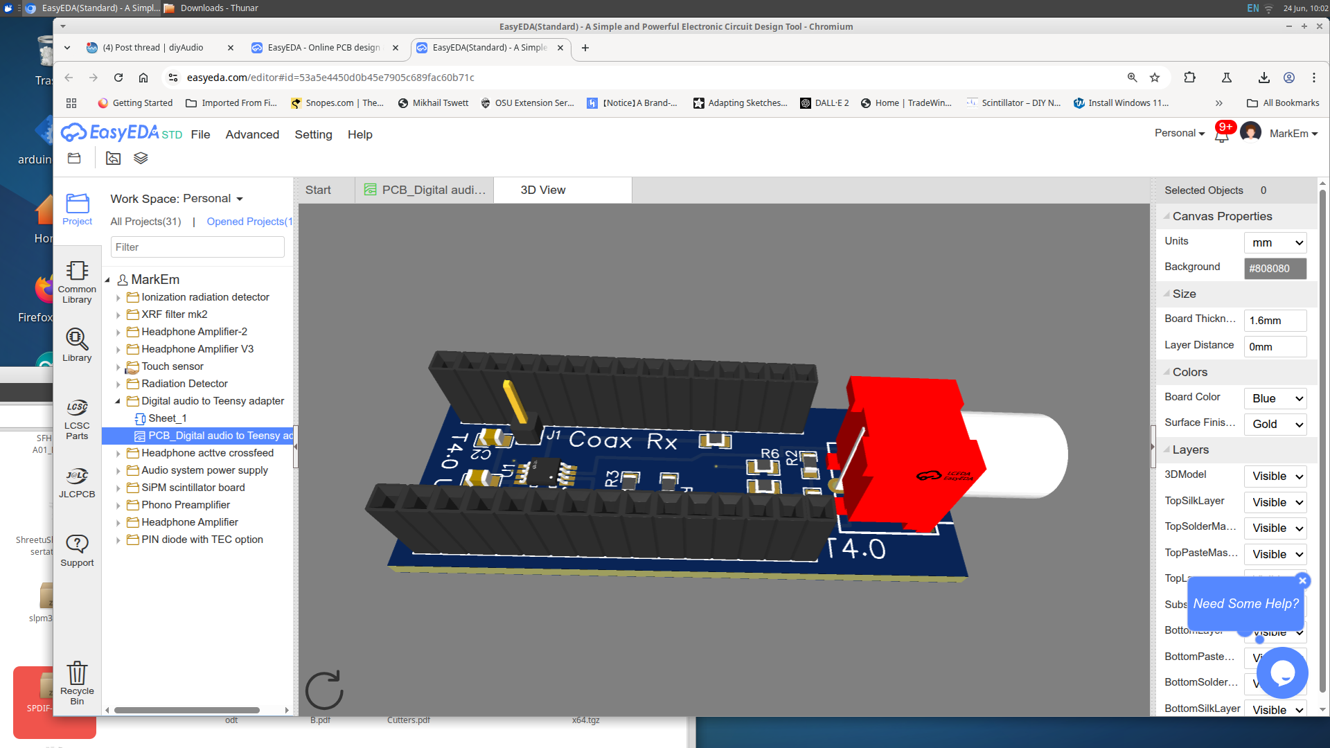

Enter the Teensy4.0. There's a nice audio-processing library for it, which includes SPDIF input and USB-as-sound-card output, and one of the SPDIF input functions has resampling included so converting the SPDIF 48KSPS to CD-audio's 44.1KSPS is easy. The problem is that the digital audio signal is relatively low-level so a line receiver is needed to complete the signal chain. I found a nice chip for that (the LT6752), which also has adjustable hysteresis to help speed up the signal edges and avoid false triggering. Using EasyEDA, I designed and laid out a little 2-sided board -- the 3D view is below:
It just plugs into the teensy, although the two headers are shown on the wrong side of the board -- at least- for my T4.0. The Teensy should be oriented so its USB connector is on the left.

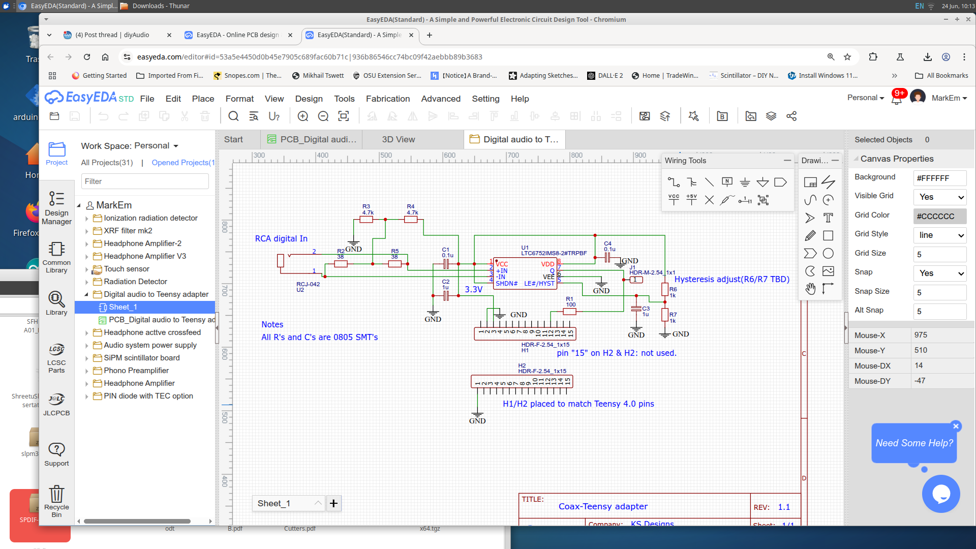

The schematic:
My original design used a trimmer to adjust the hysteresis, but the one shown here uses fixed resistors, values TBD. I haven't used the board very much so can't say what is best quite yet.
