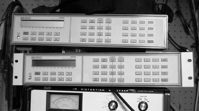

------------------------------------------------------------------jackinnj said:a wonderful selector, easily programmed and dirt cheap due to the TELCOM BUST in the US:
How much is it, and what is the model no please. Can't see from your photo.
The HP3488a goes for around $50 on EBay -- look for one with relay cards: The PCB inside is gold plated and the device can be programmed using HPIB, or from the front panel:
Just found one. $60 for the unit and 35 for two cards, one SPST and one DT. Can't find user manual in the Agilent site though. Can anyone help?
The HP3488A is truly wonderful. Bought one on ebay.de for e60 and cards cost about e15. The HP44472A VHF card costs more (e110) and can be modified for 75 Ohm BNCs. At once you have a digital and analogue switching unit of great flexibility and performance at a great price. You can control by computer too, but control from the front panel is simple.

More ---------------------------------------------------------------
The beauty of the 3488A is that it works even with the unit switched off on the VHF card. Yes, this makes a difference to the sound even with the high degree of isolation of the inputs.
Sorry, but I don't get what you mean. Do you mean that the 3488A works when it's powered down? Power consumption doesn't seem to be an isue and the MPC's don't need that much power anyway.fmak said:The beauty of the 3488A is that it works even with the unit switched off on the VHF card. Yes, this makes a difference to the sound even with the high degree of isolation of the inputs.
Or am I really missing your point here 😉?
--------------------------------------------------------------------------Devil_H@ck said:
The VHF switch on the 3488A reamins latched to the active input even if the power is switched off. This seems to make a slight difference to the sound even though the ps of the unit is far away from the connectors. Semiconductor switches presumably are non latching. Not a power issue.
