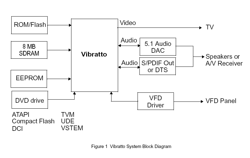

I think this Chip from ESS will do all you want.
DESCRIPTION
Built on ESS’s proprietary and flexible Programmable
Multimedia Processor architecture, the VibrattoTM series of
DVD processors combine audio/video stream data
processing, system control and housekeeping functions
All of the Vibratto DVD processors each include two
parallel processing units, a RISC processor, a vector
engine, and supplemental hardware resources for
implementing specialized encoding and decoding tasks in
the device architectures. All of these resources are
interconnected with two separate data buses, each with its
own DMA unit and interface to external memory.
The processing units enable simultaneous parallel execution of
system commands and data processing.
Both the RISC processor and vector engine are
independently programmable.
Each has its own on-chip
cache memory.
Audio
• Dolby Digital (AC-3), DVD-Audio, Pro Logic, DTS,
MPEG-1 layer 2 and 3 Audio (MP3), and High-Definition
Compatible Digital (HDCD) decoding
• On-chip Dolby Digital (AC-3) and DTS 5.1 channel
decoding and output (ES6018/28/38 Only)
• Dolby Digital and DTS S/PDIF digital audio output.
• Dolby Digital Class A, DTS, and HDCD certified
• Meridian Lossless Packing (MLP) decoding and Linear
PCM for DVD-Audio (ES6038 Only)
and most of all: It can accept external Audio Master Clock for audio DAC.
ESS6008/18/28/38
Audio Interface
The audio interface is a bidirectional serial port that
connects to an external audio ADC/DAC for the transfer of
PCM (pulse coded modulation) audio data in I2S format. It
supports 16-, 24-, and 32-bit audio frames. No external
master clock is required(it can be configured work with external master clock). The Vibratto offers two audio
interface modes:
1. Stereo mode using TSD0 on pin 33.
2. Dolby™ Digital (AC-3) and DTS 5.1 channel mode
using TSD[2:0] on pins [37:36, 33]
The Vibratto audio mode configuration is selectable,
allowing it to interface directly with low-cost audio DACs
and ADCs. The audio port provides a standard I2S
interface input and output and S/PDIF (IEC958) audio
output. Stereo mode is in I2S format while six channel
Dolby™ Digital and DTS (5.1 channel) audio output can be
channeled through the I2S interface and S/PDIF.
The S/PDIF interface consists of a bi-phase mark encoder,
which has low skew. The transmit I2S interface supports
the 128, 192, 256, 384, and 512 sampling frequency
formats, where sampling frequency Fs is usually 32 kHz,
44.1 kHz, 48 kHz, 96 kHz, or 192 kHz. The audio samples
for the I2S transmit interface can be 16, 18, 20, 24, and 32-
bit samples.
For Linear PCM audio stream format, the Vibratto
supports 48 kHz and 96 kHz. Dolby Digital and DTS audio
only supports 48 kHz. The Vibratto incorporates a built-in
programmable analog PLL in the device architecture in
order to generate a master audio clock.
The MCLK pin is for the audio DAC clock and can either
be an output from or an input to the Vibratto
. Audio data
out (TSD) and audio frame sync (TWS) are clocked out of
the Vibratto based on the audio transmit bit clock (TBCK).
Audio receive bit clock (RBCK) is used to clock in audio
data in (RSD) and audio receive frame sync (RWS).
