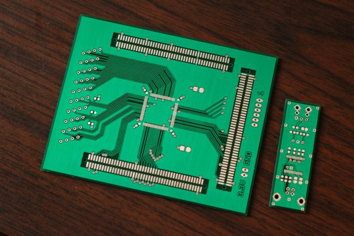

gmarsh said:IDE interface boards for my BF533 EZ-KIT just arrived! Development gets underway when I get this built.
The board looks very nice.
I ordered the BF533 STAMP Board, but it will be available not until the end of May.
So i played a little bit with the ATA interface. I built a small board containing an 8-bit mcu and some hc595/hc165 interfacing to ATA, keys and debug lcd. ATAPI is pretty simple and doing CDDA with Blackfin will be quite easy. Doing it with Linux will be not as easy but feasible.
I am also playing with the Spartan-3 FPGA, implementing "Open Source" MCU, I2S and so on.
And yes, Gary, You're right with the ATA-to-I2S-with-232-stuff. Even RS232 is too much, a simple three wire SPI would also do.
Daniel
I went with RS232, because it (1) allows easy connection to a PC for (re)programming the DSP flash, and (2) avoids 3.3V/5V issues which may arise with a SPI interface.
Almost every microcontroller out there has a UART on board anyway, and there's plenty of software UART stuff out there for the 16F84 and other micros.
And finally, I'm already using the SPI on the Blackfin for flash memory.
