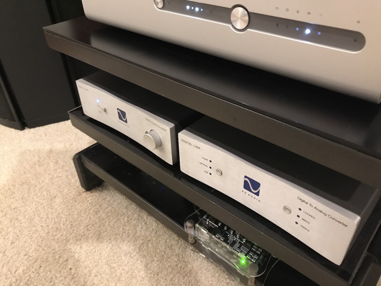

The digiONE's peeking out. Surprised there's not more talk about it on this thread...!
Really simply a reference spdif source for me so far, no need to even worry about it, wonderful musical sound. Working on a whiteup and some comparisons... might play around with power a bit. Used a ciaudio power supply thru the pi GPIO 5V from the start. piCorePlayer/rambuffer/gigabitUsb/BNC-BNC cable setup.
^ and work with it...! It's a bit precise -- may need to adjust speaker placement and your room! 😉
