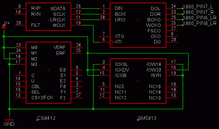

If all you want to do is run it as a standalone dac with no external sync, i.e. CS8412 - SM5813 - AD1860, then thats a doddle. All you need is a little pcb surgery.The wordlength problem insofar as it is a problem will be addressed by the digital filter.

It's exactly the 'pcb surgery' required that I was trying to get info about e.g. which control pins to hack on each chip and what values to set them to - as the CS8412 datasheet mentions the 8 data formats it can be configured to decode, but nowhere relates these to real transport formats like CD-audio. Is it msb first, &c. &c....

Putting these things together is a bit like Lego or Meccano. With enough knowledge and an ability to decipher datasheets, you can interconnect anything.
The SM5813 expects 16bit LSB justified data valid on the rising edge of bitclock (SCLK on the CS8412, Pin 12 and BCKI on the SM5813, Pin2). In order to use the embedded SPDIF clock, bitclock and L/R clock (FSYNC on the CS8412, Pin11 and LRCI on the SM5813, Pin28) have to be configured as outputs. This equates to mode 5 of the CS8412. To configure this mode the mode pins have to set as follows,
Pin 17 M3 = 0
Pin 18 M2 = 1
Pin 24 M1 = 0
Pin 23 M0 = 1
The SM5813 also requires a master or system clock on Pin 6 XTI.
With an external reference, system clock at 192/256/384/512Fs, bitclock at 64Fs and L/R clock at Fs would be generated. In this case all the clocks will be generated by the CS8412. The CS8412 only does 256Fs (MCLK Pin19), so this should be connected to XTI on the SM5813. To configure the SM5813 to accept system clock at 256Fs, /CKDV, Pin 4, has to be connected to V+ and /CKSL, Pin3 has to be connected to GND. You may also have to check /RST Pin 14. This may be connected to the computer port to allow an external reset. It can be connected to ground.
On the output side of the SM5813, the wordlength has to set to 18bits to match the AD1860. Connect /OW20, Pin 16 to V+ and /OW18, Pin17 to ground but they should already be set as should most of the output side settings. The connections to the dacs should need no alteration.
