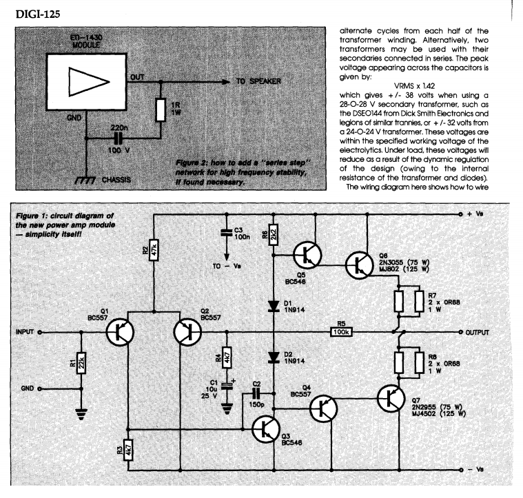

DIGI-125 Kit Amplifier Module
With regard to that somewhat underspecified VAS transistor Q3,
I trawled through just about all of the BCXXX series and found the
BC639, whilst not ideal, is a moderate improvement over the 546,
with a Vceo of 80v. as opposed to the 65v for the 546.

A 2n5xxx can be used instead of a bc5xx
They just need to be turned around since BC is cbe and 2n is ebc
2n5551 is 160Vce0, 600mA 625mW 5pF Cob. hFE is much lower, but can usually be tolerated if you take steps to balance the LTP collector currents.

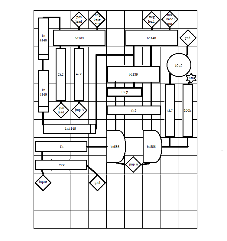

I have now built several of these modules with zero success. I started with the original schematic, then tried the rodded version rawbas posted. The last at least had output, though heavily distorted. I thought maybe my ebay bought transistors may be culprit but testing the buggers in a joule thief circuit with scope between collector and emitter revealed nearly identical output with each bc556 transistor I dropped into the socket.
I am using + - 30v on the rails, saw mention of issues with LTP a couple pages back, but being new to this I am not quite sure what I need to do to sort out issues there, nor how to set up the LTP itself and test the standalone differential pair using a single scope.
Would adding a current mirror to the differential pair add stability to knockoff components if this is the issue?
Measuring the voltage drop, I have a 1 volt drop from rail voltage to the other end of 4k7, but 32.4 volt drop to the other end of 47k feeding the LTP. 0.5volts...
inductance issue?
So after taking some measurements and looking over my topology, I am drawing a fair conclusion that the 1n4148 diode located directly beside the 1k input resistor may be inducting the .5 volts to the base of Q1 causing DC offset of my long tail pair.
I did a little drawup for this to be constructed on perfboard, trying to keep the layout as compact as possible. I started a new build with only the differential pair and VAS thus far, plan to power it up as is and take some measurements.

Original schematic.

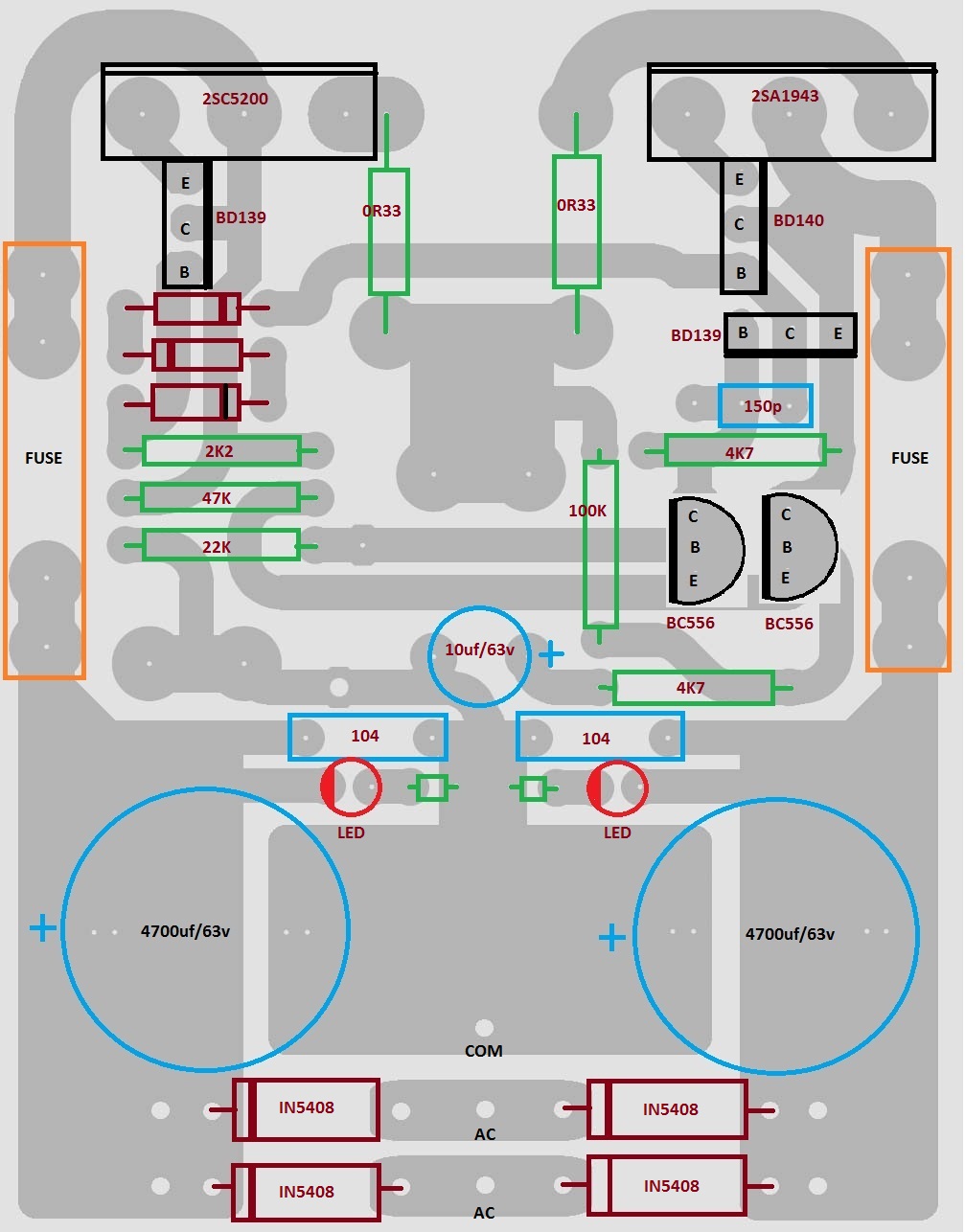

I have constructed the circuit from Muff's from post #70 and tweaked some as I mentioned on post #132.
Can you measure the voltages of your transistor Vbe, base to emitter pins?
they should be around 0.5v to 0.7V.
If you have constructed the amp using the PCB layout you have posted, try reducing the 150pf (Cdom) to 56pf to 100pf.
I have encountered LPT imbalance when I have constructed the circuit, check and double check if they are properly connected, probably one or more devices has issues or already damaged, also be mindful of your groundings.
I suggest to post the circuit you have constructed and the corresponding measured voltages you have mentioned.

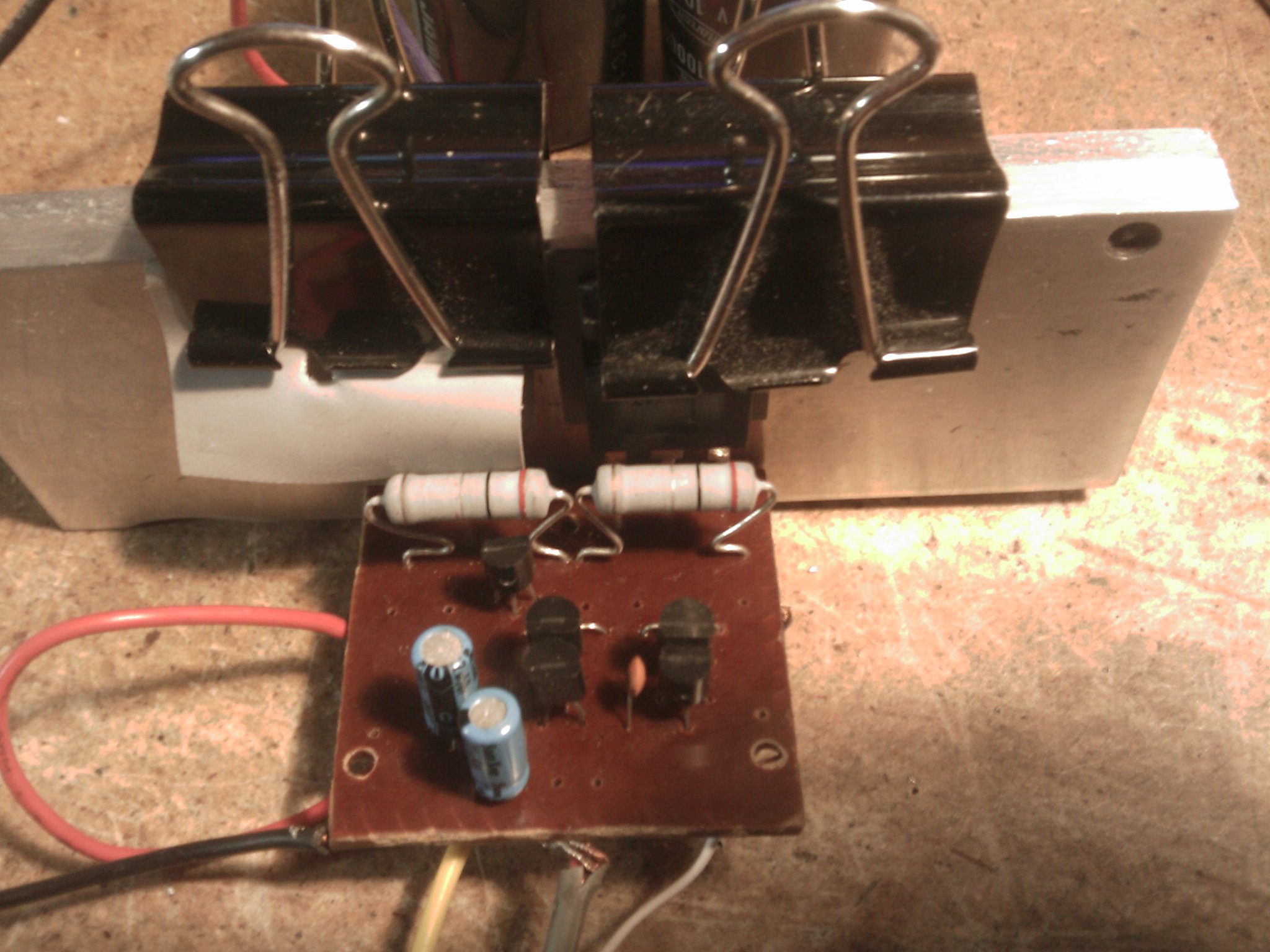

I saw a few digi-125 builds at the time PCBs were easy to buy. Directions for the amount of heatsinking were not covered in the article though, since the power rating was arbitrary - up to you with only suggestions for suitable power transistor types.
In the same spirit of cheapness, some constructors just bought short, packaged lengths of the extruded aluminium section, similar to that shown attached. These were likely bolted flat to the rear of a steel amplifier case and only just accommodated 2 x TO3 transistors, unsuitable for more than light duty. Yes, this did result in overheating as you might expect when run at party level and I believe that some amps were oscillating in that dire condition as they died.
A fire though, requires something combustible, not TO3 transistors but probably the plastic TO92 drivers, before they died trying to supply the current to sustain oscillation. This doesn't amount to a bad design but rather the article was pitched at constructors who already had some understanding of audio power amplifiers and their requirements for safety and cooling. I don't think that electronic hobby magazine readers in general, were so well informed.
