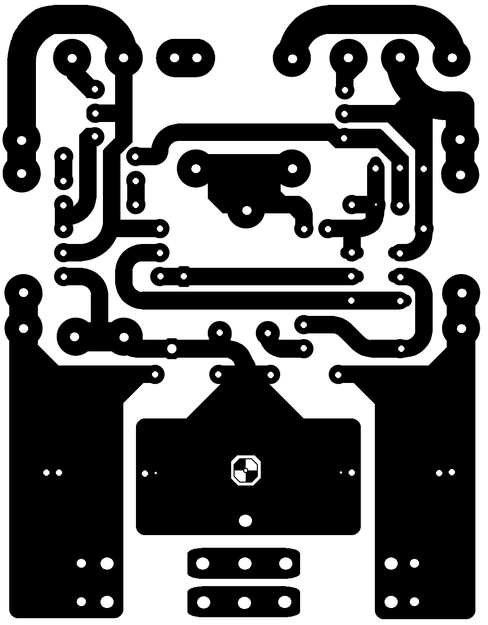

Rakesh,
Should be fine. You will have around 40V rails, which is fairly high for a single pair of outputs, the drivers will both be fine but I'd be tempted to use a faster transistor for the voltage amp - again a TO126, something like a BF469 would do nicely.

Hello Rakesh, as Hugh says, good work, however......
I would shift the speaker return to 5mm above the Com connection and put the 0.1 decoupling caps just above the diodes.
Ditch the led's and make the earth land wider so that the input ground and the C1 10uF/63V cap can have their individual earth connections - the ground for that NFB shunt cap is critical and should not be tangled with any other earth currents.
Also the input is shorted to ground !.
Also shift the output connection up to the middle of the land, and the R5 connection down.

Many thanks ..
As per transistor for the voltage amp, initially start with BD139 and will replace it with BF469.
will update layout soon..

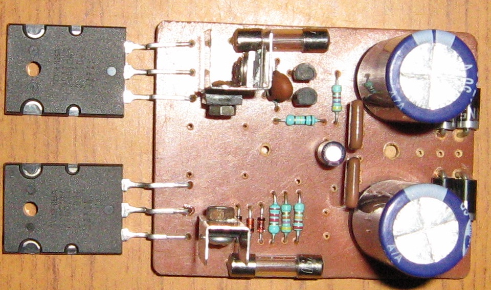

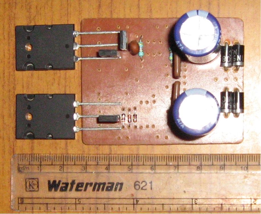

Test Amp construction under process...

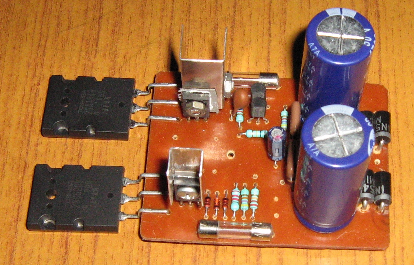

sir i'm planning to use 1 psu for all the amps. but is it ok with same transformer?

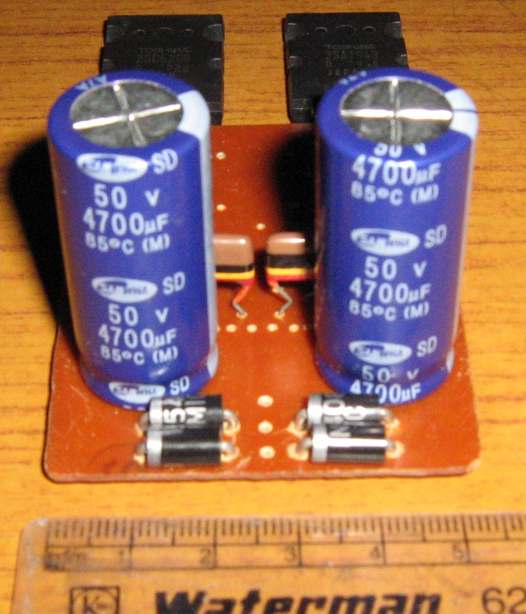

sir what is the size of your pcb?
I think its ok to power all amp with one single transformer and multipal PSU Circuit.. Until and unless tranformer have that much juice..
PCB Size = 7cm x 5.5cm
Work under progress

Could you post the component overlay for your board.Test Amp construction under process...
