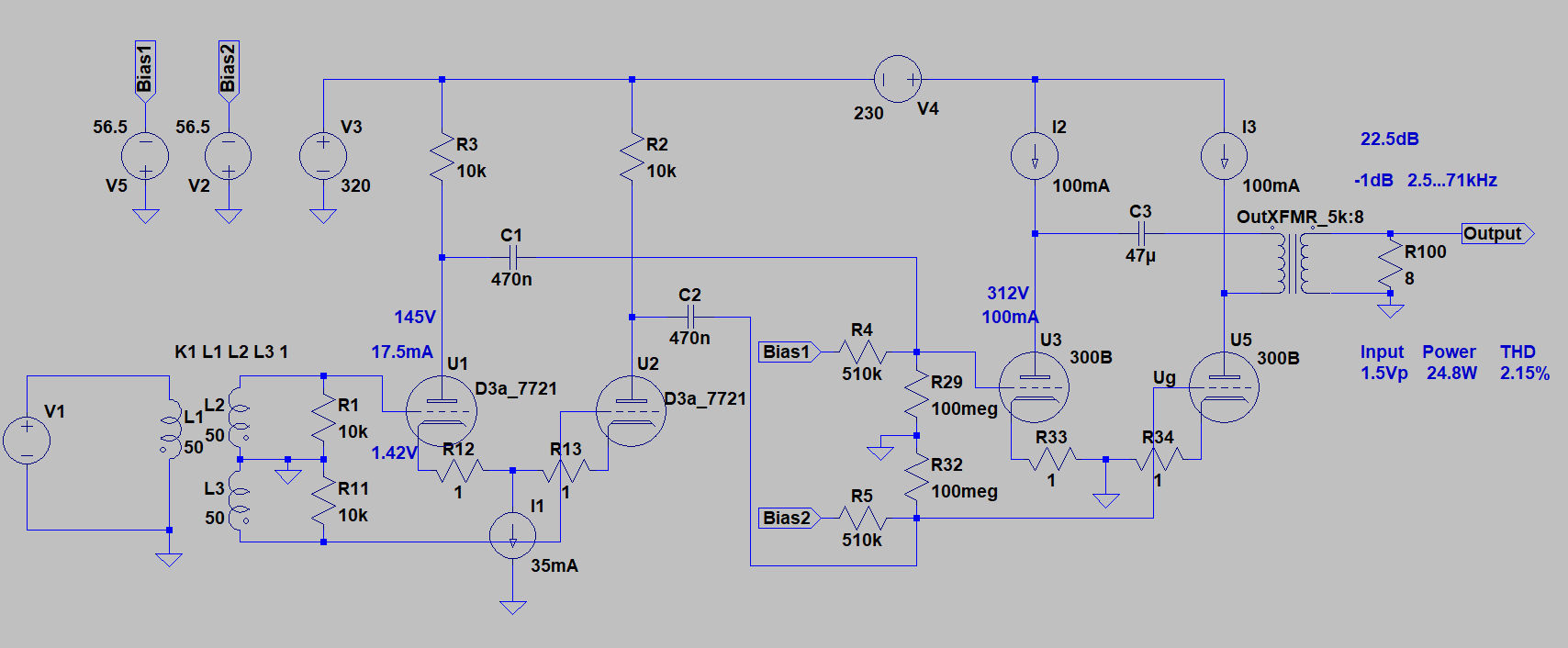

That is a DC blocking capacitor for the transformer primary.
It is still necessary even though the circuit is symmetric.
The transformer cannot tolerate direct current, and tubes will vary and age.
This is differential and parafeed.
It was only a brainstorming few years ago.
The parafeed feed out is serial LC circuit (let's ignore the rest of other parts of schematic), which have resonant frequency, where its impedance has minimum.
In my practice I strive to keep away any resonant point from required frequency range, if possible at least a decade away. Therefore the LC resonant point near to 2Hz is acceptable.
Usually the transformer primary inductance is given, so parafeed capacitor value can be changed.
The low value (few uF) results higher frequency given breaking point (for example -3dB) and strive slope, the higher value -good- capacitors cost would be enormous.
Each parafeed circuit requires online measuring (usually has bump at lower frequencies) and iteration (simulation never perfect).
