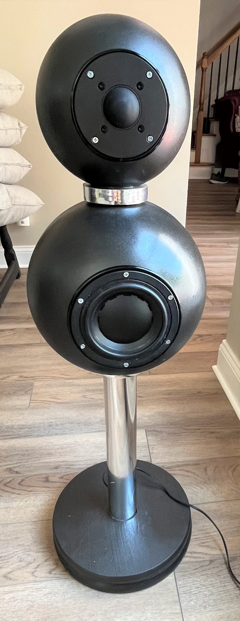

The two way spheres I made get down to 100hz with the midwoofer albeit spl maxes out maybe 95 without worrying about overdriving it
But loud enough
The dynavox has a 3” coil so robust and domed shape so avoid even diffract ion cones can generate
But loud enough

Good thing is that you can easily do the internals of a sphere, non-spherical 😉Well we can objectively state that baffle step diffraction certainly does create peaks and dips in the frequency response (linear distortion). We also can objectively state that generally the smoother and flatter a frequency response is, the higher likelihood an average of many individuals will prefer said speaker.
I also know that I can pass a blind test with 99% confidence down to a .5dB change in amplitude.
Blind Tests
Either way, even if Gedlee's white paper is wrong, it is still optimal to reduce baffle step diffraction distortions.
As Grasso pointed out, a sphere will have the least baffle step diffractions. Although, this comes with the compromise that internal standing waves in a sphere are the worst possible. I think the "hyper-cube" design is a nice middle-ground, because it has no parallel surfaces to my knowledge. Although, either a sphere or "hypercube" will have limitations due to internal volume.

In my recent experience building small spherical speakers I have not found the internal standing waves to be a significant problem. Stuffing the sphere with a ball of acoustic foam or fiberglass batting seems to work fine damping out the internal acoustic resonances above 300 Hz.As Grasso pointed out, a sphere will have the least baffle step diffractions. Although, this comes with the compromise that internal standing waves in a sphere are the worst possible. I think the "hyper-cube" design is a nice middle-ground, because it has no parallel surfaces to my knowledge. Although, either a sphere or "hypercube" will have limitations due to internal volume.
Here's an impedance sweep from my recent 4" sphere build. There is a small wide bump at 1600 Hz, but this resonance does not seem to harm the sound.
