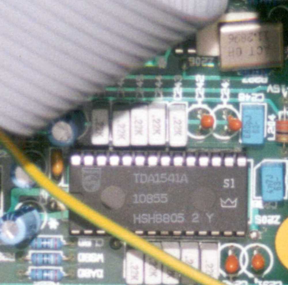

Just putted the 74LS163 next to the XO, connected in "free running mode"
Must say, not bad, the spaces of recording-rooms or delay-times are better defined now with the /4 clock to dac. A test with a background eighties sampling CD: the stock-aitken-waterman (correct me if i am wrong) Richard Marks sings now in front of me, is better articulated. The Blue Nile (by Linn records) has a greater ambience now. Also Jack Johnson has better refined siseling sounds of hi-hats.
The LS can only work to 32 Mhz and a HC on 5V +/- 50Mhz, but 32 is sufficient imo.
With OS you can take /2 from pin 14, for Nonos /4 of pin 13, and even /4 (1.4Mhz) or /16 (705kHz) is possible. Pin 1, 7 , 9 and 10 are on +5V supply by a 1k resistor.
Scope testing: very small overshoot(measured without load!) but nice squarewaves seen, wave doubling in size from QA to QD's output.
Have another clock, next i will do is a -04 hex inverter between clocks output and -163 to cope with the small time delay induced by the divider. Will try it with a jumper: with/without -04.

Now for a question to do with the next stage after direct /2 clocking from a Tentlabs XO2 - converted to a XO2.5. The Arcam's existing 74HC74 and hex inverter will be redundant. What do you think of replacing the 74/04 with another 74HC74 - and using one half of each FF to reclock WS and Data?
The attached picture shows the logic chips partially hidden by the wide, grey cable. This is where the signals enter the board and diverting them through the FFs would not increase the signal path by very much. The bottom left corner shows where the signals enter the TDA1541A via resistors. Is this a reasonable idea and should those 390R metal film resistors stay?
Regards
I have beed reading Guido's article (nice work Guido) about HF, so mounted 47ohm stopping-resistors there. Original was zero ohm, but i don't know 390 is too heavvy.Is this a reasonable idea and should those 390R metal film resistors stay?

Hi all,
I just tried the direct clock method, and this is what I have done so far:
1) keep 4x oversampling
2) cut CLBD trace between SAA7220 and TDA1541A; WSBD and DABO still attached to TDA1541A
3) divide 11.2896 MHz system clock by a 74hc163
4) pin 14 of the 74hc163 goes directly to BCK of TDA1541A. As I am experimenting with "1/2 clocking", I used a piece of 11" stranded wire to interconnect the two chips.
5) pin 4 of DAC still connected to BCK
And I got no sound at all. So probably I have done something wrong here? Wires are too long? and should I also cut the trace between pin 2 and pin 4 of the DAC and connect pin 4 to ground?
honinbou
honinbou
Hi Honinbou
Check 1/2 Clock on pin 14 of 163 with scope, if it is 5.6Mhz this part works correct. Connect by a 47ohm resistor to dac.
Pin 4 must be on Gnd with the "A" 1541
Good luck
Btw 74HC74 can do /2 also, see somewhere else here on diyaudio. The /163 has more dividing-options though if you want to try nonos too.
Good luck
