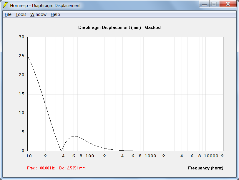

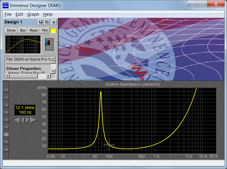

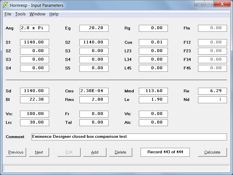

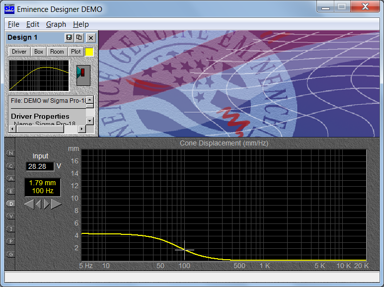

Hi OMNIFEX,

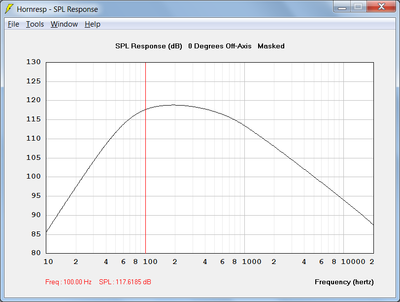

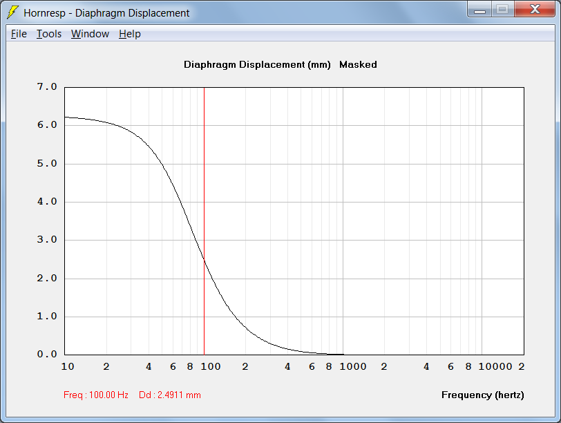

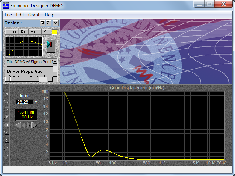

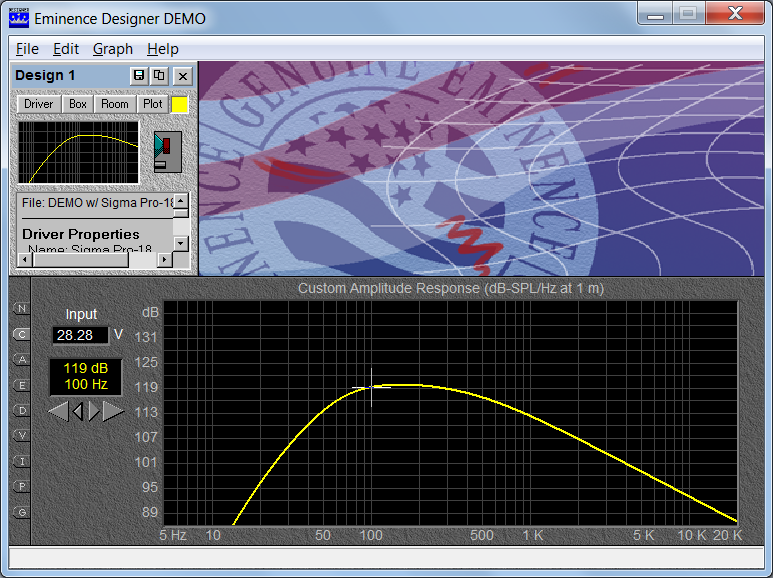

My curiosity got the better of me - I couldn’t resist downloading a copy of the Demo version of Eminence Designer and having a play 🙂. It turns out that the Eminence Designer results are much the same as those generated by Hornresp (with the 'resonances masked' option selected).
The result comparisons for a simple closed box example are attached. The very short cylindrical horn included in the Hornresp design has no noticeable effect on the results and is there simply to allow the directivity tool to be used so that the on-axis pressure response can be displayed - similar to Eminence Designer.
The difference in diaphragm displacement values is due to Hornesp calculating the peak figure and Eminence Designer giving the rms figure. The results are practically the same when normalised.
Eminence Designer Inputs:
Density of air = 1.205 kg/m^3
Velocity of sound in air = 344 m/sec
Default driver parameter values
Closed box
Vb = 100 litres
Vb locked
Default box shape
Classical box calculations used

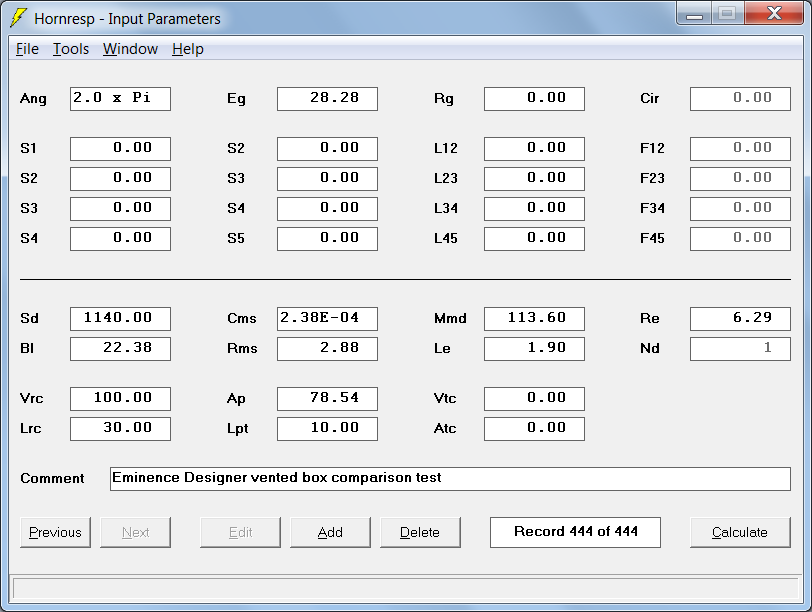

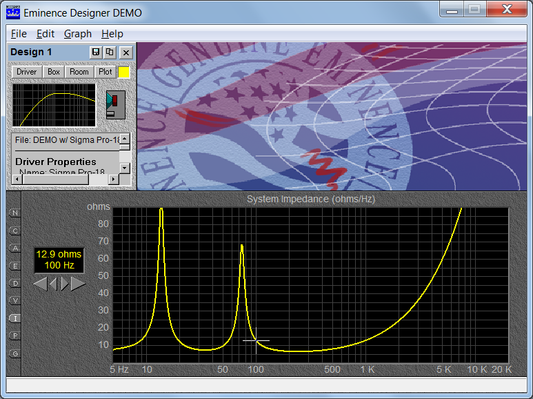

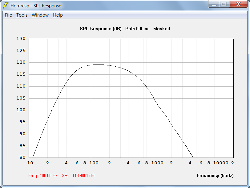

Vented Box Comparison
Hi OMNIFEX,
The result comparisons for a simple vented box example are attached. In this case it is not possible to use the directivity tool in Hornresp, so the power response rather than the pressure response is shown. This is why the Hornresp response falls off more rapidly at the higher frequencies than does the Eminence Designer response, which is extended due to on-axis directivity "beaming".
Eminence Designer Additional Inputs:
Vented box
Single round vent
One flush end
Dv = 100 mm
Lv = 100 mm
Vent dimensions locked

Upon viewing the graphs, the two are so close you cannot go wrong with one or the other.
I never focus on maximum output power in loudspeaker simulation software for in pro audio there are just too many variability’s to take into consideration. My main concern is more to wards the consistency of the frequency response. And they are pretty much the same.
