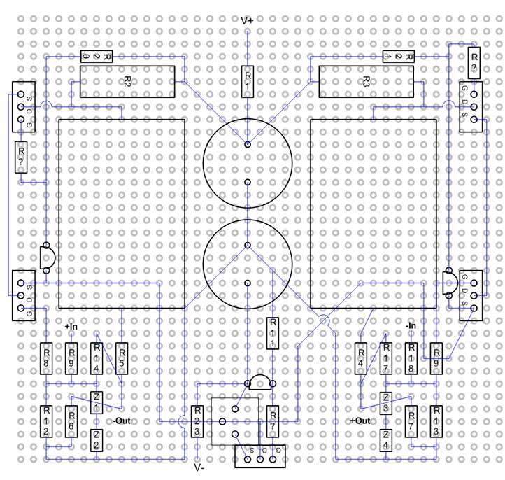

Do you have the PCB layout ?
Nope. It is a pretty simple circuit, and I only planned on building it once, so I didn't bother with the effort of creating a PCB and just built it on perfboard. I do have a layout for that, which is attached below.
Cheers, Terry

thomasfw,
To increase the gain of my circuit, just increase the values of R15 & R16. Max gain is achieved by disconnecting the feedback resistors R15 and R16 which gives approximately 38dB. If you have a specific gain number in mind, let me know and I can get back to you with exact resistor values.
Terry
