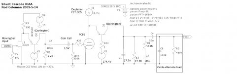

Differential Shunt Cascode Driver

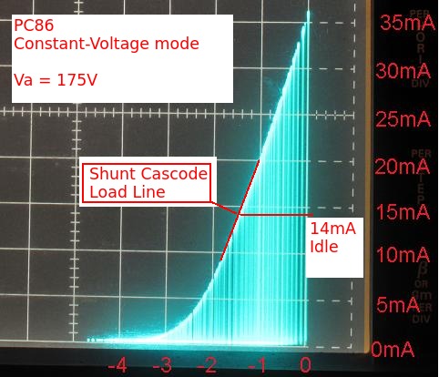

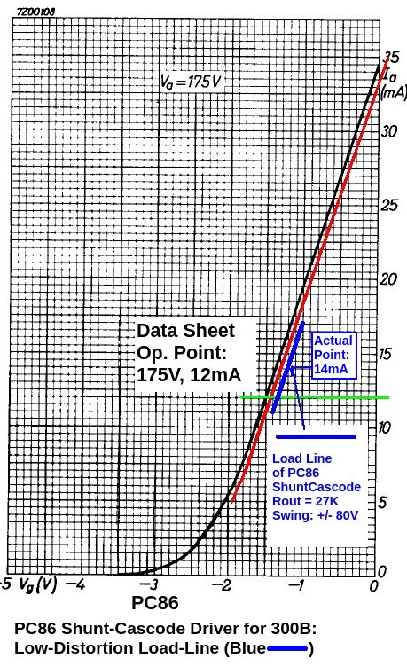

Yes, Don, this is the debate we had a couple of years ago. It was resolved by the taking of the curve-traces (sample attached) which demonstrate clearly that the real tube is just as good as the data sheet, for constant voltage use.
As usual, if in doubt, please measure!
