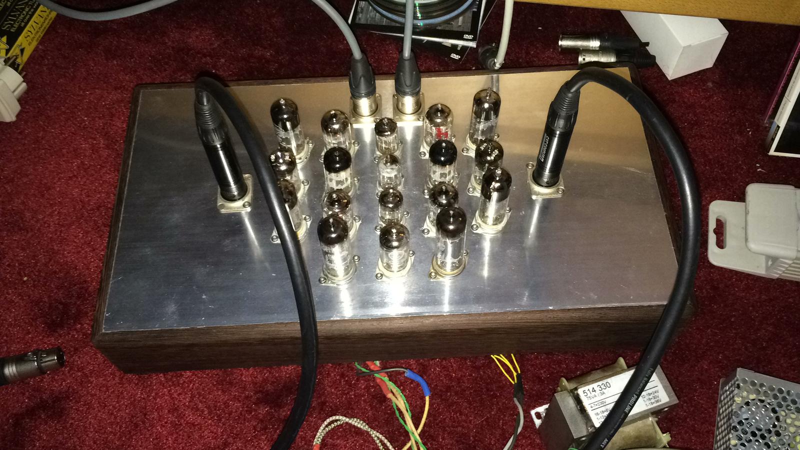

Just looking at that - the 6SN7 heaters are ok on the cascode as the zenner would keep the voltage low (well 47V + the peak < Uhk) but the cathode hung differential stage (V4) may need elevated heaters?
I'm being cheeky and looking at the front end of that with BH7s driving a PP output stage in LTspice atm. 6SN7 is a little more forgiving on the heater than the mini-me tubes but I think that V4 may need some attention.
