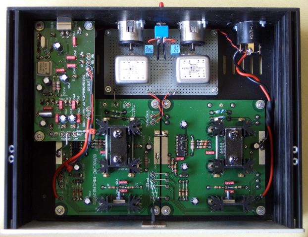

This is what a DDDAC DIY did to get a balanced signal:

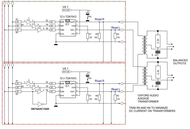

revintage said:
What will happen if one takes two complete DACS and connect them with input transformers via SPDIF from the same digital source with one of the transformers phase-reversed? Will the analog signals be phase-reversed too?
Fraid not. SPDIF is NRZ encoded, and will decode to the same data if you invert the transformer.
I'd use a single SPDIF receiver, but put an inverter on the I2S data line going to one of your DACs. This will invert the digital data going into that DAC, and will effectively invert the analog output.
(Please, oh please, don't let this turn into a discussion of 1LSB error.)
Thanks for the replies, it was like I suspected.
I have two identical DACs, and just hoped the solution would be even simpler. It will be no problem to use the input circuit on just one of them.
ddac, have seen variations on solutions like yours, but your version of phase inversion before the chips seems very simple and straigtforward with only one NAND-gate. As I am a novice on logic circuits what are the 5 others marked 2-3, 5-6, 9-8?
Couldn´t adjusting R7 be a way of minimising offset, or do L and R differ?
