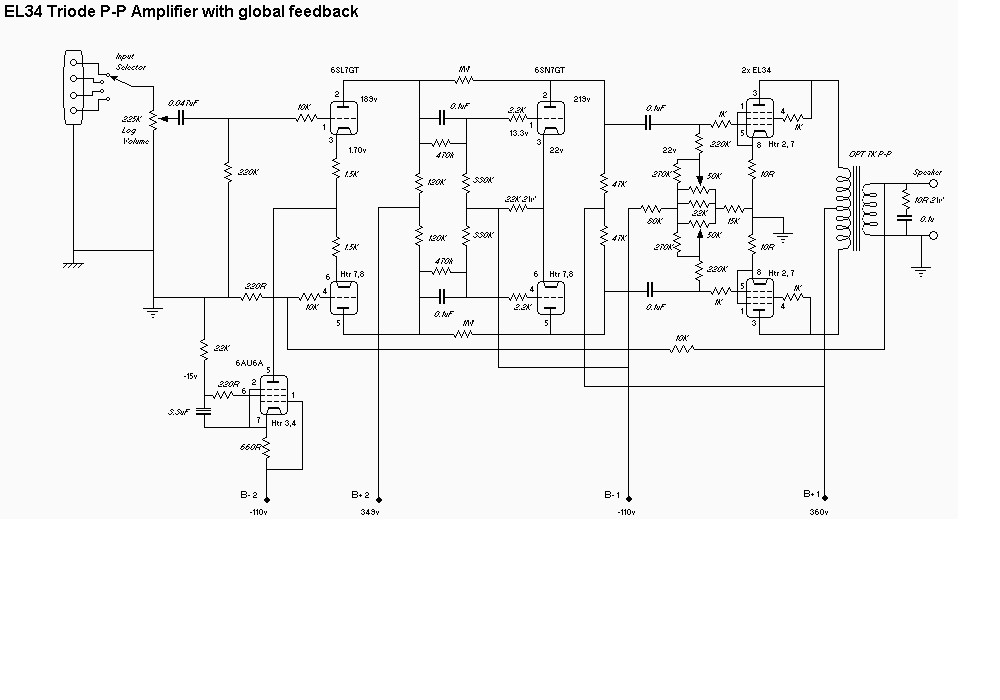

The attached is my EL34 triode-strapped PP amp which starts with a differential (LTP) splitter, using a pentode as current sink for the tail. If you build it you may have to experiment a bit with the bias network to get a useable range. I run the El34s at about 45mA but my particular tubes are el-cheapo so-called "Svetlana" (not winged C) and have unusually low transconductance.

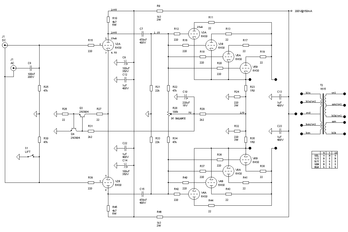

Here's another one. It's the front end / driver for a power amp, but would work just fine as a differential linestage. It's a little odd in that it uses a dc supply from the output tube bias to power the current source on input. You could use a 6.3Vdc heater supply for your application. Or similar.
The current source is key to optimal operation here. It provides better ac balance for the outputs (plates), plus it offers input common mode rejection (small range).
