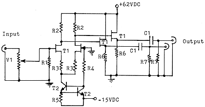

The whole point of a differential receiver is to reject common-mode signals, including common-mode dc offset. My suggested differential opamp topology will work to remove that offset, so long as the differential offset at the output of the I/V stages is low.

The 2.8v is common-mode, common-mode is what a differential circuit rejects, it won't show up on the output.
What I meant when I said "as long as the differential offset is low" is that the DC offset on the output will not depend on the common-mode offset (remember it's rejected) but will depend on the differential offset of the DAC. As long as both DAC outputs sit at the same voltage (2.8v) the single ended output offset will be low, any differential offset from the DAC will be indistinguishable from desired signal and WILL show up on the output.
