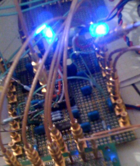

A blue 5 mm LED works.
It comes very close to the desired 1,7 V switching point.
Swing is 700 mVpp, a bit reduced by heavy load.
A 100n cap distorts the 44100 Hz square waveform.
I will make another one for the other channel with a bigger cap and do a listening test.

I had to add an EL11 as inverter for the other channel because the translator was in inverting mode, fed from Q_ of the flipflop.
No listening test yet.

I did not have much time for listening tests yet but what I heard, the LED translator sounds as good or better than the 10125. Without caps.
