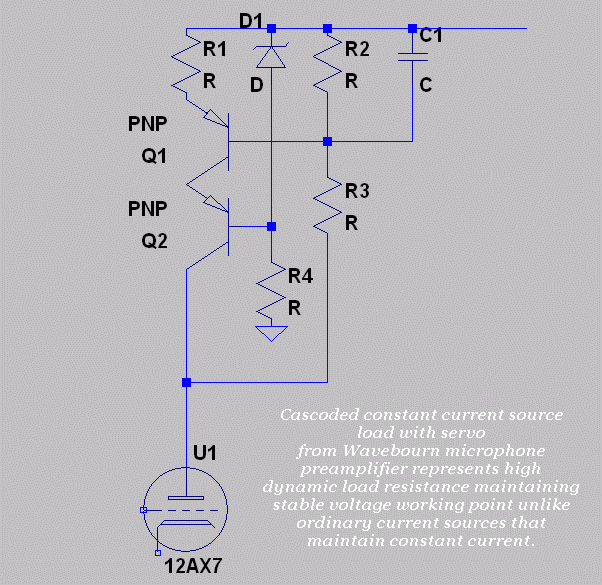

ErikdeBest said:Hi Wavebourn
I remember this active load appearing at earlier discussions. It was suggested that it could be used quite simply in a differential pair, with a cascoded CCS on the tail, something like adjusting the tail current and the plate currents would set automatically at the desired plate voltages. I spent some time thinkering about it, but eventually gave up, I could not grasp how that one would work. Unfortunately I am not able to find that thread, so the above may all sound vague, but if it does ring a bell, could you explain it a bit further, as I am very interested.
Hi Erik;
The lower is the voltage on anode, the higher is current through R2 and R3, the higher is voltage drop on R2, and as soon as it is enough to break-down PN junction B-E of the upper transistor, it starts conducting C-E current. The seconde (cascoded) transistor repeats thius current increasing dynamic resistance.
So, a voltage on anode will be always defined by R2/(R2+R3) ratio. while current will be adjusted accordingly.
It looks like an ideal (in terms of distortions) choke (Gyrator, i.e. transformer of a capacitive impedance to an inductive one)
Currently I use JFET instead of an upper transistor, so R2 and R3 may have a huge value.
