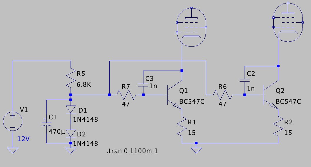

A closer look at the circuit reveals a definite problem - and it may well explain what Ian's seeing.
The 8233 data shows triode-mode characteristic at the nominal 125V on the anode. At this voltage, Ian's desired 30mA current is achieved with a bias of about -3,5V. At 110V, it will be -3V, or even closer to ground.
This bias voltage has to establish the working voltage of the LM317. In current-source connexion, the LM317 requires 1,2V to satisfy the reference, plus the dropout voltage of the regulator parts. the 1978 National data shows a typical value of 1,5V at 20mA (25 deg C). So the minimum operating voltage for the CCS will be about 2,7V - with a strong temperature dependence (needs more volts when cold).
As you increase the 8233 anode voltage from say, 80V, you begin by offering the LM317 only about 2V to work from. In this condition, it will either draw no current, or turn ON hard. It will certainly not be regulating the current! At a certain anode voltage, the bias required by the 8233 will meet the minimum required voltage for CCS operation, and it will start up. I think this is what you are seeing as you turn up the voltage. It may just be that the LM317 is unstable in the region of not-quite-enough operating voltage.
I am still not convinced by the idea of having a CCS in the cathode circuit, when one has a (piecewise, at least) CCS in the anode.
The easiest way to confirm or deny my claim: slide a 100R 0,5W in place of each LM317.
If you are committed to the CCS in the cathode though, you'll need one with the compliance extending all the way to within 1,5V of ground.
It would also be an advantage to be able to trim the working bandwidth of the cathode circuit, so that it does not provoke instability in your (very) high gm pentode.
Here's my take. The circuit attached gives a reasonably balanced and tracking pair of currents, especially if you epoxy the transistors together.
C2 and C3 provide poles to adjust, so that you can damp down oscillations provoked elsewhere. These can be raised to 220n if desired, MKP stacked film parts, please!
Best of all, the compliance extends down to +1,4V; so you can easily bias the 8233 within the optimal operating range of this CCS.

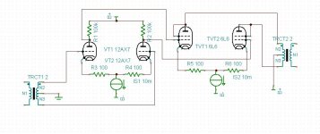

What is the reason for using two CCSs in parallel in the cathode of the 2A3s?
I actually do not see what exactly OP wants to achieve with all these current sources. I am not convinced that current source is a good application as driver for power tubes.
I've been playing with this circuit now for a few days. It can sound very good but there is a noise issue I'm not sure how to approach. When the "right side" SVCS board is set to anything above 108 VDC there is a white noise (pfffffff) audible on the speaker. (The noise off-on knee is sharp, over something like a volt or two) If the other SVCS is taken up above about 120 that noise increases by something like a third. If I take the right hand plate on its own up to about 180VDC the noise then stops.
Thinking there might be some kind of current source interaction between the SVCS and the LM317 I have tried bypassing the SVCS loads with 180K and also 100K resistors. I've also tried bypassing the driver tubes with a 180K resistor from plate to ground. I think the noise is lowered a little in each case but by hardly enough to justify leaving the resistors in.
The amp sounds great with the driver plates below 108V but the operating point can hardly be dictated by the limits of a problem. I believe something is oscillating but where and why I don't know.
I also tried resistors for plate loads. No hiss but the sound isn't nearly as good as with the SVCS. Can anyone offer suggestions?
The SVCS board circuits are as in the Schematic posted here but with Q1 = ST P3NK80Z , Q2 = FQU11P06TU , Q3 = MJE5731A
Also not shown on my drawing both 8233's have 100R stoppers on G1
I don't mean to be harsh, but this a bit of a mess...
Please, only ONE CCS in the LTP. You have way too many parts in there. It doesn't appear to be a true LTP anyway, since the cathodes are not DC connected. Replace the anode loads on the input pair with just two resistors. The output tubes can have one CCS with the 2 degeneration resistors, no problem, but two CCS's will cause problems.
Another problem is that the CCS in the LTP do not have enough of a voltage drop across them to function, since you've connected them to ground and the grids are grounded as well, unless you have a huge bias on those input tubes.
I believe you are trying to do something like this. I don't have spice models for your particular tubes, so this is just an example of possible schematic. If you use CCS's, you generally need a B- supply, depending on what kind of CCS you are using. Hope this helps. The only way to control the gain in this kind of circuit that I know of is to change the degeneration resistors in the first LTP. They have to be matched, of course. You may have to do things like capacitor couple the input stage to the output stage, or other things that I have not shown. Other details that I have not shown are things like how to deal with DHT's and CCS's as well as degeneration resistors. I don't have a clue about that. That's for someone else to work out. I just wanted to show the basic concept here. This is not a working schematic, in other words.

I don't have a clue what you are talking about without a schematic. I tried to help the OP. Obviously, you can choose to create something different. Please go ahead and draw something up and post it like I did. I did my part and now I'm done.
This amp shows all of the properties described and has been stable without adjustment for over 5000hrs so far.
Simply because I had several already built and the load was too much for one with the heat sinks I have.
Since 2A3's don't actually have cathodes, what is the actual circuit? Might be something interesting there.
Very simple. 2.5VAC transformer for each 2A3. 15R from each filament pin to each end of a 5R pot - wipers on both pots to the top of the tail CCS.
I guess this is why schematics were invented. So there's only one CCS?
Thanks,
Chris
Effectively yes. There are two as shown in my scribbled schematic, in parallel, connected at the output, with a small resistor to each filament for easy measuring of current balance.
