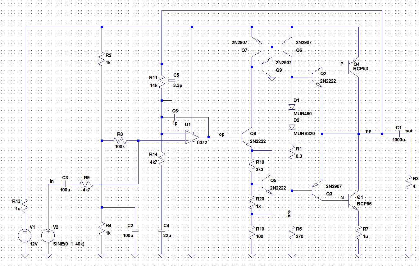

I'm designing a system, where i need an ultrasonic speaker, range 30Khz - 80Khz. I have tried some piezo elements, but found they have horrible ringing which makes them unsuitable.
I just noticed that there are som audio speakers with spec up to 80KHz. Does anyone know a source of cheap tweeters (or an alternative) that we can use in that range?
Forgive me for posting off-topic, but in all honesty, who knows this things better than the audio people?

A 3D motion sensor, in essence. I've looked at plasma tweeters, but that is too expensive.
Thanks for the link, a bit pricy for our purposes though.
Plasma speaker is a suitable and reliable solution, the other is a SuperTweeter from Pioneer TAD or a Fostex T500 or T90a alnico one.
Thanks, interesting that they could build alnico with that wide range.
Can we get an ESL response up to 80KHz?
I imagine the main issue is the transformer, but with direct drive and a very small diaphragm this might be possible.
I'm sure that would work, but very expensive.
I ended up ordering a pair of NeoCD 3 (Products_Fountek Electronics Co.,Ltd). They claim a pretty straight response up to 40KHz, remains to see what happens higher up.
For our prototype board (which is a daughter board on a fpga board) i designed this power amp for driving each ribbon tweeter. We only have a single 12V rail, so i needed something that can drive almost rail to rail with low distortion up to 2MHz (-1dB). I came up with this after some experimentation. Over 4Ω, THD @ 9Vp-p is 0.02% and @ 10Vp-p about 0.2%, which should be ok. Biased at about 20mA.
Any constructive criticism of the design is most welcome, in particular simplifications.

Hahaha, thanks for the idea about the neighbours dogs! Where i live it's a problem. I will try to get their attention too
A small ESL driver can be made for just a few bucks.
And an amp for just a few bucks too using a dual opamp and a pair (or two) of HV FET's.
Here is a design that I used at 180V to drive a piezo driver when I made it, It was intended to drive my ESL's but I didn't have them running at the time.

The schematic worked with every FET that I had laying around with just a simple adjustment to center the output voltage at V/2.
I haven't got around to working on it some more since I had burned up my pair of load resistors at the time.
Since then I have learned how to replace them with FET's as current sources as shown in the rest of the pictures.
Basically it is like the Neil S. McKean's ESL Amplifier, Stax uses this same configuration for thier Solid State ESL headphone amp design.
