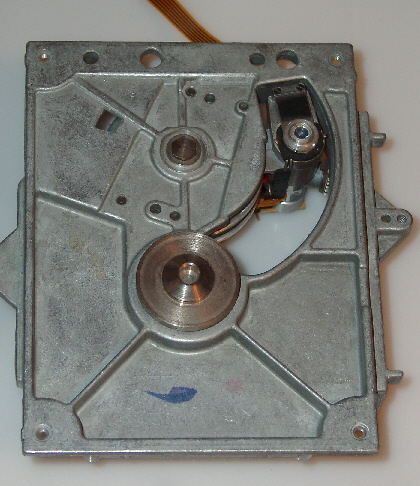

In the CD650 there is a CDM2/29 and in the CD304 there is another swing arm transport made of geyish aluminum. Not marked as any CDM.
Bernhard
Transport from CD304/mkII

Interesting isn't it?🙂 For your information the cdm used in your CD 304 mkII is a CDM1. As you can read in other threads defenitely my favorite.
You do hear differences. As you are interested to know what causes the audible differences it is important to very carefully sort out the differences between players. Before jumping on a conclusion think it over again. CD audio is full of surprises!
The CDM1 was made in a time that all the limits in designing a player where not fully known. So from production perspective you want to be save. Lateron as more knowledge was gained costprice becomes more and more important (cdm2, 4 etc.). So this cdm1 is a bit overdimensioned.
