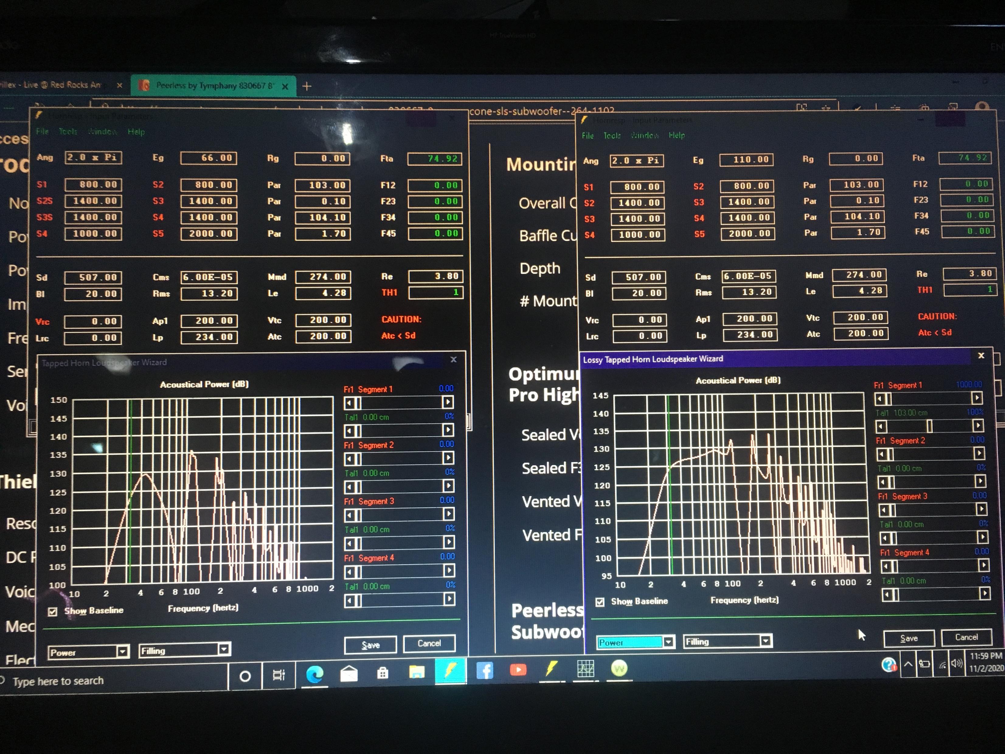

I have a final sim ready after much tomfoolery and searching for the greatest impact to ‘change’ in 30 seconds or less:
With polyfill (right). and without(left) (both at Xmax) note the Eg!!??? Input power..

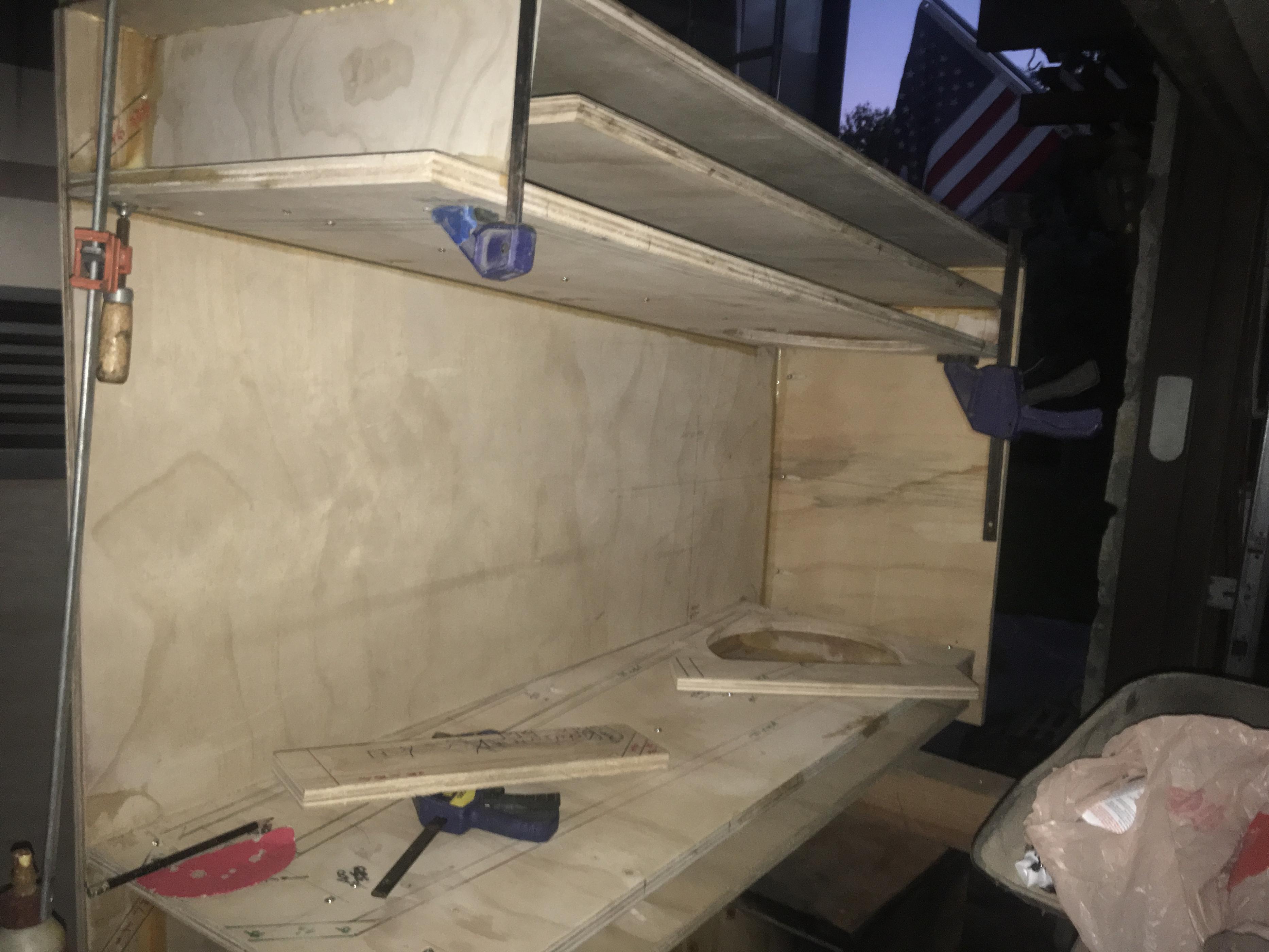

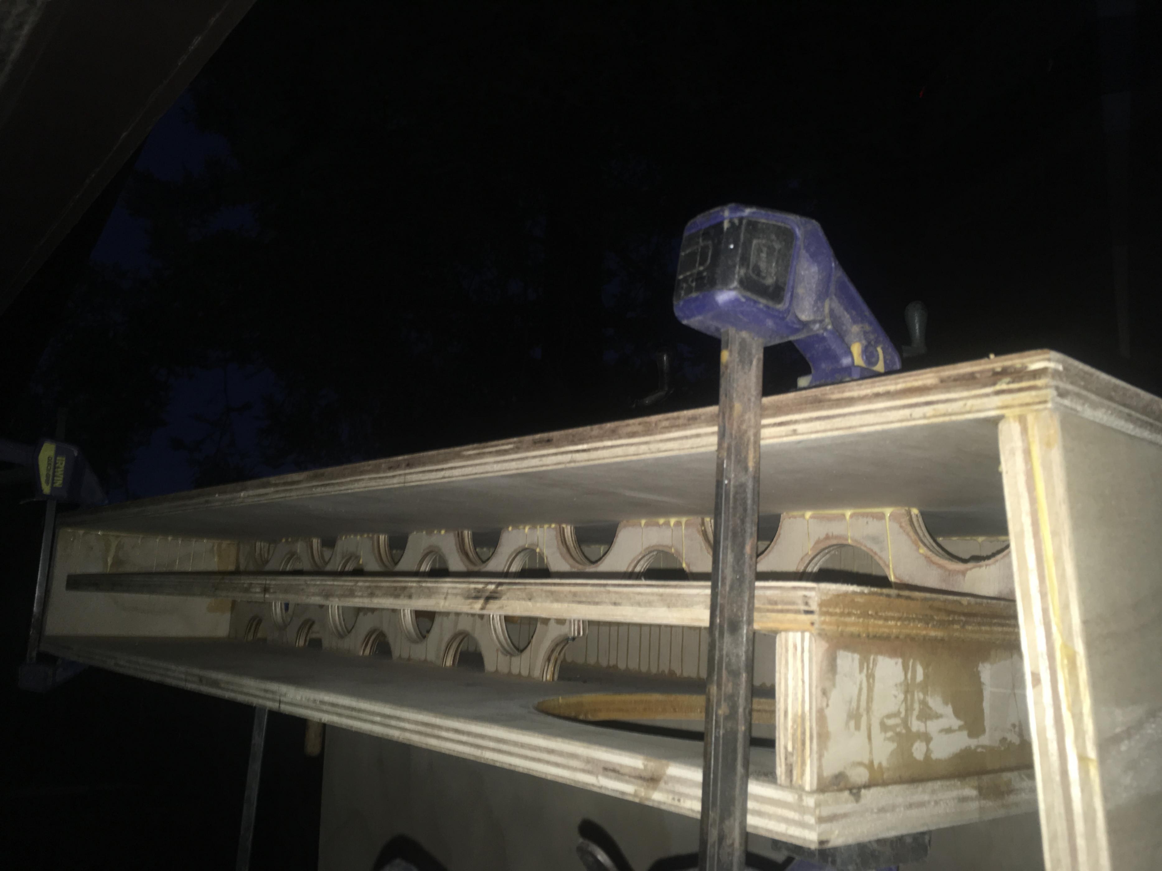

Slice this in half and do one of each 😱
I don’t even bother with L23... it’s just a PITA to adjust it finagle .... hope it doesn’t bite me in the butttt..
