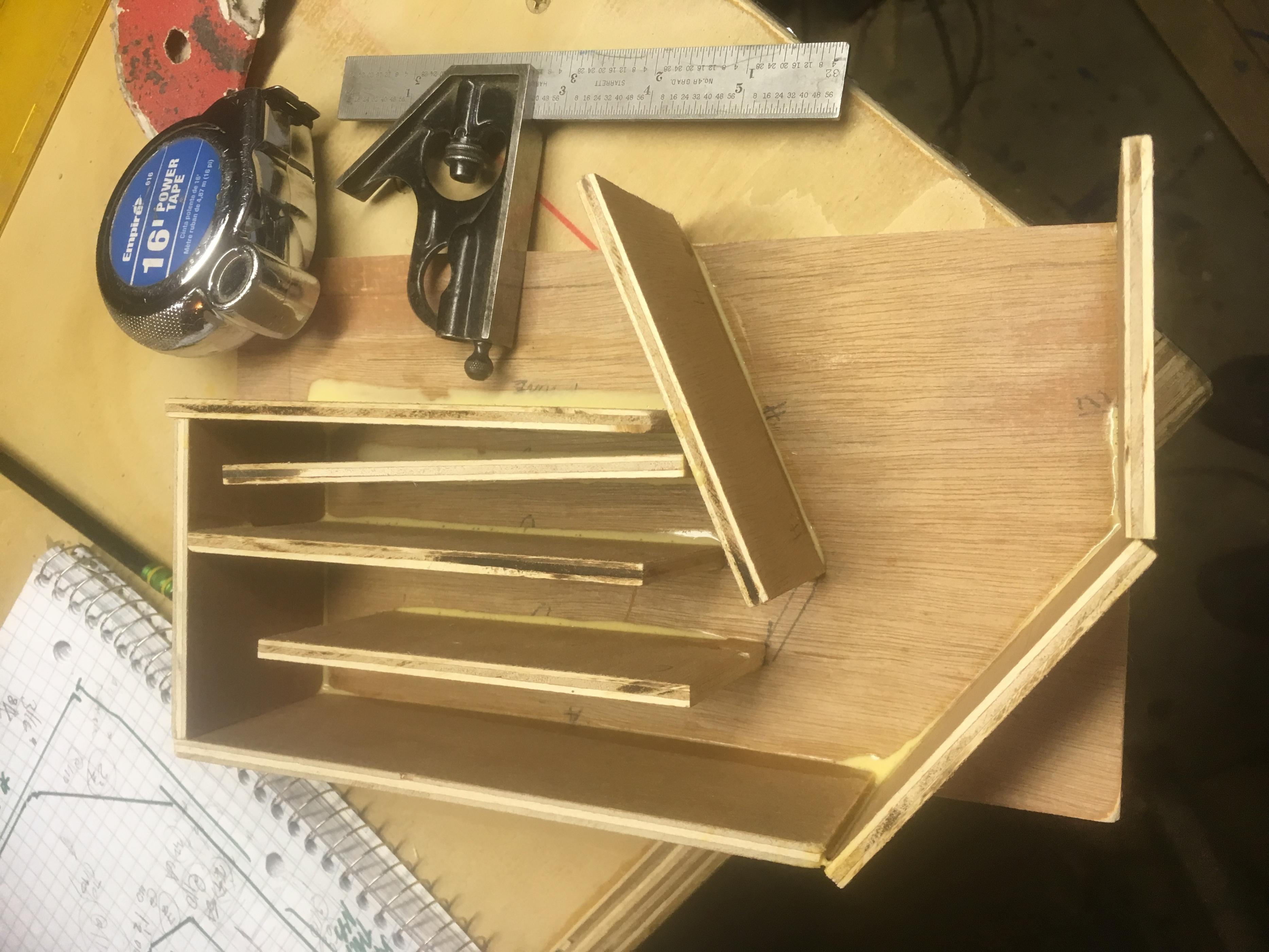

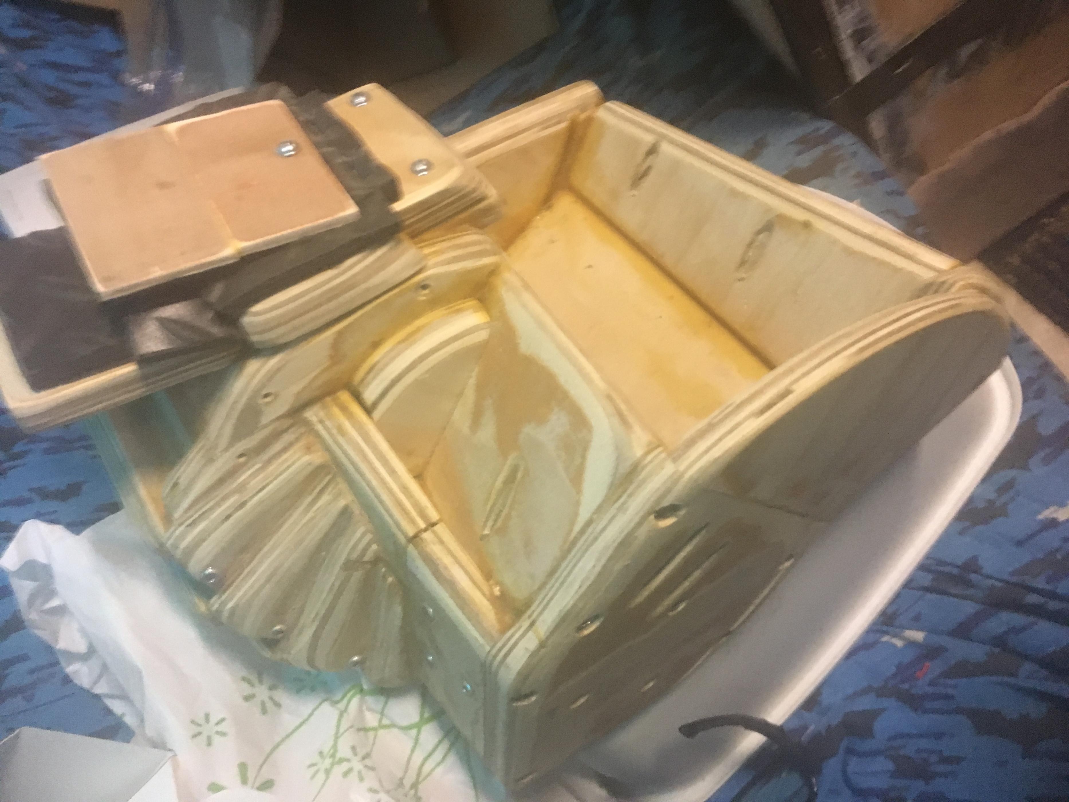

If you were choosing a sub woofer, out of these 3 layouts which might you prefer and why? I realize it’s probably a bit vague, sorry, but just assume the CSAs are similar and the camber or offset chamber and actual main qw paths are similar in size with only the direction (or reflection) being different.

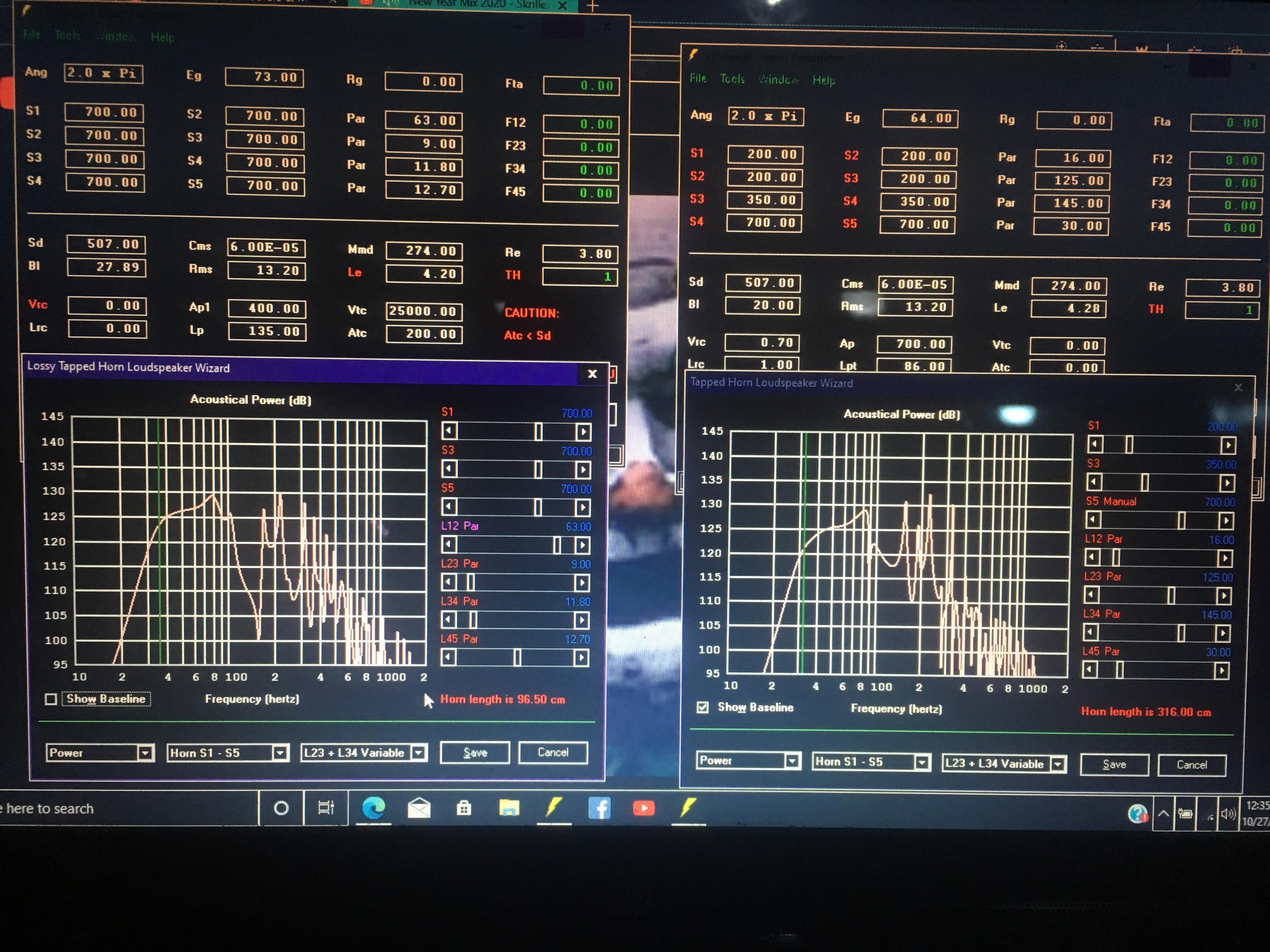

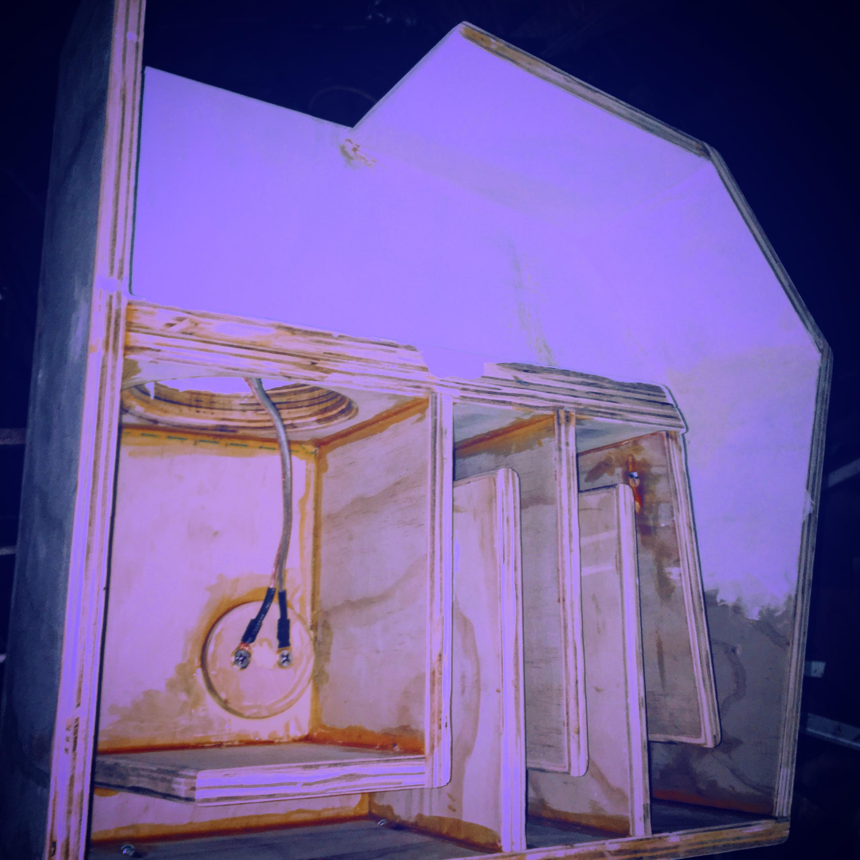

If I try to go bigger in the expanding path section or I extend the actual exit(series), things get goofy really quick.
I then split into a ‘roar’ type layout and shrink the chamber more and more eventually leaving a long thin chamber, large expanding series exit and a plain TL in between the Tapped driver entries? as if it’s a TL and an acoustic amplifier(and skinny stub filter with polyfill if needed)?!
Ive made a few of those for fun with my ‘phone playing Spotify in the garage . . Maybe ROAR is essentially a TL in an amplifier... but if you exploit the last section of it with a flare rate.... it works for me? I think? Go big!!!? And it works out to the same response, just more if it. and the electrical needs change to maintain the same Xmax for excursion...

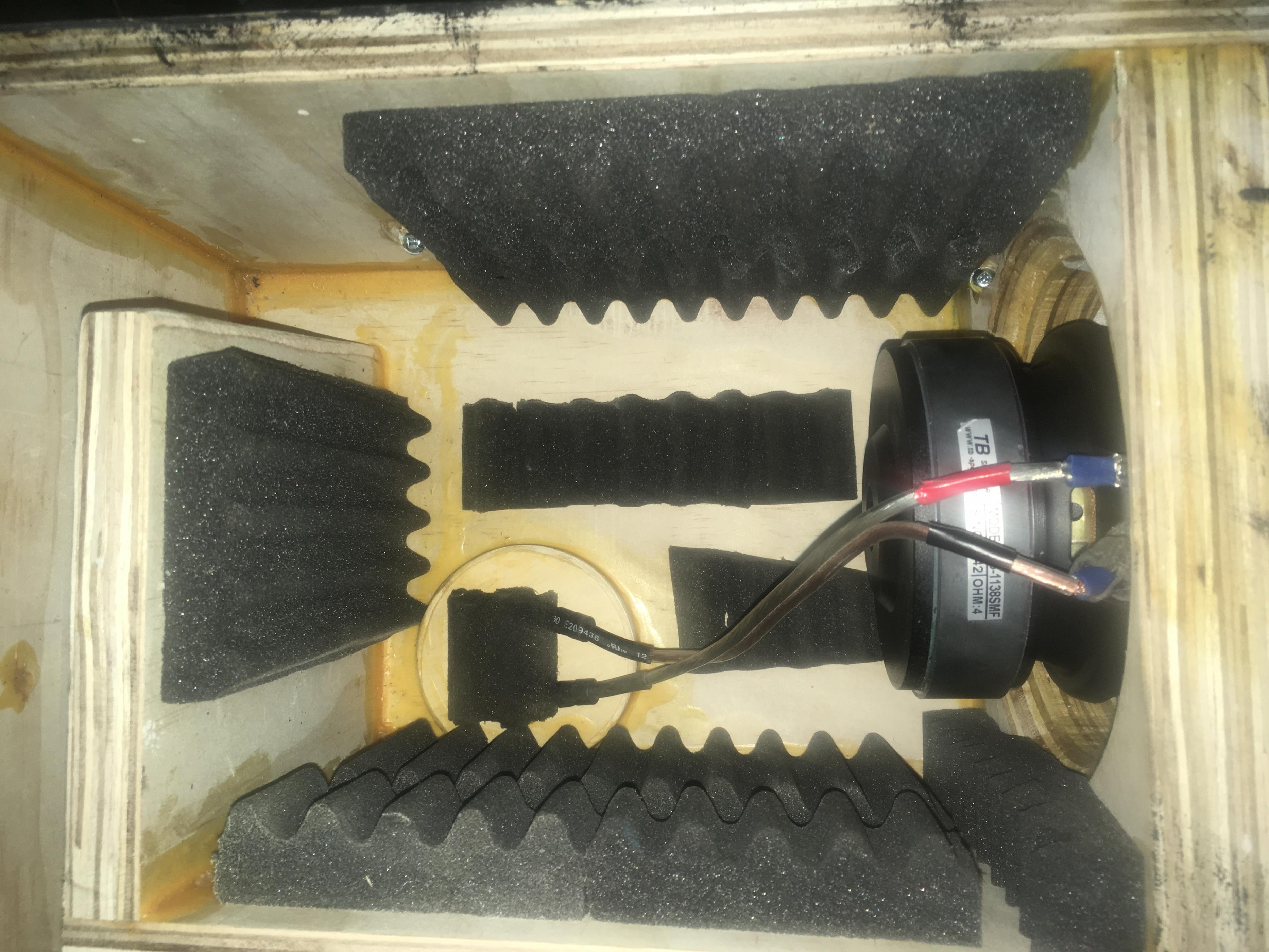

Tangband w5? Similar idea as POC. too much too fast... just a transflex/tapped pipe here I think... failed to ignite the idea ‘perfectly’... still a noisy little sub...

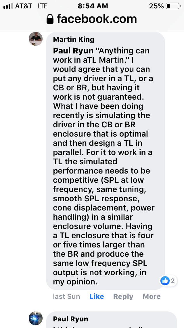

That reflected sound ??? What has happened?
I can’t tell And I apologize for the confusing post.
But put an end loaded TL in parallel with the same heimholtz? what do you get? A man much smarter than me pointed this out I think....
Absolutely no tapped entries allowed! Lol??
I dunno , but my mentor has become confusing these days...I dunno what happened... maybe I should just build TLs.?
We can agree, what he describes is going to work quite well, but if I stick a taped driver in there?? Then what? Magic or taboo?
??? Tapped or not is same-same WRT to my answer.

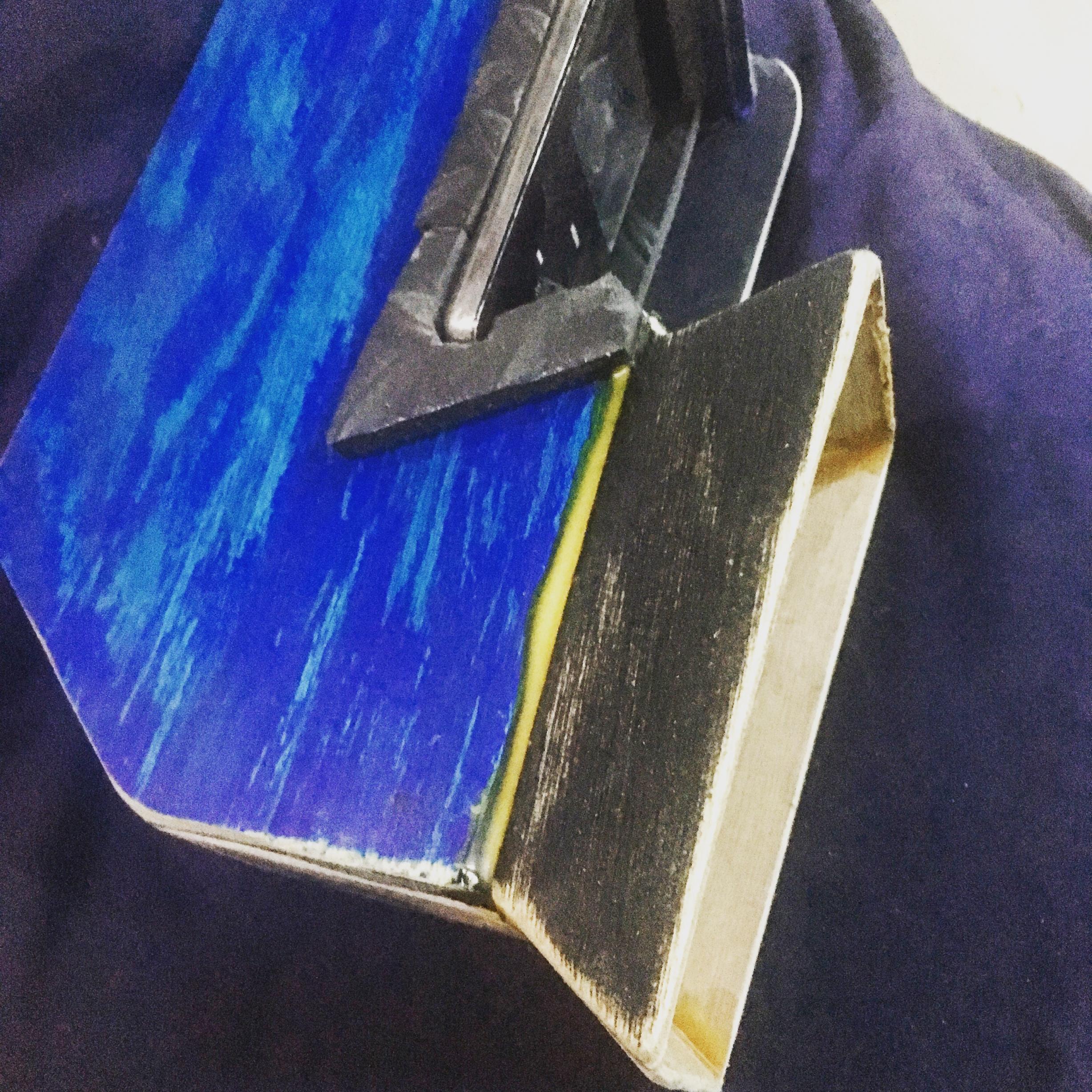

Off set exit to a large TL shape are more than people might realize? Especially, maybe, if used as a specific mass loading sized on a very large box otherwise! I could elaborate but I’m
Hoping there’s more ways to sim it then say it soon?!!! mass loading is one option, there a zillion others too!!.
