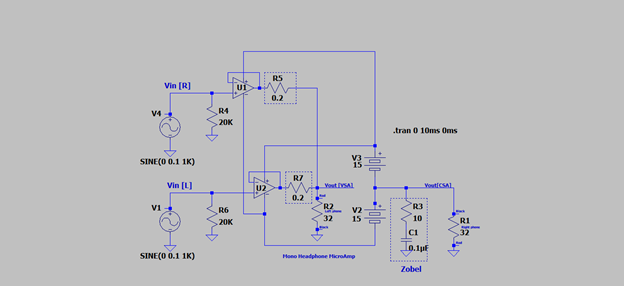

The application understudy is a test method for PSRR. The attached schematic shows:
1. LM308 [U2] is the application understudy. It generate two out of phase output signals; namely Vout [VSA] and Vout [CSA].
2. The signal Vout [CSA] is a "disturbance" on both rails of +/-15 V PSU. It has magnitude and phase.
3. This disturbance causes a change in [U2's] Vout [VSA]; per the definition of PSRR; but I can't measure it at this location.
4. This same disturbance is seperately imposed on the rails of an independent LM308 [U1]. It is idle. The LTSpice model shows an emerging output voltage [Vout PSRR]. It has amplitude and phase. This method is fully applicable to a dual [or true twin] OpAmp like NE5532.
5. 20 Log {Vout [VSA]} divided by {Vout [PSRR]} is a calculated PSRR at 10 KHz. The resultant value is 60 dB.
6. The two signals in point 5 are in phase; but with a phase shift per LTSPice.
7. But suppose the two signals in point 6 are in-phase. This creates or is an internally-induced positive feedback. A possible cause of oscillation if excessive; but maybe beneficial in its abscence if low or moderate.
NB.
Vout [VSA] and Vout [CSA] are correlated and out of phase. They are a balanced pair of outputs which are suitable to drive bridge amps.
Best
Anton
