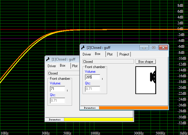

What are the effects of using two drivers with differing T/S parameters in the same sealed sub-woofer enclosure?
(Qts: .40, .56; Vas: 149 l, 157 l; Fs: 16, 21)

Imagine the spring is the air-volume i a speaker-box, When both drivers are with different TS parameters fighting against the same air spring a beating effect occurs...The 'weaker' driver will suffer most.

Its not a coupled oscillator due to the intrinsic damping if connected in parallel.
More details are really needed to ascertain if dividing the box evenly will help.

The DDDL principle certainly works but uses drivers with wildly different
parameters. In this case without knowing driver sensitivities and Xmax
its not easy to say, but I imagine they won't be fine in the same box.
All depends on what they are and what your trying to do with them.
rgds, sreten.
