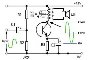

I can understand current reversal in a balanced push-pull amplifier, but what causes current reversal in a Class A single-ended amplifier?
I guess what I'm asking (another stupid question!) is .... where is the mechanism creating the crossing axis? (I hope that's an acceptable way to say it.)

The common (ground) terminal in a conventional single ended capacitor coupled stage acts as 0VAC. Consideration of its relative Voltage becomes irrelevant as the DC component is blocked by the capacitor.
I can understand current reversal in a balanced push-pull amplifier, but what causes current reversal in a Class A single-ended amplifier? .... where is the mechanism creating the crossing axis?
If you look at the attachment, the voltage at the collector of the transistor (equivalent to the anode of a valve) varies in amplitude between 0V and +24V with a 'crossing point' of +12V.
The output transformer blocks the DC components of this voltage and passes only its sinusoidal variation, i.e. the amplified AC signal, on to the loudspeaker.

I'm learning so much that if I don't watch out, pretty soon I'll actually know something!
And your explanation is, as always, both clear and greatly appreciated. jj
