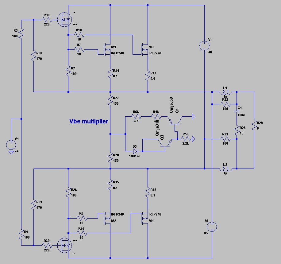

Hi All
I do not now of the thread is still active but have a question about a temperature correction for a circlotron.
I have put it on a spot between the reference resistors, I did try with a schematic I had get from a friend here who was so kind to draw it for me.
I need a regulation who do not make impedance smaller but higher, so resistance needs to rise instead of drop what normal vbe does.
someone an idea to get it better, this one do work quite fine but has a little overcompensation, what can I do to make thet smaller, a resistor in the sense transistor? a mosfet did not work wel, it has to low compensation, possible because I did include the drivers also in this idea.
I can use the Sziklai complementary pair as an idea because of the very low impedance however I need a regulator who do let impedance get up to lower the idle current, I have to invert it before use, and I need to adjust the servo so it does not overcompensate.
some tests here. YouTube
You see some difference in current but this is because of resistors not so precise in the test build, not of importance further.
thans in advance.

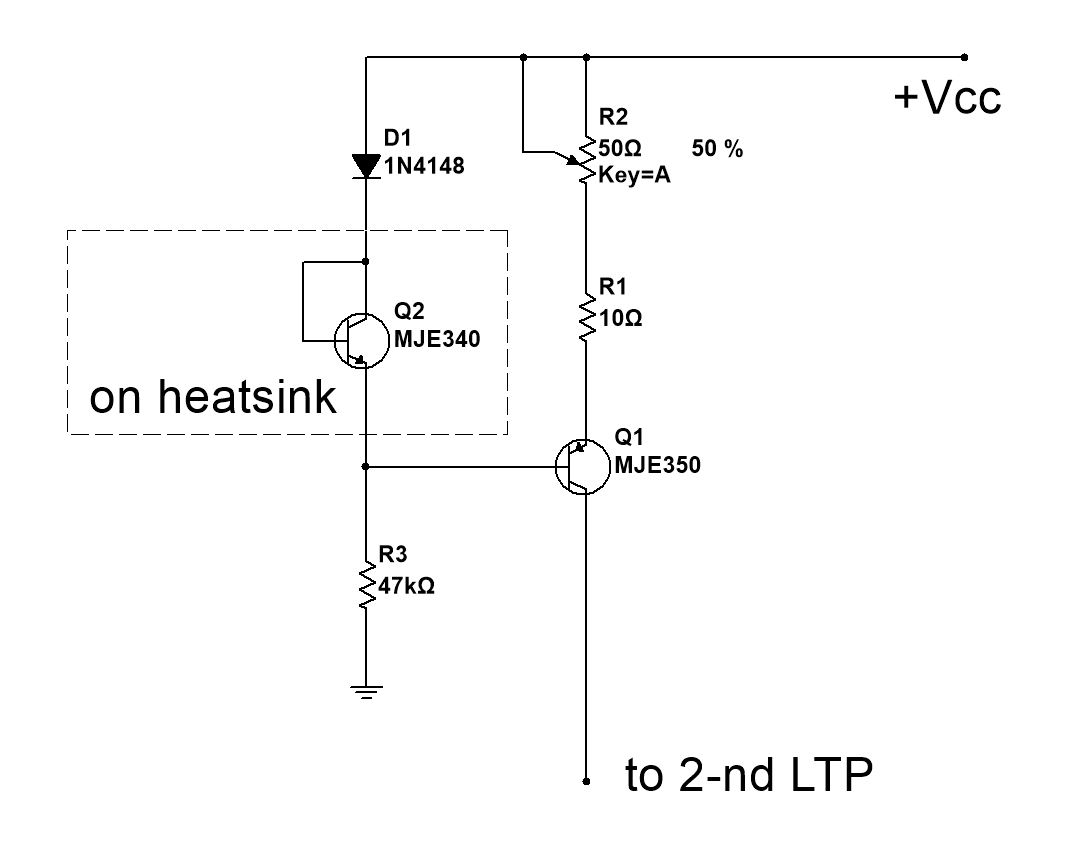

The Vbe multiplier needs to track well the output transistors temperature.
Over adjusting will cause crossover distortion and too little adjusting can start to cook output transistors.

Hi Nigelwright.
I have no peavey but it is a home sound system, I do not the old days as discjocky well, I was one, and had a self build amp with the first toshiba laterals in it, and get hot, but it has work for years, and current settings was just 100 ma echt fet.
here we have verticals, and the circlotron has it,s multiplier moved from the preamp vas to the ground reference resistors where it work very good but I have overcompensation, it may some lower, and the point where the multiplier is, is very low impedance, still it works wel, and therefore I did has the question about the szliklai pair who is quit good suited for low impedance points, however, I need a positieve tracking, impedance needs to rize when temp go up, making the driver get into lower current and with them also the power fets, I like the idea, and it do work, now finetuning.
I have the tracking transistor a mje 340 underneath the power fet, I can try to set in between and then it will get less compensation. it's quite save I admit, but need high quality audio, so I need a very good multiplier.

The Vbe multiplier not only needs to track the OP transistor temperature but also provide exact compensation. The CFP seems to work best with MJL3281A OP transistors. The circuit was first mentioned in this forum in "class B high feedback" thread from 2006, posts around 350 on.
I expanded on the principle in post #6 in response to Carlos's"Help me to improve our prehistoric Vbe multiplier biasing system" thread in 2015.
It is not a perfect system even then: the junction temperatures of the transistors will run hotter than the heatsink, so a degree of overcompensation may be required depending on the thermal resistances.
These can be calculated, of course, but at the end of the day I have found the circuit of post #6 mentioned to give a stable current with all transistors (drivers+OP+bias) all on the same H/S with either (discrete) pairs or triplets (which need a factor of 6x Vbe).

It can be calculated but even then there is no sureness it will work fine, I have in schematic also a vbe who has 40 mA through it because of the place it is in to and it needed inverted because I need a positive action, I did now change the current through the sensing resistor, and now it go after a whil go into runout, so that is not very good, with 2,2 mA through the mje 340 transistor, but can I use the CFP (because of its low impedance) to track positively or negatively? also, the heatsink itself is a uge factor who is difficult to calculate, and I am not a math boy.
regards

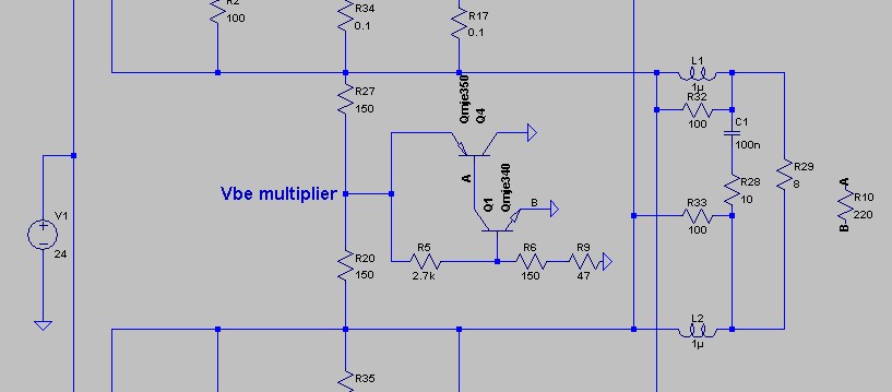

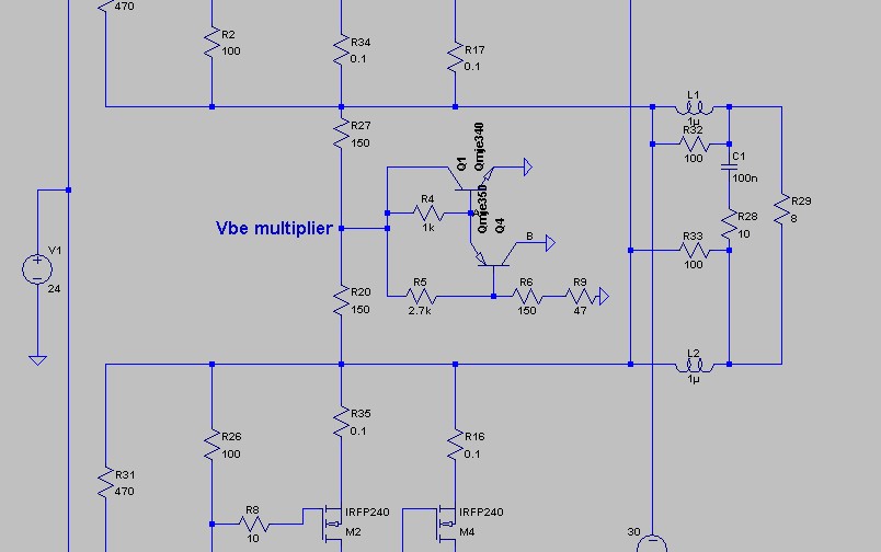

Here some test sim with CFP do not work, it helps the runout because it is on this amp the other way around, I need higher inside resistance from the Vbe, this do not, trying both npn pnp and vica versa did also not work.
A extra transistor on the base of first transistor maybe? ideas how to get a low impedance multiplier.
And the version I have do jump up and down some 20 mA if it is settled, so looks unstable.
Last picture I have use a temp sensor and the CFP, but seems to get uge compensation, to much but not tested in real live.
regards.

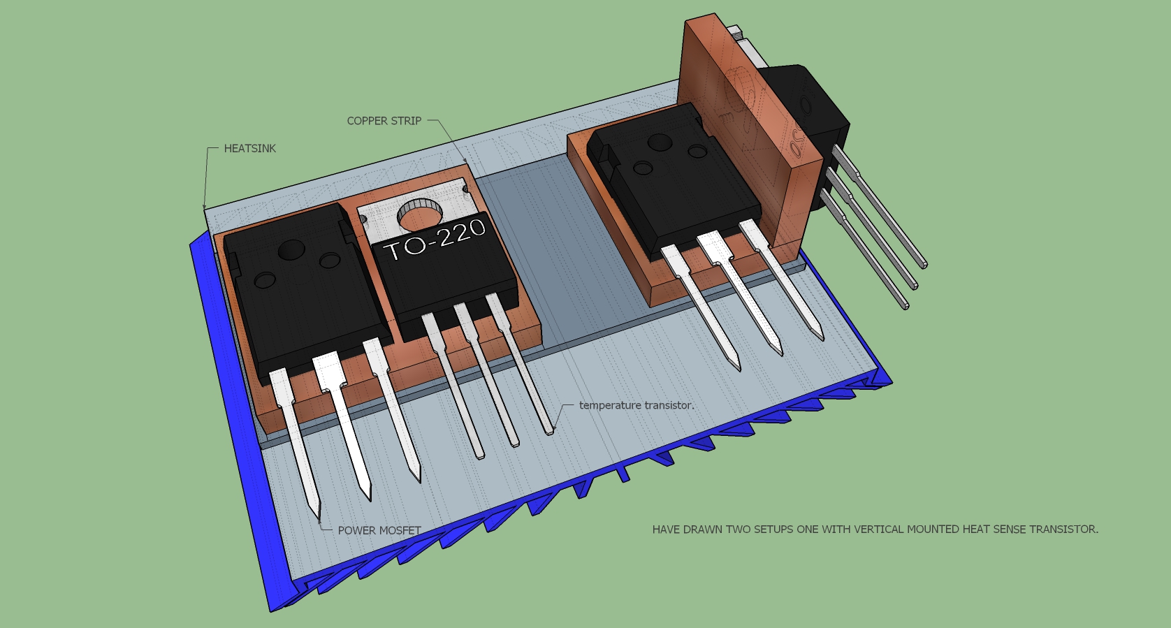

After putting the sense transistor on the top of the irfp240 I get quite stable respons, even until the heatsink is very hot using a cloth on top, (almost burn vingers) staying between 390 and 430 mA.
Butt after a longer time, it does go up to 520 mA, but that needs longer time, so it is now a little undercompensated I gess, need th change the current through the sense transistor.
Quite difficult stuff, but I have a solution I thing what will work, making a copper piece put sense transistor on it and the copper piece between the irfp240 and the isolator and then on the heatsink will give a tight temp sense, copper do fine here.
Now again 10 minutes later, it stays around 510 mA, and the heatsink is not that warm, the verticals also need a higher idle current because she like it hot. I put it to 250 mA each, that will work fine.

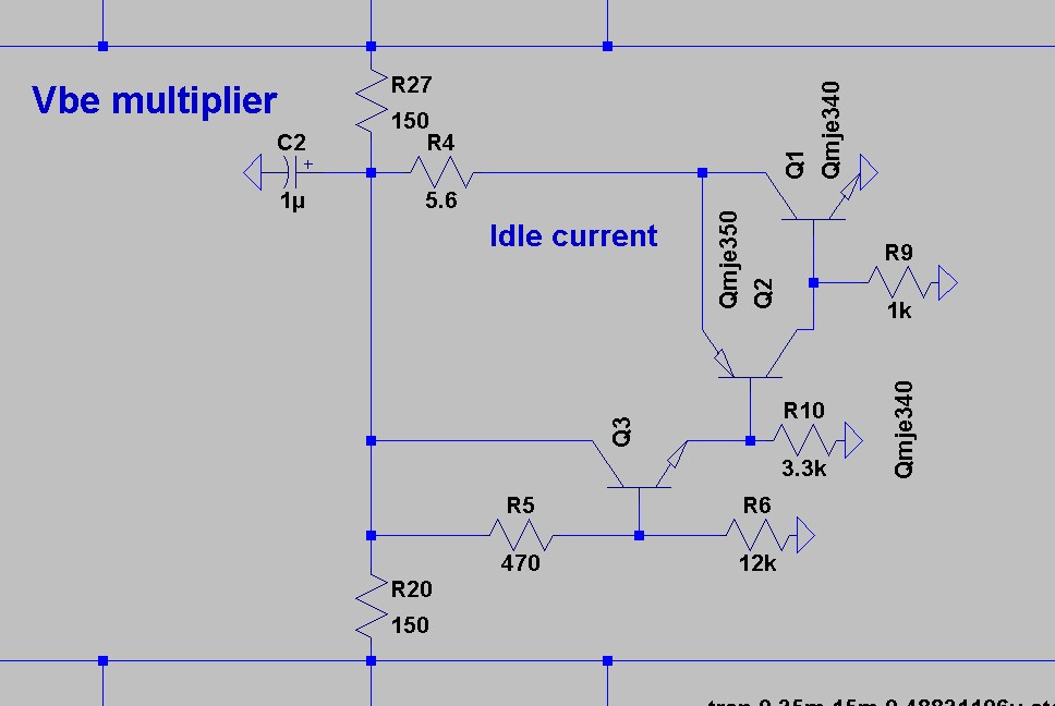

mine problem is I need a inverted action of the vbe multiplier, when most need negative I need positive, so resistance needs to go up here in stead of going down like between the basis of the driver transistors, I have a diferend amp, a circlotron.
as I now see, after adjust the sense transistor idle current, with 1.2 Kohm it does track quite good, when I do let it heat very much, then it overcompensates a little dropping it 150 mA, but only when it is so hot I can not toch it.
I do not now if i can use a mosfet, I have now a mje 340 diode connected, and a buffer inverter mje 350 who however is als temp sensitive but just in the other direction, so these do when both on cancel the regulation therefore the buffer has a heatsink, it draw 40 mA there because it is in the ground reference resistors.. AC do cancel out there and is not a problem.
have some drawn for how to get a good tracking, using on top do work but after it gets to hot runaway do occur. @eva is right here, it does work, but is dangerous for professional stuff.

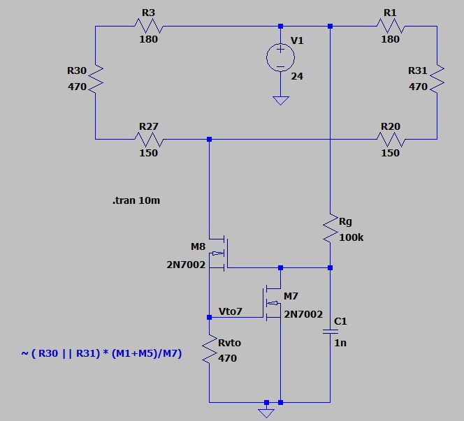

  • circlotron-vertical-test.asc

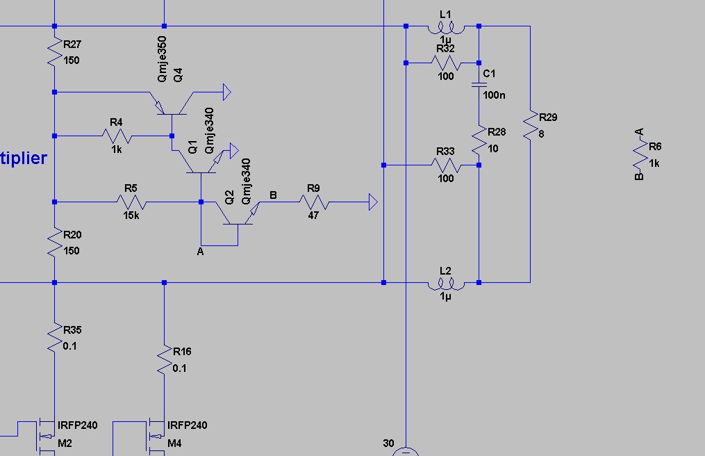

Wel I have now use a CFP , it does invert also and I think when I put Q1 and Q 2 together so it has thermical connection I get rid of the drift.
Now we need to replace the sense transistor for a fet, but do not now ith that is possible because of gate source voltages, using voltage from the LPT supply
is possible to get it working through a resistance devider, or maybe more easy adjust the temco of the transistor because this do work also. Putting a mosfet as diode is maybe less accurate.
And thanks all for the tips, making a good multiplier who do regulate precise is quite difficult.

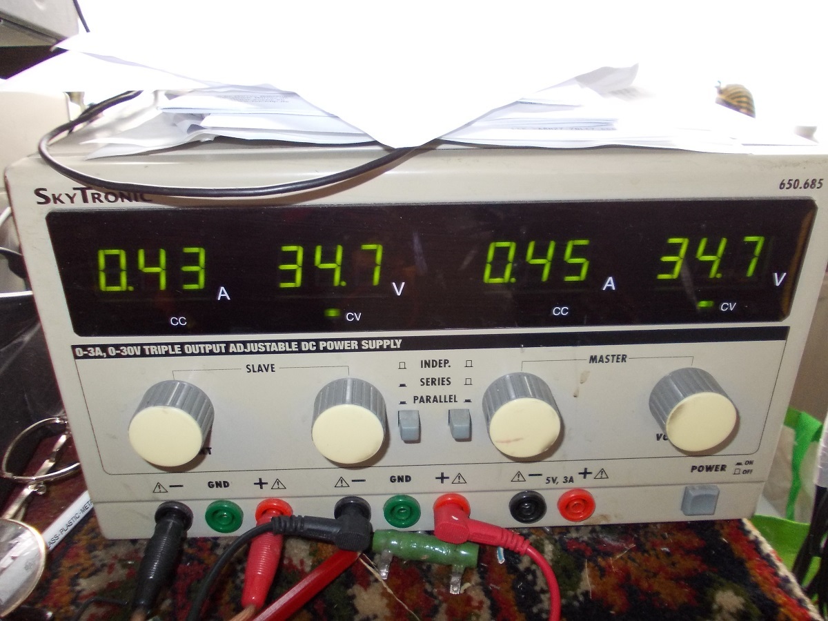

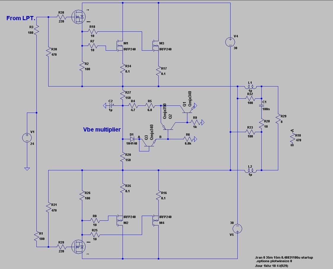

I have play some more, the circuit is in the pic, it keeps quite stable but I do now now for shure how to adjust the temco, I can do it by current to temp transistor however these do have variation when adjusting.
as I did in schematic it is stable within 50 ma and after passing the 70 degree it drops 100 ma after some 5 minutes it do go back to adjustment point.
Sometimes I see a suddenly drop, but this was with all cases so maybe bad chinees mosfets? or damaged ones.
Do watch out because mine multiplier do work inverted, as I do need higer voltage for less current where in normal amps it is lowering voltage for less current and I have more current through the multiplier, 60 ma.
But I have now a different version as first, these is more stable as I did test.
