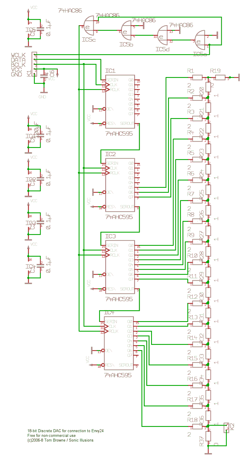

I am doing some very basic experiments with a 24 bit Ladder DAC, lots of resistors and a few shift registers. Very similar to the Sonic Solutions DAC, see the attached circuit. Mines not quite the same but very similar. My diagram is just a pencil sketch so far !
Early tests show it works but with a lot of noise, I have a long way to go yet ! Still, having a bit of fun !!
If I feed the DAC with 16 bit Data from a true i2S source (Philips CD Player pre the Filter or a SD Card Player I bought) the DAC seems to work and the MSB is where I would expect the MSB to be etc etc.

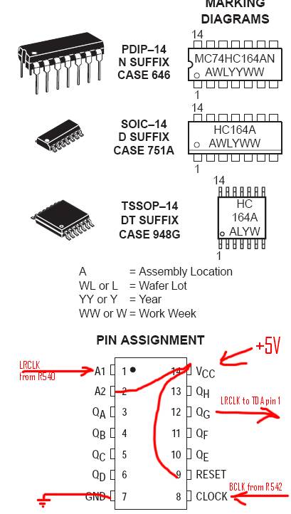

However, if I feed the DAC with 'converted EIAJ i2s' (see the circuit attached borrowed from Lampizator) the DAC sees the 16 bits but places them from the LSB 'upwards', if you see what I mean. So the MSB of the Data appears 8 bits 'down' from the DAC's MSB.
If I feed the 'converted i2S' into a TDA1541 (Pin 27 to +5V) it decodes it fine, but then it would, it's a 16 bit DAC chip.
I am obviously missing something in the differences between EIAJ and i2S.

'converted EIAJ i2s' - What in tarnations does this mangled abomination mean ?
Using the circuit from the Lampizator site, one is able to feed the EIAJ from, for example, a SONY CDP-227ES DSP IC, CXD1125 to a TDA1541A set for Two's Complement Input.
If the two are connected directly the TDA1541A will produce no O/P so some 'conversion' has to take place.

NONE OF THIS STUFF REQUIRES BRAINS. It has been standardized for over three decades. Lego Mindstorms are more complicated. The electronics on my bicycle is more complicated. It simply requires following the basics. All you need to know is where you are and where you want to be.
There are three main serial formats.
I2S fixes the MSB position to one clock cycle after a transistion of wordclock.
MSB/Left justified data fixes the MSB to a position immediately after a transistion
of wordclock.
LSB/Right justified data fixes the LSB to the last position before a transistion of
wordclock.
With I2S and MSB/Left justified data the MSB is fixed and the LSB moves with
wordlength.
With the LSB/Right justified data the LSB is fixed and the MSB moves with
wordlength.
The I2S shown here crosses channels. LRCLK is usually drawn with Left channel first.

the resistance of switches is your limit for the real accuracy, if you use 7k5 and 15k resistors (2x15k parallel for 7k5), then you will need the resistor accuracy up to 0.00125% for 16 bits and its guaranteed monotonicity of output ...
16 bits is 15000R +- 0.19R ... 15 bits is +- 0.37R ... 13 bits is +- 1.5R ... and 12 bits is +-3R ...
on state resistance in these AHC595 switches is about 15R? +-1R? or even worse?
forget 24 bits (neither discrete R2R achieves this accuracy)
another huge problem will be glitch
0.1% accuracy is enough only for 10-bit DAC, you have to measure them more accurately (consider a low PPM, like 25ppm) ... 100k resistors sort in tolerance +-1.25ohm (0.00125%) ... you will need an accurate multimeter (6.5 digit)
try a simple RC deglitcher, although it is not enough ... track and hold opamp seems be fine, but it needs additional control logic and an analog switch...
