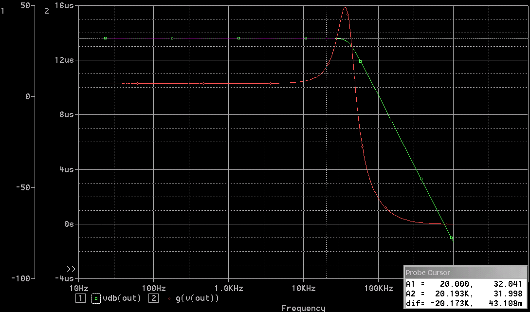

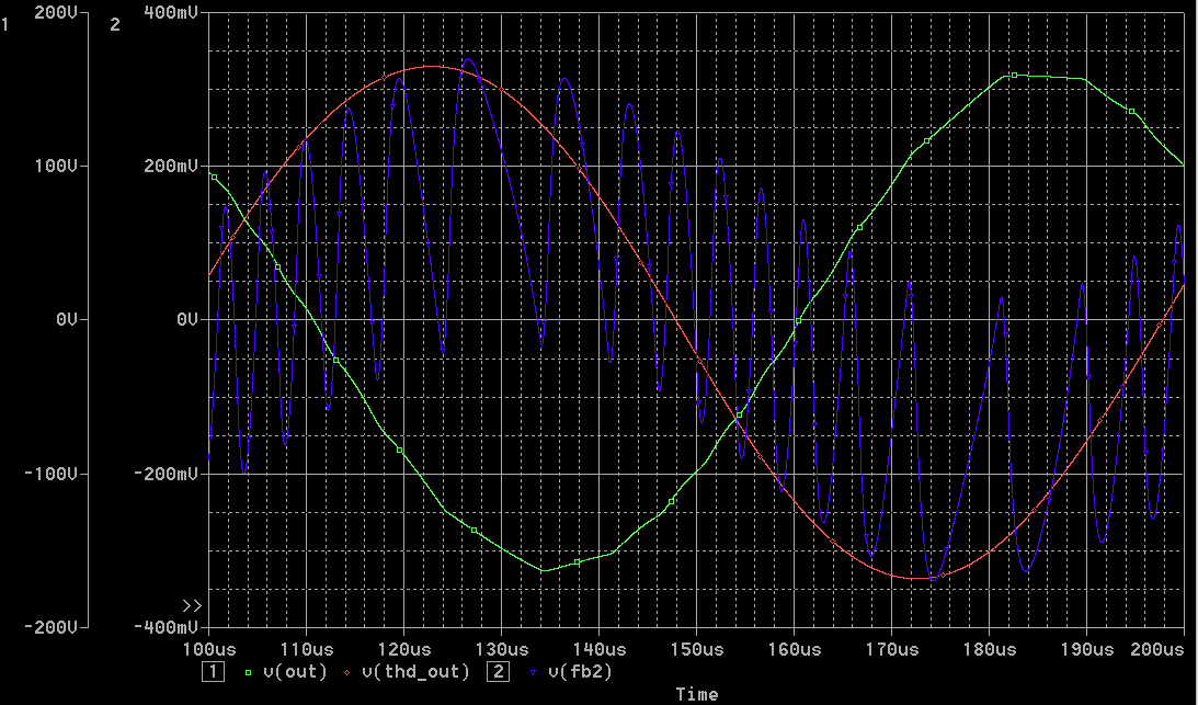

These simulations illustrate my approach to class D. It's a full range amplifier which self oscillates at 240khz with no signal.
First picture:
Green trace is output voltage with 4 ohm slightly inductive load (simulating a high frequency voice coil) at 1dB below clipping. Note how well one cycle of 4khz sine wave is shaped with just 40 switching events, and most of them happen when output current is low, only a few happen with high current. THD is below 0.1%, and it becomes much lower at -2dB and again much lower below -3dB. It also becomes lower with a purely resistive load or no load at all, semi-inductive load is the worst case.
Red trace is output waveform after going through a 25Khz brickwall filter. There are no traces of ripple, all the hash is way above 25khz.
Blue trace is the input signal to the comparator showing constant "triangle wave" amplitude, regardless of varying switching frequency.
Second picture:
Frequency response (and group delay), it's ruler flat to 20khz (less than 0.1dB deviation, -3dB at 40khz), regardless of load impedance, and regardless of the low switching frequencies involved (40 switching events at 4khz gives 160khz effective, in other words, a very efficient amplifier).

You know that I appreciate your work.🙂
ok, now I can see the same simulation with input at 10Khz and 20KHz? (First pic).
see what is the phase shift😀
Additionally, no dissipative RC snubber is required at the output for stability, and thus, trebble output is not limited by resistor power dissipation.
RC snubber at output of clocked designs isn't needed always..........!!!!!!😉

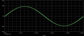

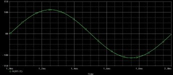

Single phase Vs Four Phase interleaved Class-D
As i am currently developing a project for interleaved 4 phase modulator for class-D.....have a look at some simulation result of output.
Sinewave =1k & SWFQ=250khz, the resultant carrier ripple in 4-phase is 250k X 4= 1MHZ which is easy to filter using small inductors.

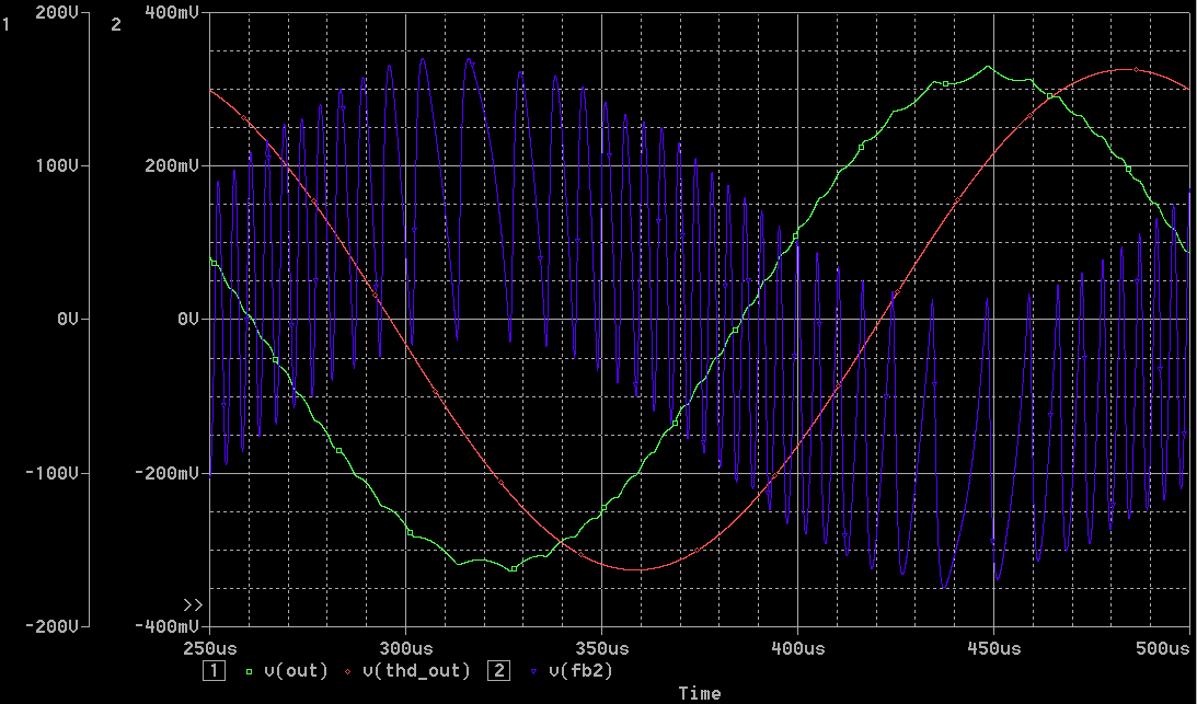

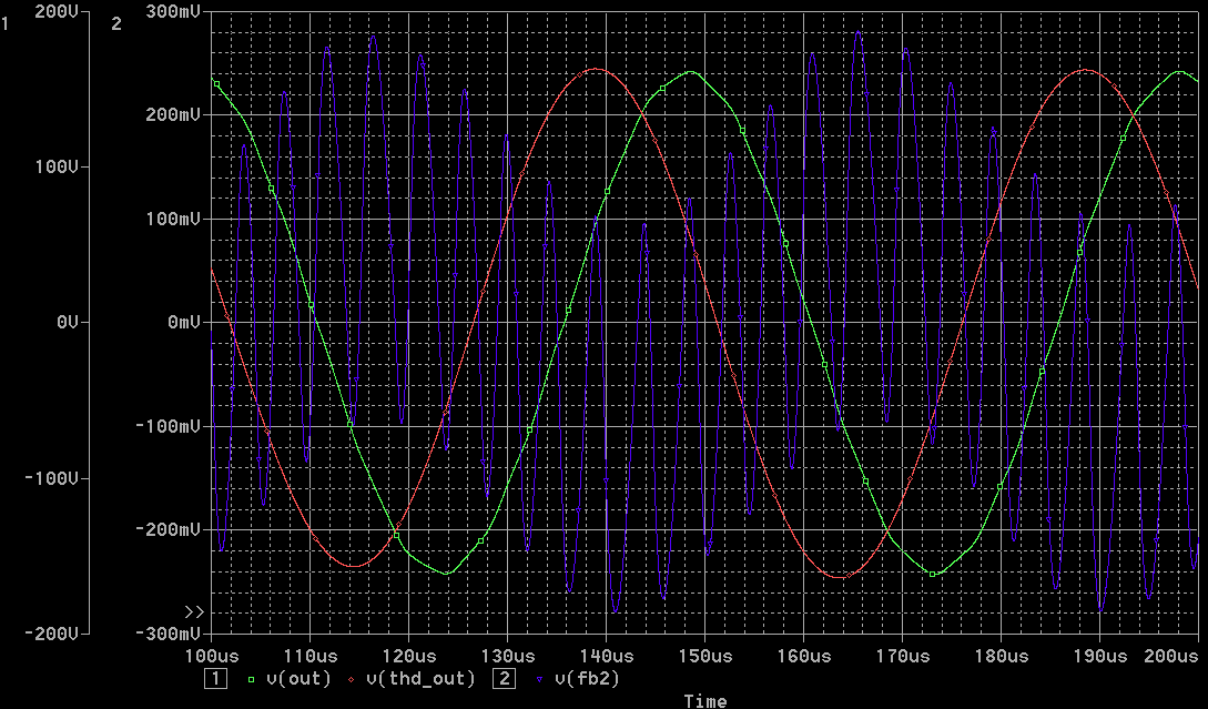

These simulations correspond to 10khz and 20khz output 1dB below clipping, load is 4 ohm in series with 33uH (at 20khz load impedance is 8 ohm, this is my high frequency voice coil modelling). Output filter resonates at 20khz.
Note that at 20khz there is much less oscillating frequency drop than expected, it's not going below 200khz. Another "undocumented feature" of self oscillation is being taken advantage of. Since output filter resonates at 20khz and it's sized for not reaching damped operation until load goes below 2.5 ohm, there is additional gain around 20khz, approx 5dB with 33uH in series with 4 ohm load. The extra gain results in much less duty cycle swing required to reach full output (and higher open loop gain), and thus, much less oscillation frequency drop. 11 switching events are required for one cycle of 20khz sine wave. If high frequency load impedance is increased to 8 or 16 ohms (typical values), things improve further (extra points per cycle down to 10khz).
Also, note the absence of hash on the 25khz brickwall-filtered output waveform (red trace), which is not in phase with amplifier output due to the high group delay of the filter (8th order).
To workhorse: Are so many switching events really required?

Red trace is an output from brick-wall filter, as I understand, which produces a lot of phase delay (frequency dependent), and phase delay is although not so important for THD analysis...
The printing "window" is synchronized with input waveform, not with output waveforms. At 4khz printing is delayed 250us (one cycle) and at 10khz and 20khz 100us (one and two cycles) to hide circuit startup behaviour. Amplifier output lags approx 10us with respect to input, and then, the brickwall filtered reference output lags another few dozen us. That's why the waveforms are not "in phase" with the simulation window.
Depends on how you perceive the output to look like🙂
The clarity of reconstruction of sinewave tells how many switching events one can rely on to get an excellent result.😉
