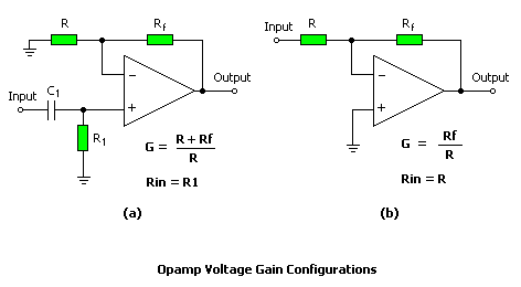

Just another question. I see it is much more common to find inverting amplifiers than non inverting. Why is that ?
Non inverting have higher input impedance (and it does not vary).
In the case of a non inverting simple amp, how can I determine the best value for the feedback resistor. I am confused because the current there should be zero or negligible.
Hmmm... I would have said non inverting were more common. Your Denon buffer is non inverting and will be when the extra parts are added.
Inverting configuration though is thought by some (me included) to offer better performance. See post #2 here,
http://www.diyaudio.com/forums/soli...fet-amplifier-designed-music.html#post1452488
There are only two resistors used per opamp. In the above example that's R1 and R2 for the first stage and R3 and R4 for the second.
Gain is just -R2/R1 (minus denotes inverting) and -R4/R3. The 22pf caps were added to optimise square wave response (not needed for stability).
R1 sets the input impedance of the first stage and R3 the input impedance of the second. That's a figure you have to decide but 18 k is sensible value for modern source equipment. Tha gain required is then set by choosing suitable feedback resistor.
So if R1 were 1k and R2 100K the voltage gain would be 100 (very high) and the input impedance low at 1k. Easy 🙂
Non inverting... the input impedance is set by the value of "resistance" from the non inverting input to ground. So if you had a 10k to ground from the non inverting input that would set the input impedance. That assumes the input is AC coupled.
The two resistors in the feedback network, call them RF and R2... RF goes from opamp output to the inverting input and R2 from inverting input to ground via that electrolytic cap 🙂
If you use a bjt or bipolar input type opamp like the NE5532 then it's good practice to keep RF and the input resistor the same to ensure equal DC bias currents flow into each input. Not doing so can cause large DC offsets at the opamp output.
Use a FET opamp and that problem is totally eliminated.
The gain of the non inverting amp is (RF+R2)/R2 so for a gain of 10 you would need a 9k feedback resistor and a 1k for R2. The electrolytic cap ensures that the gain falls to 1 at DC.

In the following pic, what do you mean by input resistor in the non inverting layout ?

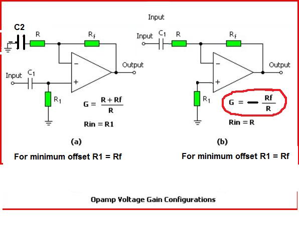

Look at this. I've added a cap to the non inverting amps feedback network (normal practice) and it makes this easier to understand.
This is how it works...
Bjt opamps have a small DC current that flows into or out of the two inputs all the time. It's tiny but not negligable and if you look on a data sheet it's called the "input bias current". The 5532 is quoted as 200 to 800 nano amps.
Seems to small to bother about ? What happens is this. That tiny curent develops a voltage across the resistors connected to the opamp inputs. Look at R1 in your first diagram. Suppose that were 470K. 800na develops 0.376 volts across that. Not so insignificant now. That DC voltage appears as an "input" to the opamp and is now the cause of a DC offset voltage that appears at the output.
The same issue appears at the other opamp input. Whatever resistance is connected there also develops a volt drop that is seen by that terminal as an "input" voltage.
So we go back to basic opamp theory that says that the opamp output will do whatever is required to keep the voltage difference between the two inputs at zero. And what we have to do is keep our "input offset" voltages equal. We do that by ensuring that each input sees the same resistance, and that means that the voltage developed is equal too at each input thus minimising the error.
So your first non inverting example.
By AC coupling the feedback return we only have to keep R1 and RF the same. If the network wasn't AC coupled then we would have to figure the combined effect of RF and R.
In the inverting example we add a resistor in series with the non inverting input as shown. The value is equal to RF. That develops a volt drop as we have shown that equals the error at the inverting input.
The downside to that is that the resistor add noise (that is negligable) but more importantly it makes the input pin sensitive to stray pickup so carefull layout is essential. Or the resistor can be bypassed with a cap to effectively "ground" the pin at AC.
If we use a FET opamp all these problems dissapear because the FET opamp has essentially zero DC bias current. No current = no volt drop acrosss input resistanaces.
