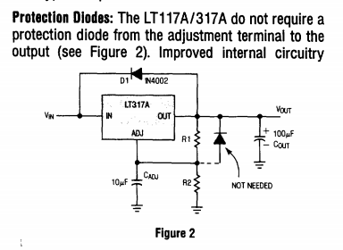

Difference between LT317 and LM317?
Hope this helps.
there are some small differences between the linear tech version and the generic "national semi" version.
LT version have tighter tolerance and don't need all the external protection diodes the non-LT versions need to prevent damage from cap discharge. There's probably some differences in frequency response behavior and noise, but I don't remember.
I'm not sure, but as far as i remember Dimitri mentioned (many year ago on a different forum) that Linear (LT) used better "cleaner" silicon in their V refs than others used in the LM series.
That's why the LT series had lower noise.
I dont know how it is now when LT is a part of ADI, I guess its the same product but different name and pricetag.
