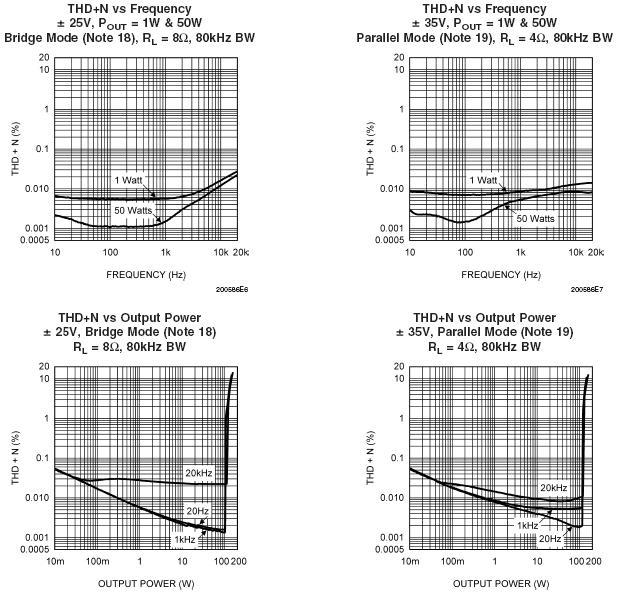

you should find (as I did) that the THD of the bridged amp is about an order of magnitude better than the parallel amp -- but the parallel amp has a much easier time with "tricky" loads.
Why? And for what power output? Btw i have always been a fan of bridge-amp sonics. They seem to solve some tricky issues of grounding the speaker return.
jackinnj said:you should find (as I did) that the THD of the bridged amp is about an order of magnitude better than the parallel amp -- but the parallel amp has a much easier time with "tricky" loads.
Mmmm....
You can see on page 13 of the LM3780 datasheet these graphs.
I don't see such a difference, having in mind that the THD specs for the parallel amp are for 4 ohm loads.
Also, notice the slight better THD in the high frequencies of the parallel amp.
I wonder why myself. It isn't really "an order of magnitude" -- a little bit of hyperbole:
these graphs were done by merely replacing the bridge board with the parallel board -- they fit right onto the heatsink, in the same steel chassis. the wiring to the power supply (using audiophile grade (orange) home depot #14 extension cord.)
Oh well that settles it. National must have done something wrong to measure such low distortion in their parallel amp, because yours doesn't perform nearly as well. 😉these graphs were done by merely replacing the bridge board with the parallel board -- they fit right onto the heatsink, in the same steel chassis.
Seriously though, if you take the care to very carefully match the gain and DC offset of your parallel amps then you can expect great performance. If you don't, then the amps will spend as much or more effort fighting each other as driving the speaker, and you will not get good performance at all. Gain should be matched to 0.1% or better. Even precision 1% resistors are not automatically good enough. They need to be matched by hand.
National probably has the advantage of using a Faraday shielded room to perform their THD +N measurements.
Also -- they were measuring "net" distortion. The lowest distortion I can get on my SG505 is about 0.0007%, which from a statistical viewpoint is the same as 0.001%.
Note also that National's measurements go to 20kHz. Mine go to 100kHz.
The resistors were all matched with an HP3478 5 1/2 digit DVM on the 4-wire method.
