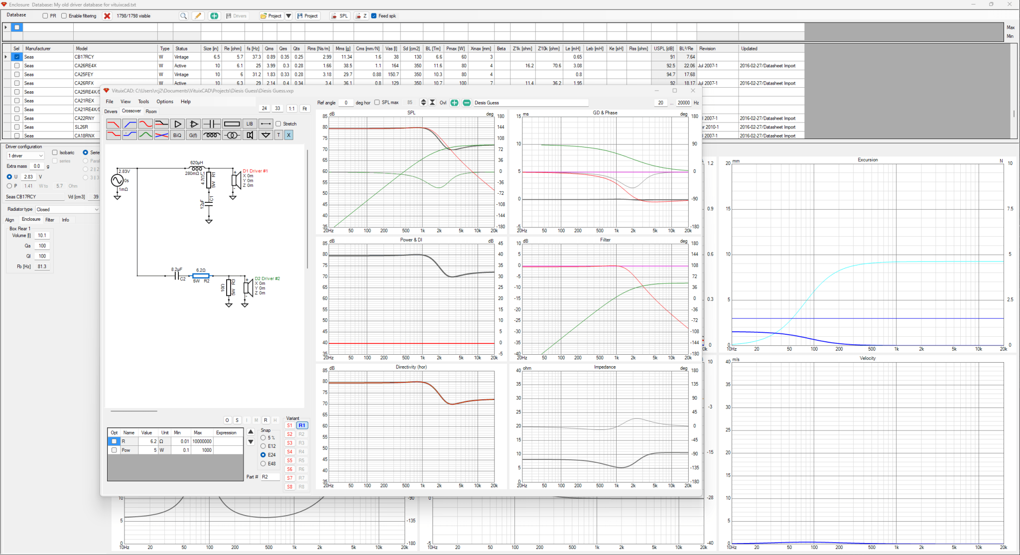

This is a rough approximation to your Xover, I think this is what you have.
Consequently to lower the Xover point for the tweeter go up in the capacitor value one E12 value step at a time.
I would suggest not doing this as its a fairly large value already and we do not know how you new tweeter is going to react. If you cannot get a reasonable sound then consider this as a final option. If you had some way of measuring these things its a lot easier.
To attenuate you can either increase the series resistor to the tweeter, or decrease the resistor in parallel with it. Only try one component change at a time and listen with differing music types so that you get a balanced sound.

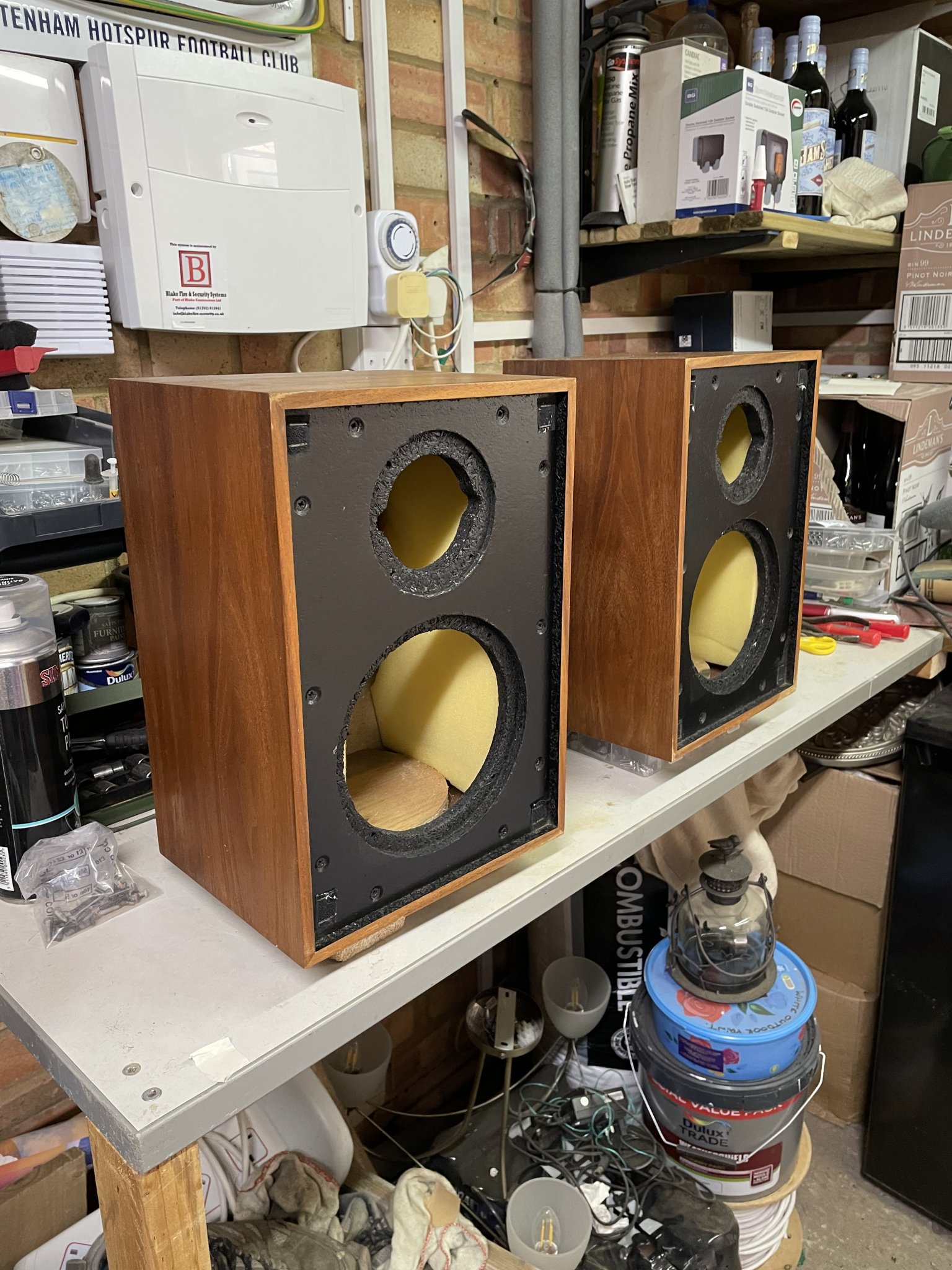

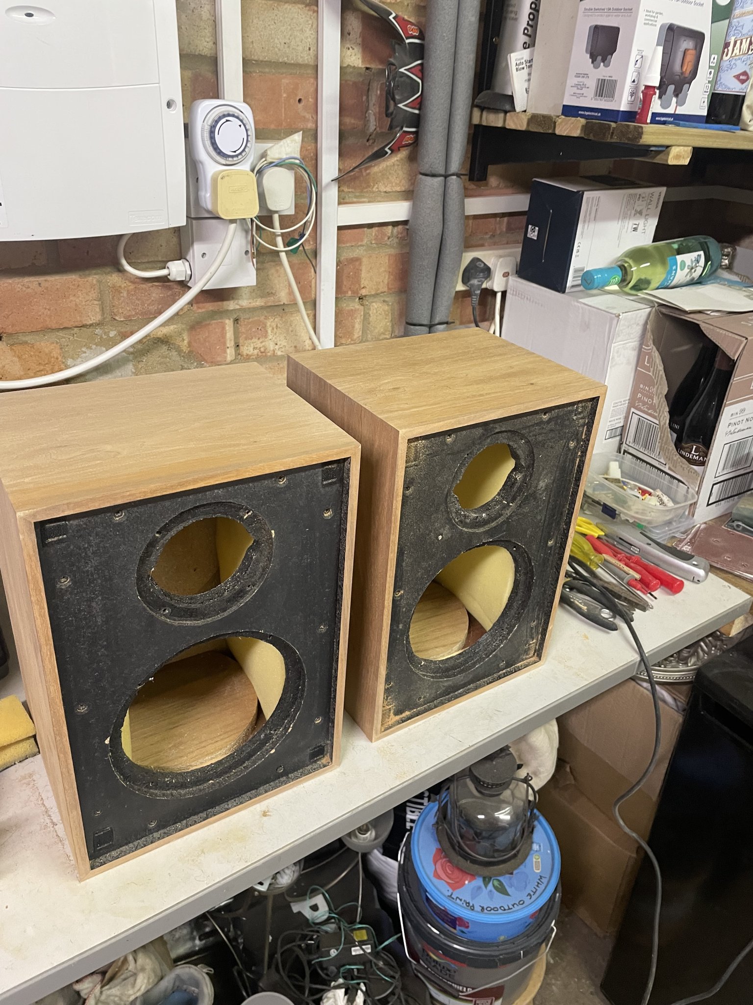

So just cleaning up the cabinets with wire wool and then going to apply the Danish Oil. Spray the front board black.
Clean off the oxidation from the magnesium frame on the woofers.
New Caps and resistors in crossovers next.
Then start assembling them. Will try the remaining old tweeter with one of the new ones to compare. Iāll get the missus to listen too as I have hearing aidsā¦.!
